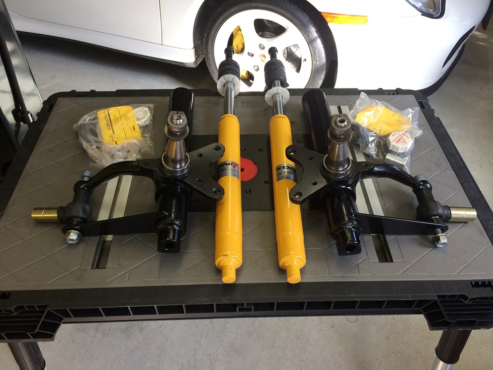

tygaboy   As mentioned, I'm working with Rich Johnson on...   Feb 1 2016, 12:22 PM
tygaboy   On the drive train front, I'm getting to know ...   Feb 1 2016, 12:48 PM
tygaboy   Struts are all done. Almost too pretty to hide und...   Feb 5 2016, 04:13 PM
