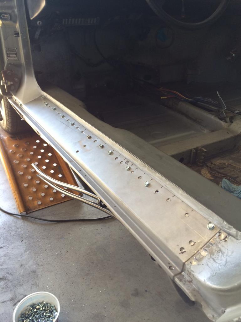

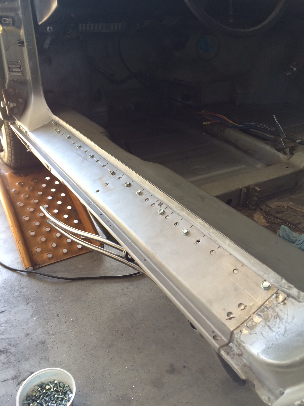

post Feb 6 2016, 04:55 PM
Posts: 5,803
Joined: 6-October 15
From: Petaluma, CA
Member No.: 19,241
Fit the door sills. Learning that I get a better "spot weld" result when I sheet metal screw each hole. Coming along...
