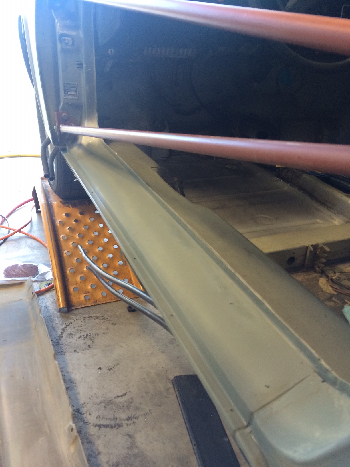

tygaboy   Fit the door sills. Learning that I get a better ...   Feb 6 2016, 04:55 PM
tygaboy   Welded, ground and primer on! On to seam seali...   Feb 6 2016, 04:56 PM
