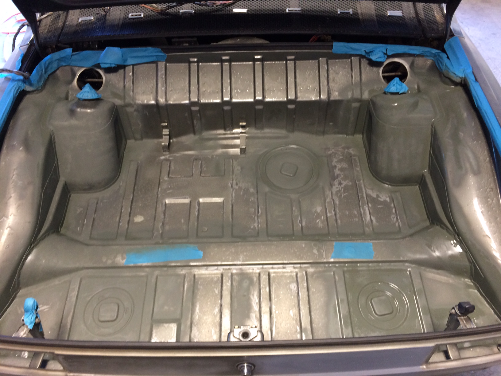

Did I say "on to seam sealer"? Maybe not so fast. After seeing mrfourteen's 74 Sunflower Yellow Build Off car's trunk, I decided that look was for me and it would be "OFF with the seam sealer in the rear trunk.
Again, shoulda taken some before pics. Short story is the factory tech who applied the seam sealer to my car's trunk was particularly enthusiastic in his application! There was A LOT of it and it was uneven, etc. No matter, it's all gone now.
I just hit it with a wire wheel and, other than the "sealer storm" I created (respirator required!), it went pretty quickly.
I may tape all the seams off and apply a tidy layer just at the seams. Still tbd on that.
