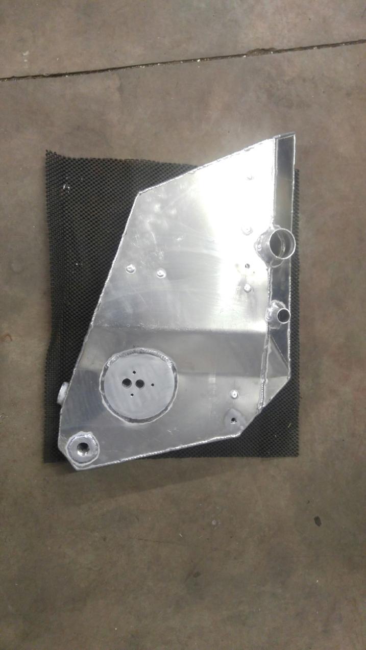

Here is number 1 of the oil tanks with oil filter console.. It has been a long road. This unit is a touch different from the final products as I will do a few more tweaks for the production run but this one needs to be shipped today to a fellow member who has helped a ton behind the swans..

mb911   Here is number 1 of the oil tanks with oil filter ...   Feb 8 2016, 12:47 PM
jd74914   That looks like it fits really nice!   Feb 8 2016, 01:48 PM
johnhora   :agree: Very nice!   Feb 8 2016, 02:03 PM
mb911   Thanks.. I appreciate the support.. Going to revis...   Feb 8 2016, 02:53 PM
