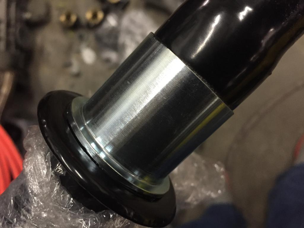

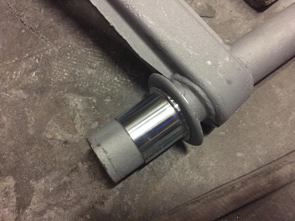

My suggestion is to find a local place in an industrial park that will work with you. Our local place isn't pretty and my order isn't typical (they mostly do patio furniture and aluminum awnings). $275 got all this done and my 914-6 tank. Everything looked like crap on the way in.

BTDT... all the time.
Biggest thing is to go light around the brake line and cable tabs on the suspension bits. those clips are a precision fit. The clips will not fit through the journals on the ends of the lines without taking the powder coating off now.
What bushings do you plan to use Mark?

Ok... Just joking then. You need to install the races first, then powder coat. (IMG:style_emoticons/default/biggrin.gif)
Now you have to scrape the powder off to get the races on unless you're talking elephant rubber.

Then I'm a lucky man (IMG:style_emoticons/default/biggrin.gif)
