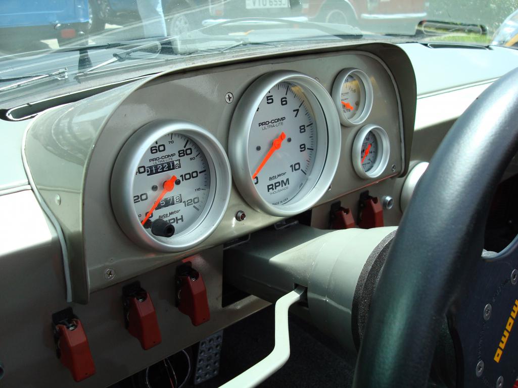

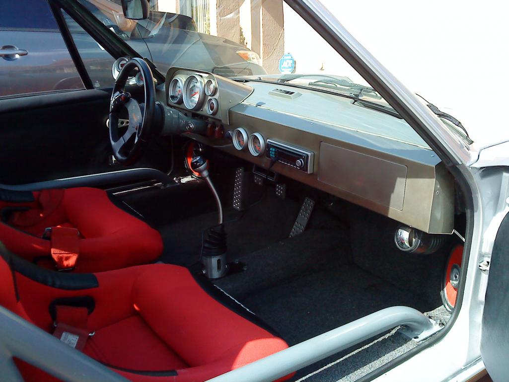

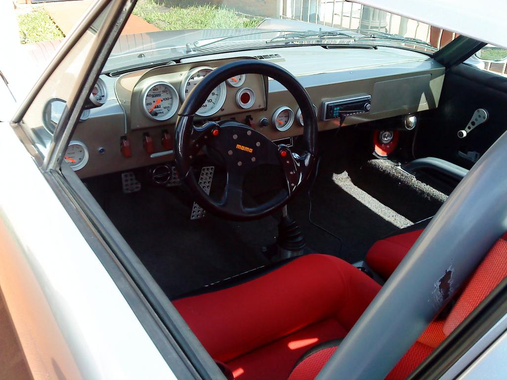

You could cover the frame and make it look like this (IMG:style_emoticons/default/smile.gif) , the double curve hump took me two attempts , the second I made a cardboard template wrapped it around trimmed it
then layed it flat , cut the sheet metal & then had a sheet metal ducting place roll it , the same for the face , I took the dash frame to them and had them brake bend the face cover then I attached it with removable screws so I could scribe the radio hole,the glovebox hole & steering column slot , removed it & opened the holes, Bill D.
