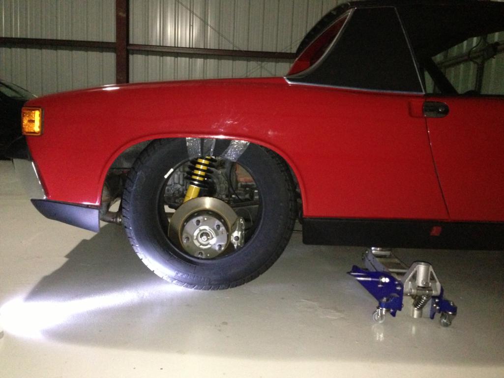

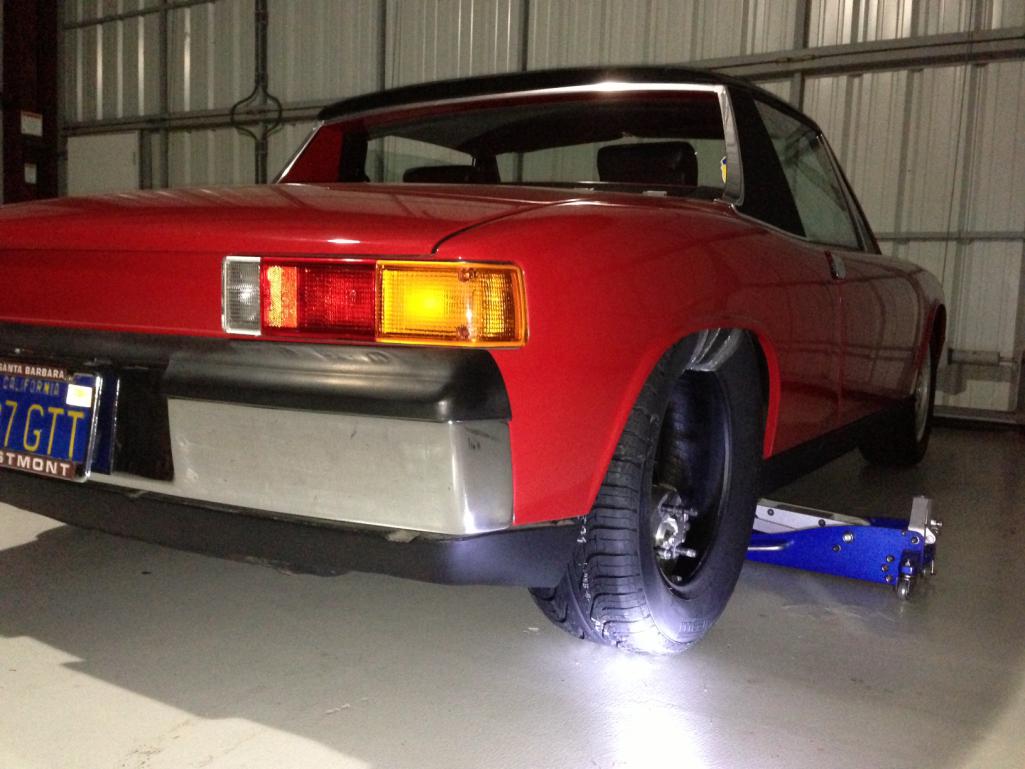

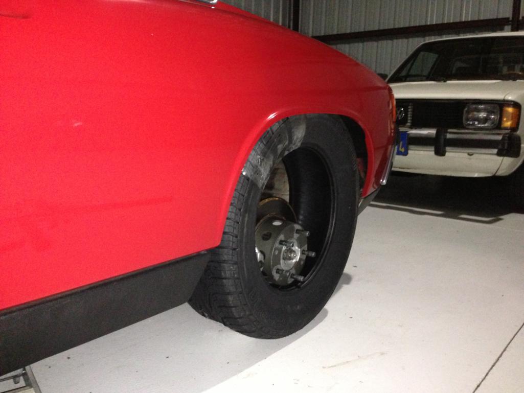

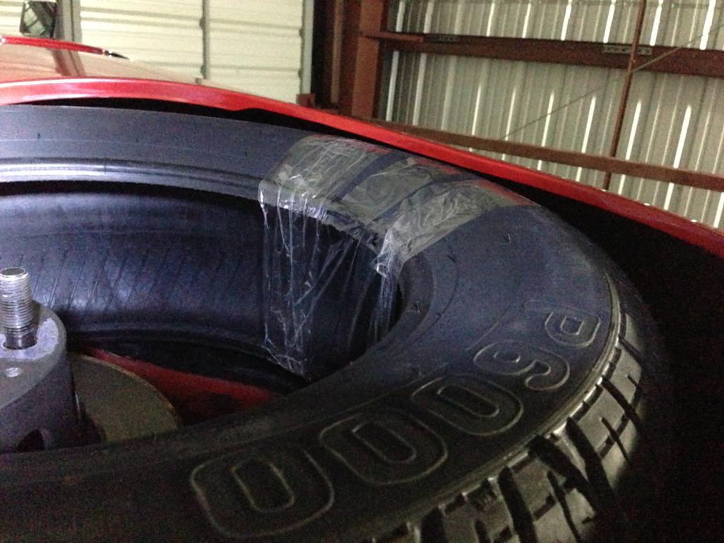

Okay, so I found the pics I took during the 215/60R15 experiments. I'll post them here for two reasons:
-Maybe they'll be helpful to someone else
-The hardest thing to find on the inter webs were (any) pictures of the tires I was interested in ON a 914, or even an early 911.
So, pardon the amount of pics, but here goes the first trial with the 215/60R15 P6000:

horizontally-opposed   Okay, so I found the pics I took during the 215/60...   Feb 11 2016, 08:18 PM
horizontally-opposed   Okay, so there was hope, or at least a little. The...   Feb 11 2016, 08:25 PM
horizontally-opposed   Sorry for a couple of sideways pics up above. Darn...   Feb 11 2016, 08:29 PM
