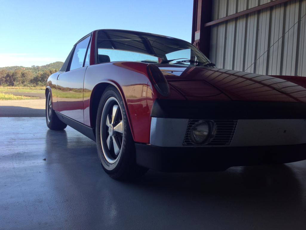

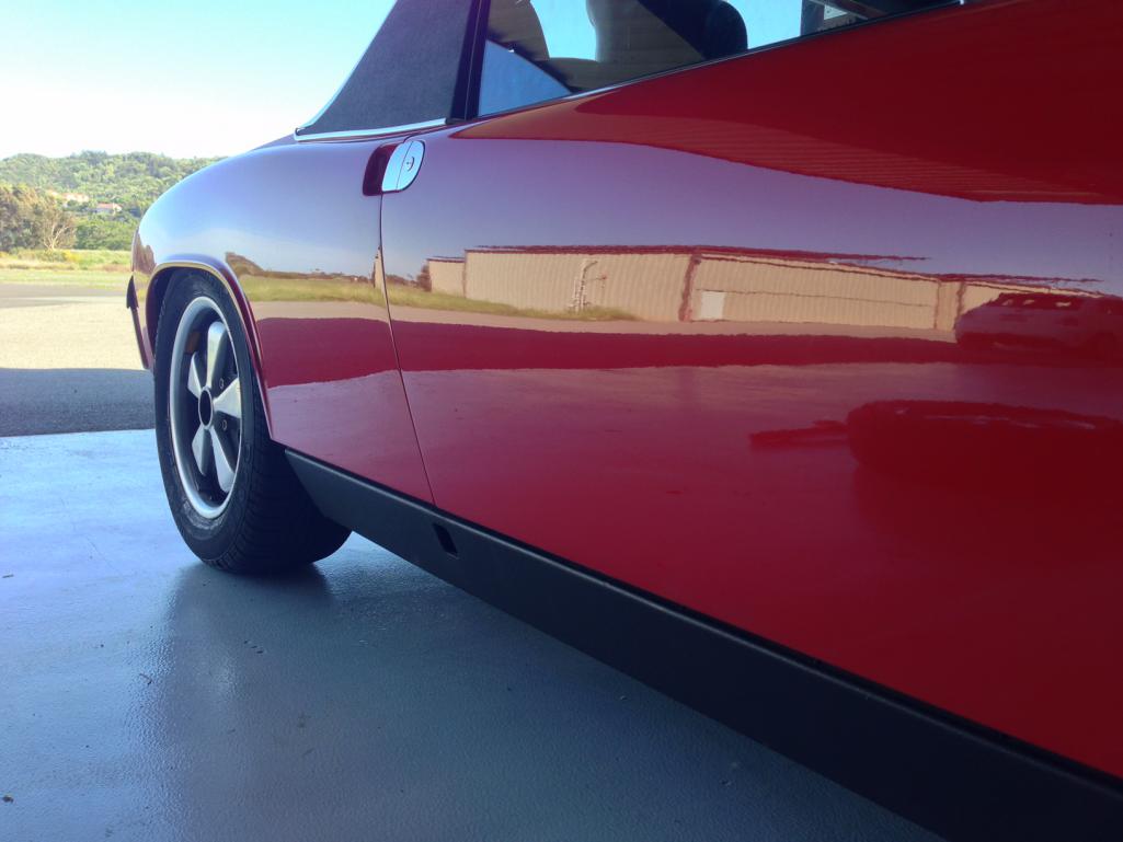

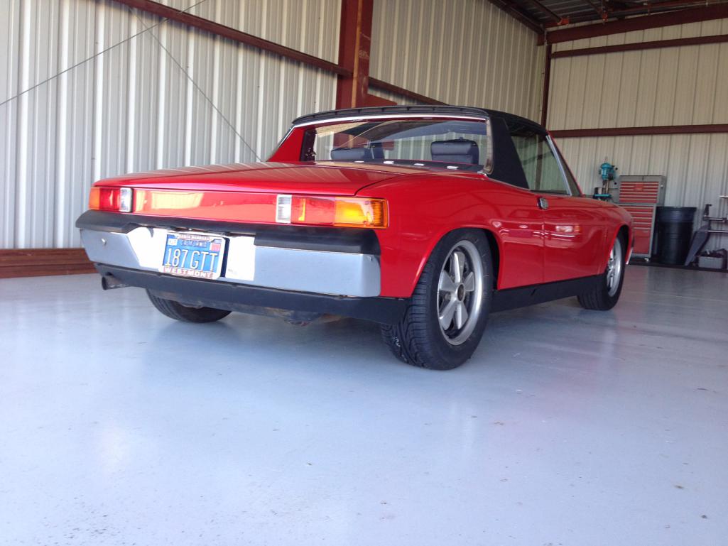

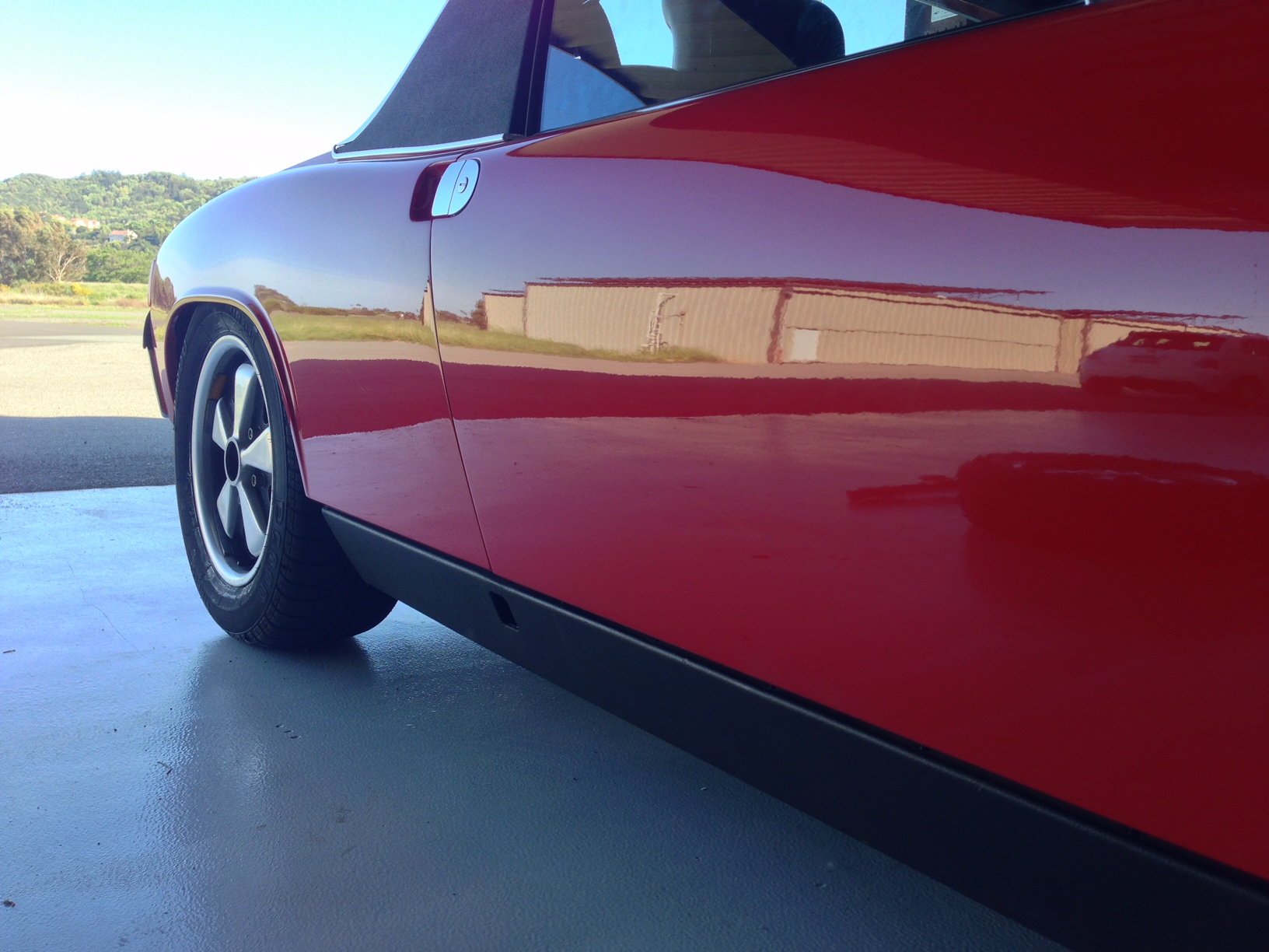

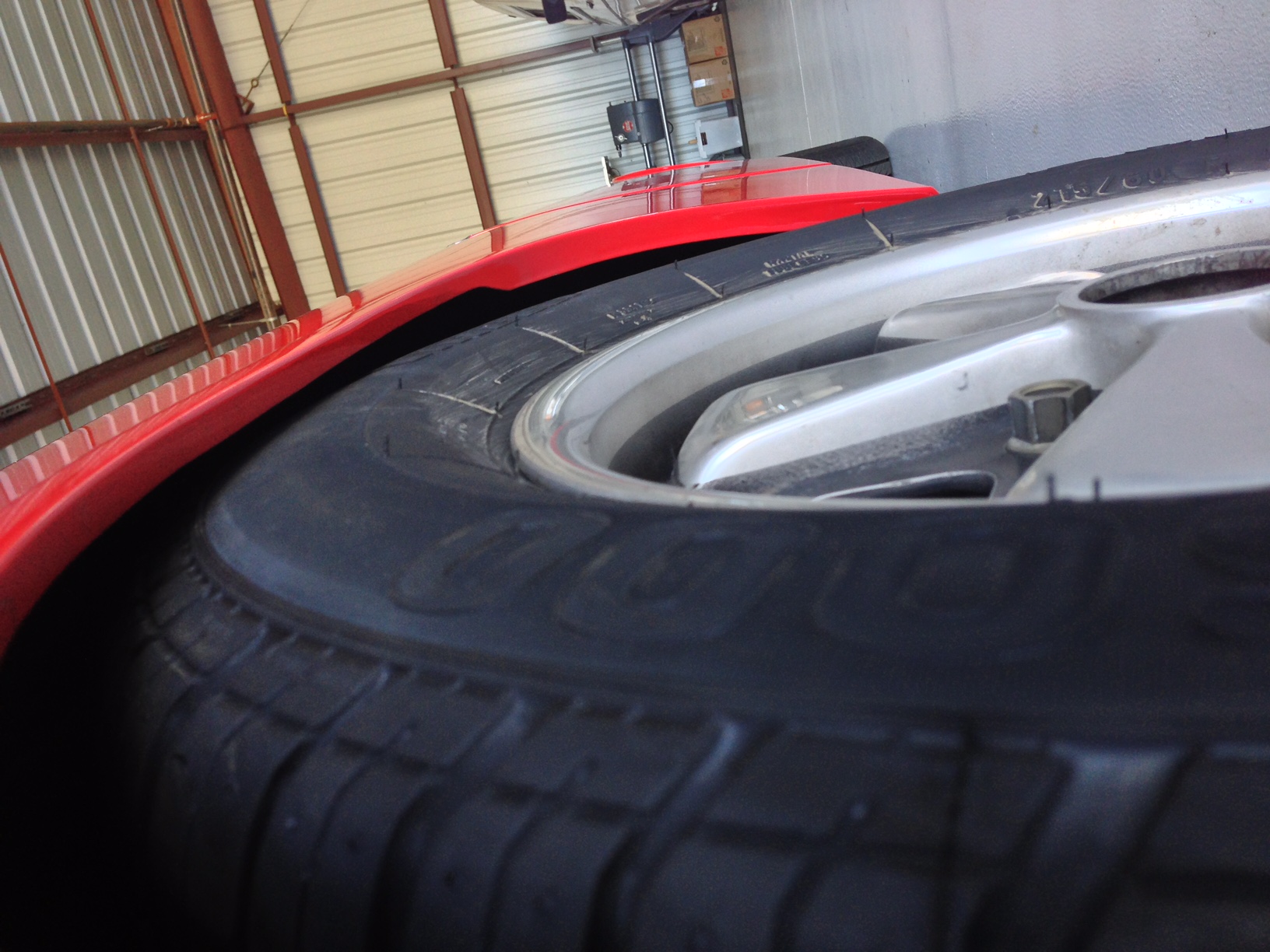

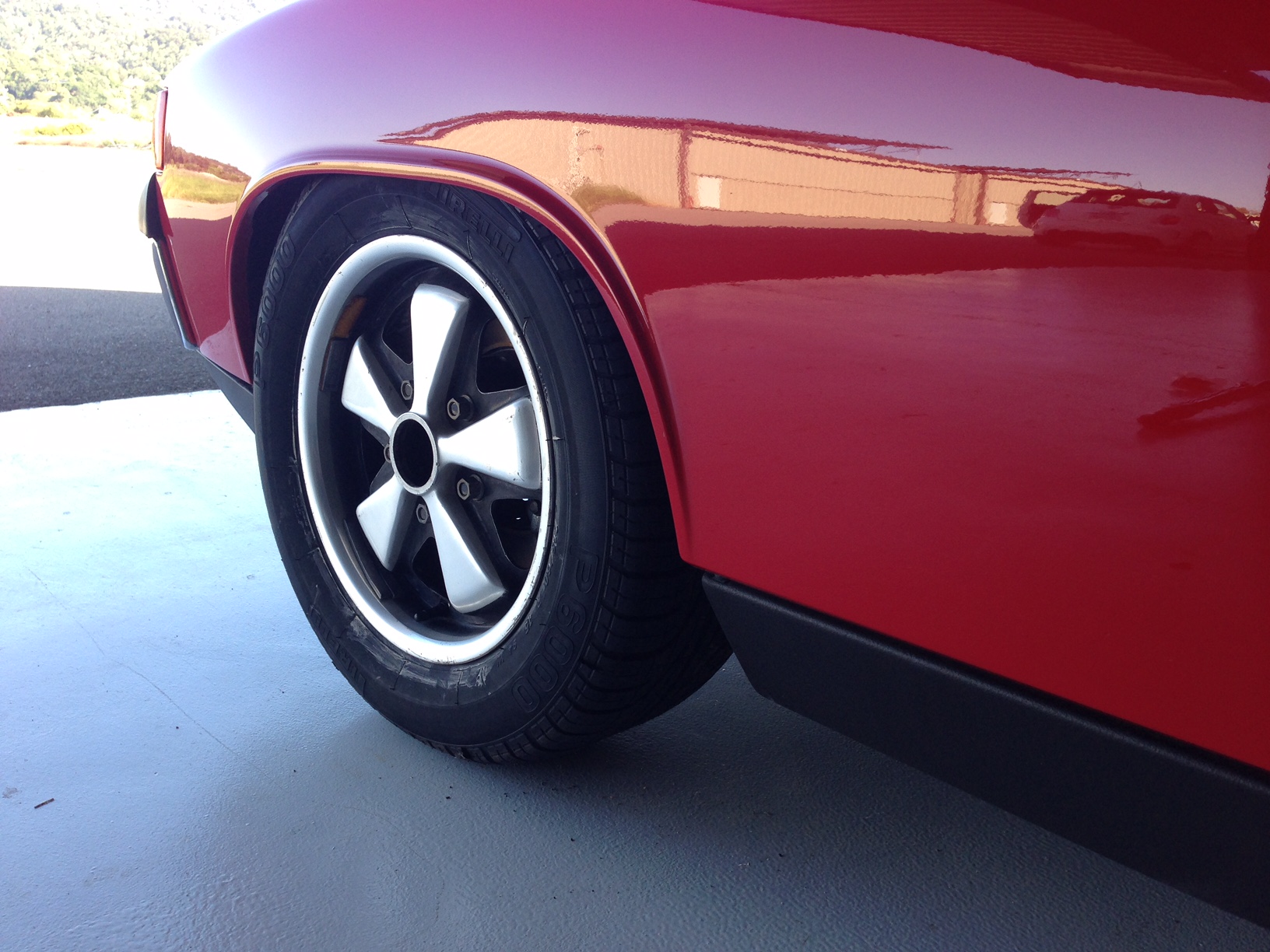

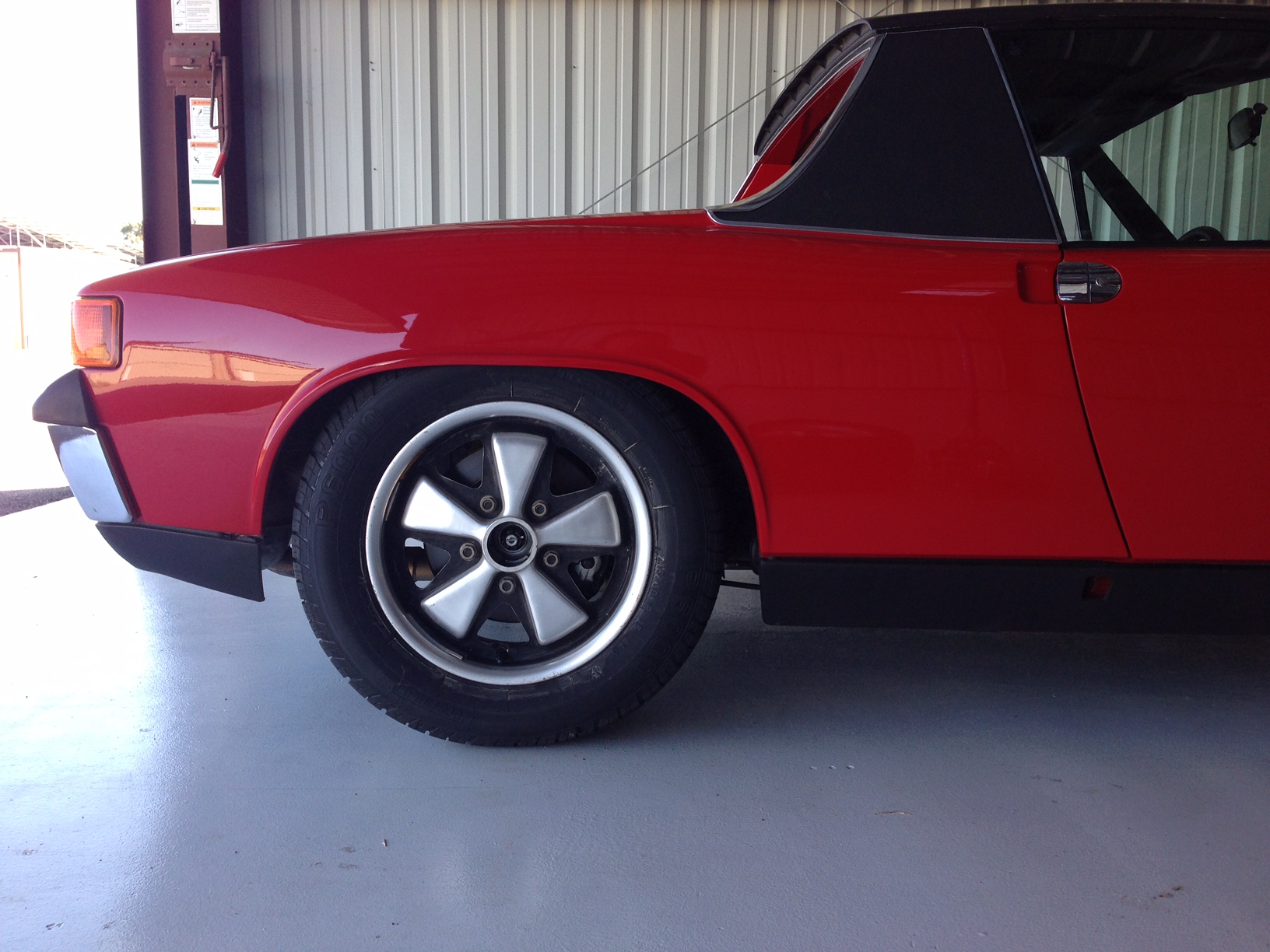

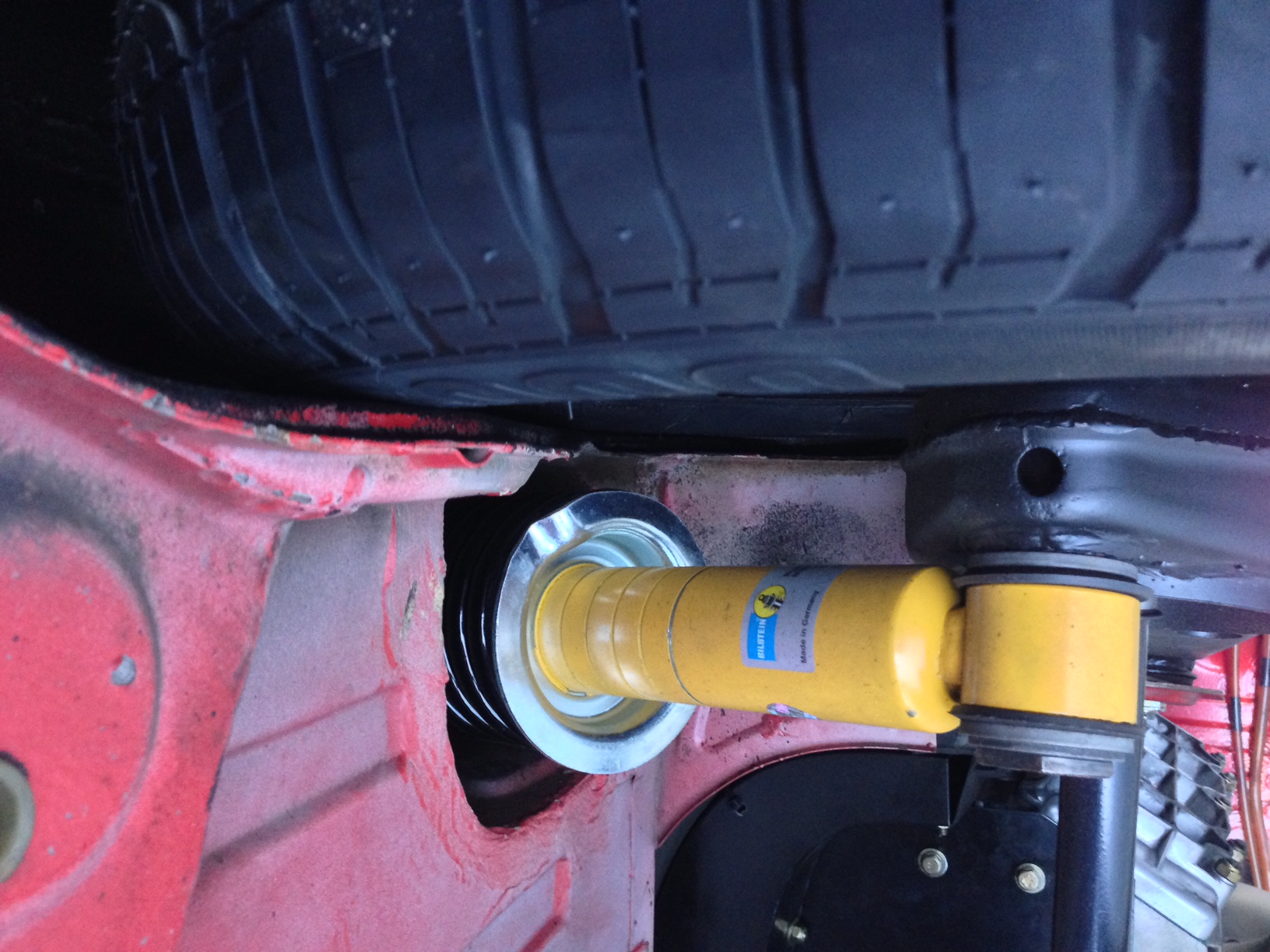

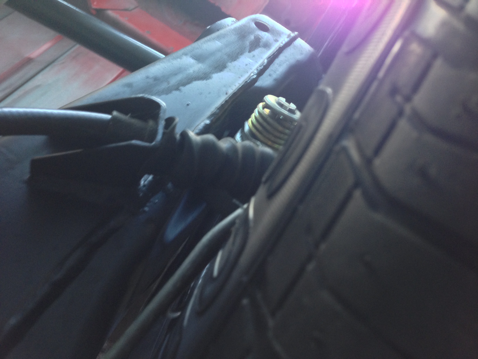

Okay, so there was hope, or at least a little. The tire would physically fit inside the well, but there wasn't much room.
Next step was to try to locate it perfectly in there on a wheel—and I knew a 15x6 was both too narrow for a 215mm tire and unlikely to place it where it needed to be. So I borrowed a 911R wheel from a friend, which adds an inch to the inside and allows you to space the wheel as you need to. If you want to fit maximum tire under the back of a narrow 914, these are the best factory wheels for that purpose. I used washers instead of spacers to keep things easy—knowing I could have custom spacers made later if things looked good.
So, here goes...

horizontally-opposed   Okay, so I found the pics I took during the 215/60...   Feb 11 2016, 08:18 PM
horizontally-opposed   Okay, so there was hope, or at least a little. The...   Feb 11 2016, 08:25 PM
horizontally-opposed   Sorry for a couple of sideways pics up above. Darn...   Feb 11 2016, 08:29 PM
