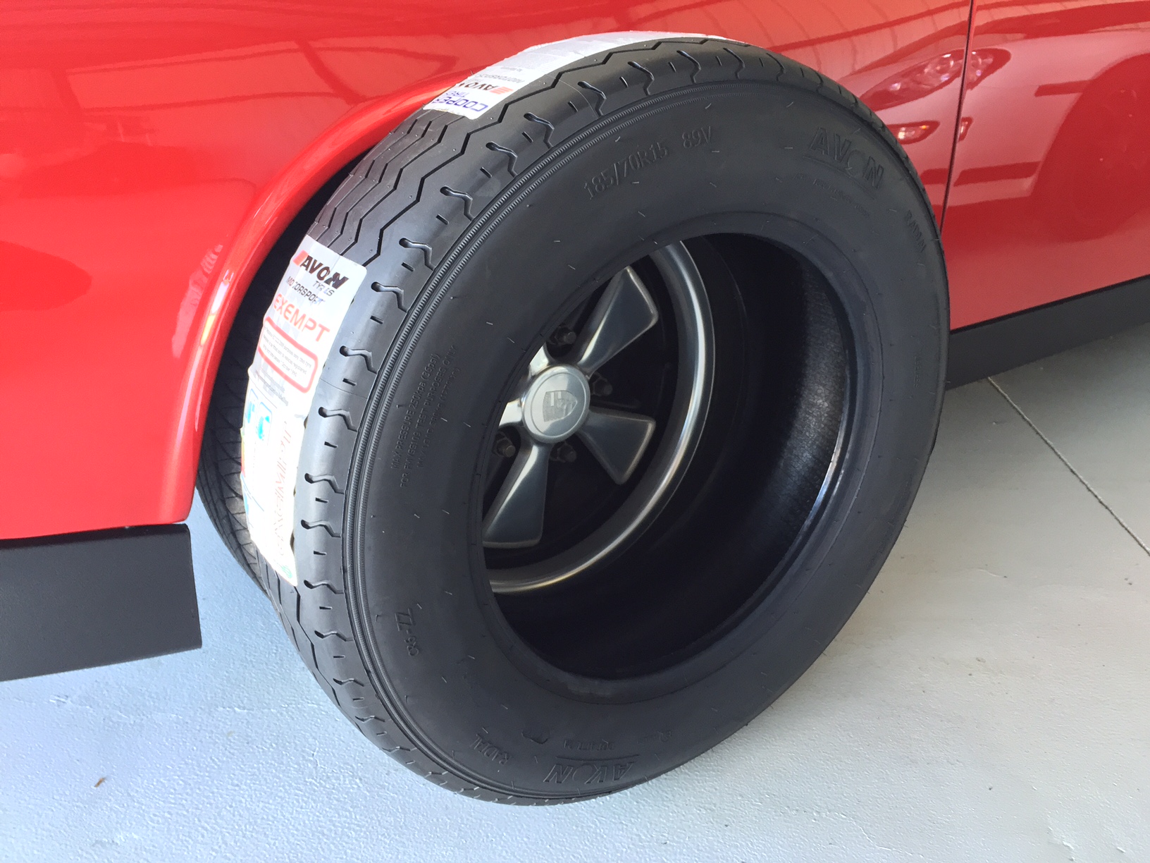

horizontally-opposed   Okay, so I found the pics I took during the 215/60...   Feb 11 2016, 08:18 PM
horizontally-opposed   Okay, so there was hope, or at least a little. The...   Feb 11 2016, 08:25 PM
horizontally-opposed   Sorry for a couple of sideways pics up above. Darn...   Feb 11 2016, 08:29 PM
horizontally-opposed   The Pirelli P6000 disappointment led to a new aven...   Feb 11 2016, 08:31 PM
