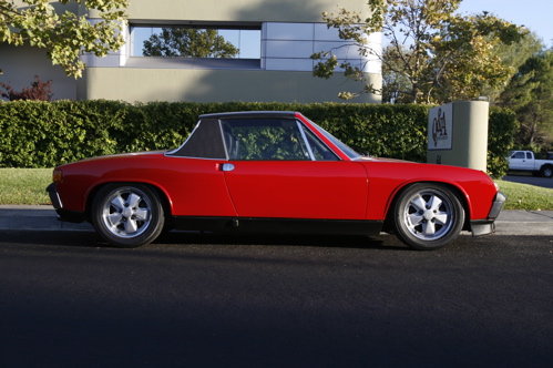

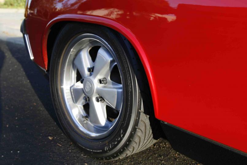

Porsche lists the 215/60R15 as an N1 tire approved for 914-6, and I am considering them as they solve the too-small diameter problem I want to avoid. Currently, I'm on 195/65s. I used to run 205/55s and 205/60s, but all of these are too small in diameter.
I know the cars vary, but I was able to run various 205/55s with no rubbing and 205/60 Yoko A008Rs years ago with only a bit of rubbing on the inside (too much negative camber at that time). I'd be running these on 15x6 911 wheels, but may pop to have them turned into 15x7Rs by Weidman and do custom spacers. Big thing is to get a summer performance tire in there with, well, performance—and the right look.
That period look with any kind of performance is getting tough to find. If anyone has 215/60s on a narrow car, and can provide pics, I'd be very thankful!

Where I started back in 2006~: A set of old, hard Yokohama AVS ES100s in 205/55R15 that needed to be replaced. This was a tire size I fell in love with on the 914 when I could get BFG Comp T/A3s in it. I disliked the ES100s, both on this 914 and on a Subaru WRX. I know a lot of people like them, but I found the sidewalls unyielding and the squared shoulders foreboding as I approached the limit of adhesion.
Didn't miss them when I got rid of them from a performance/feedback standpoint, and wanted a taller, period-correct tire. Still one of my favorite tire sizes on a narrow 914, however.
