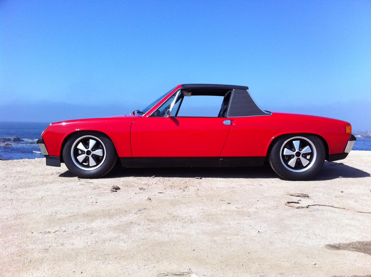

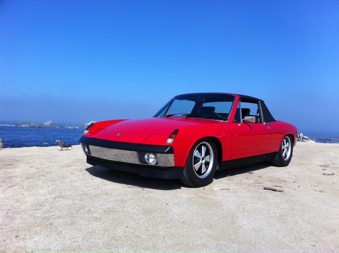

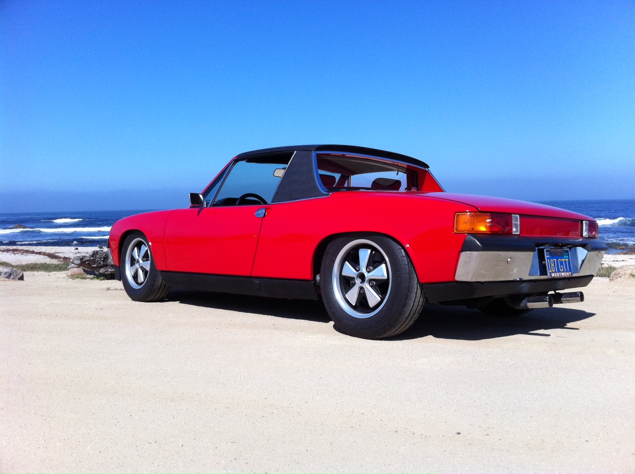

So I wrote a column for some lousy magazine about how hard it is to find 15-inch tires and got a note from an insider making fun of me. Turns out, he bought a truckload of the last Yokohama A-008Rs—and had already shipped a set to me. Wow.
So of course I put them on. That was about 2006 or 2007. Then the car went away for paint. The photos below are the day after Rennsport Reunion IV, so late 2011. The old-school A-008Rs looked fabulous, but were two all left-hand tires and, well, old and hard. They were older by the time the car came out of paint. I drove on them for a while, and the saving grace probably was that they were R compound to begin with—but I never felt comfortable pushing on them. And then they just kept getting older. But the car had to go back in for paint, and was about to come off the road for a new engine, so I left them on for a while as rollers.
