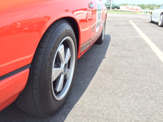

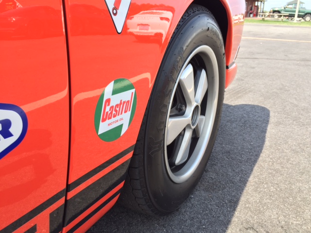

1) Hoosier TD 5.00-15 or 205/60R15 Speedster tires, but research suggested they are awful on the street until they're hot (not easy to do on the street, most of the time). Also, I hear the folks at Hoosier won't talk to you if you mention street use. That told me everything I needed to know. The Avons are well proven on the street, and are a tarmac rally tire in addition to a vintage racing tire. You won't get a lot of life out of them, but I figure I'll be replacing them on a time rather than mileage basis. Unless, of course, I just can't keep my rear end out of the seat with those Avons... (IMG:style_emoticons/default/smile.gif)

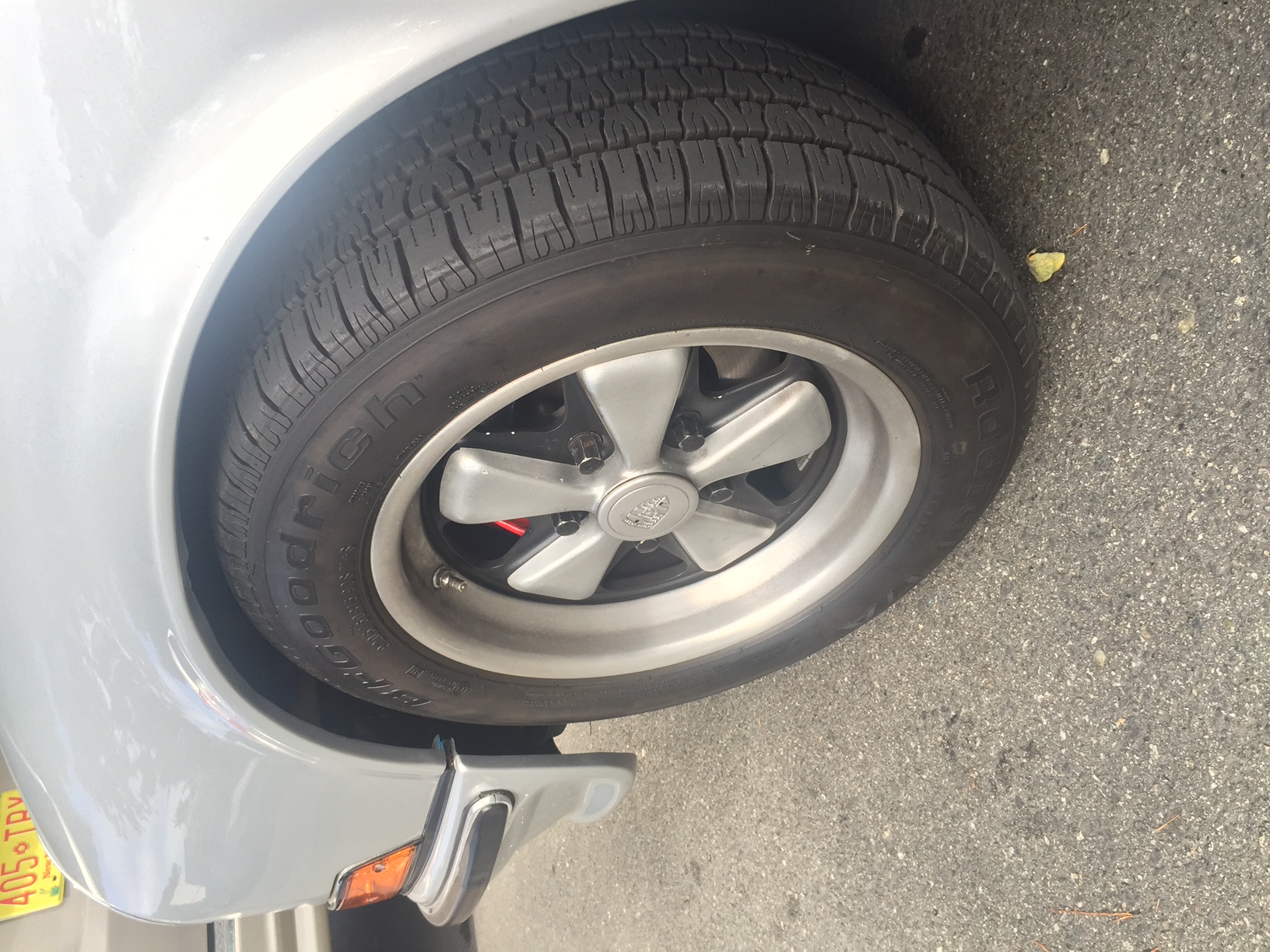

2. BF Goodrich Radial T/A in 205/60R15: Talk about old-skool. Had been wondering if they were too Trans-Am/Burt Reynolds for a 914, and wondering if they had been updated, but just couldn't get my head around them. Still curious. Will say that the vintage sidewall, vintage tread pattern, and price make them appealing. Maybe even very appealing.
First Hoosier pic is a 5.00-15 tire on a 15x6 wheel, second one is a 5.50-15 on a 15x7R.
