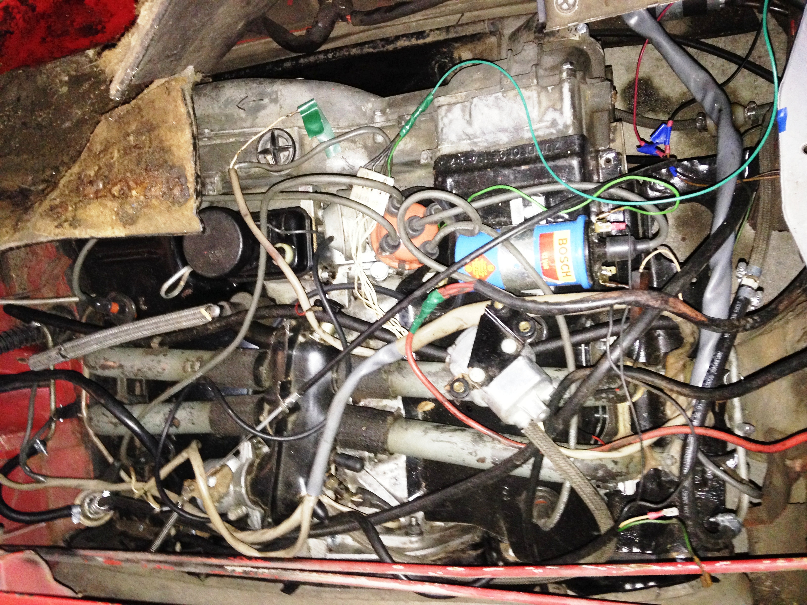

Picture as requested.
I know its sort of a mess....No one ever said it would be easy! Attached Image

poorsche914   Post some pictures of the engine/engine bay so we ...   Feb 14 2016, 01:02 PM
gunn1   Picture as requested. I know its sort of a mess......   Feb 14 2016, 02:22 PM
poorsche914   If engine is original to the '74 body, spark p...   Feb 14 2016, 02:38 PM
