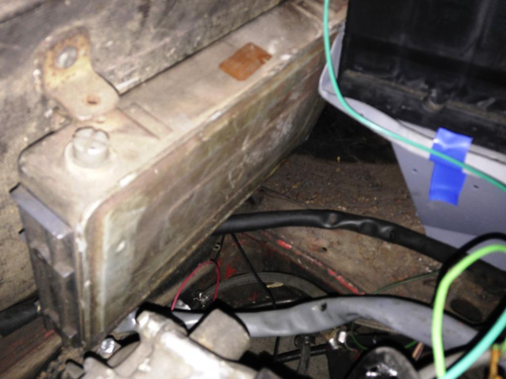

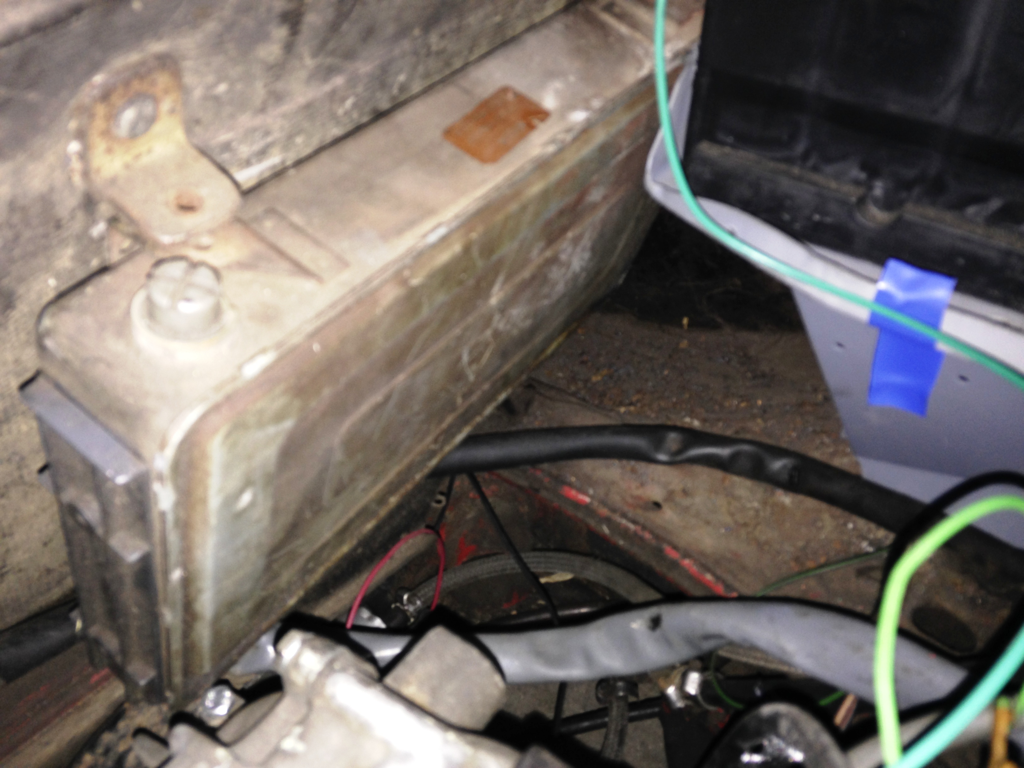

Attached Image Picture of ECU.
r-towle, I will read the article and get the numbers of the ECU, MPS, TPS and CHT. Thanks
