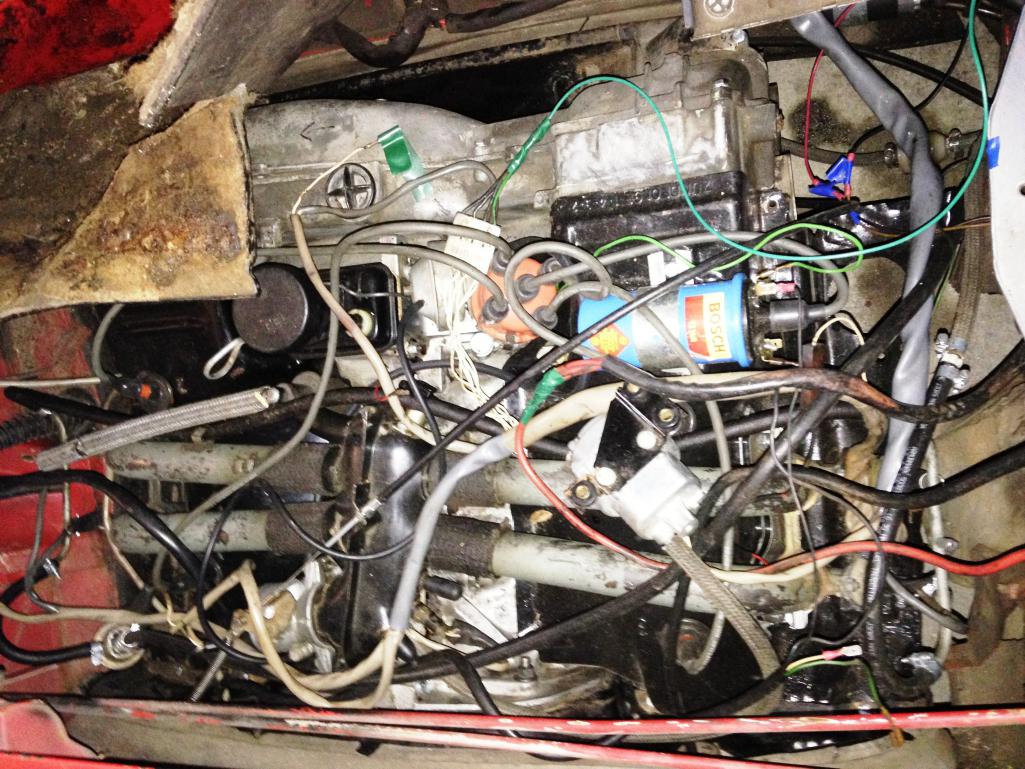

Picture as requested.
I know its sort of a mess....No one ever said it would be easy! Attached Image

QUOTE(gunn1 @ Feb 14 2016, 12:22 PM) *
Welcome to 914world!
Your engine is not really that messed except that firewall pad. You can just delete/remove that pad so you be able to see if there is some rush on the lower firewall area that needs repair.
