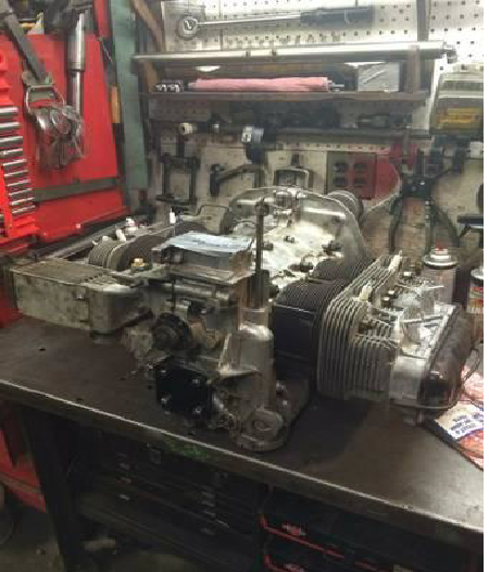

Attached Image this photo was taken by the previous owner.
Its the only one I have of the engine after the rebuild, before it was reinstalled in the car.
