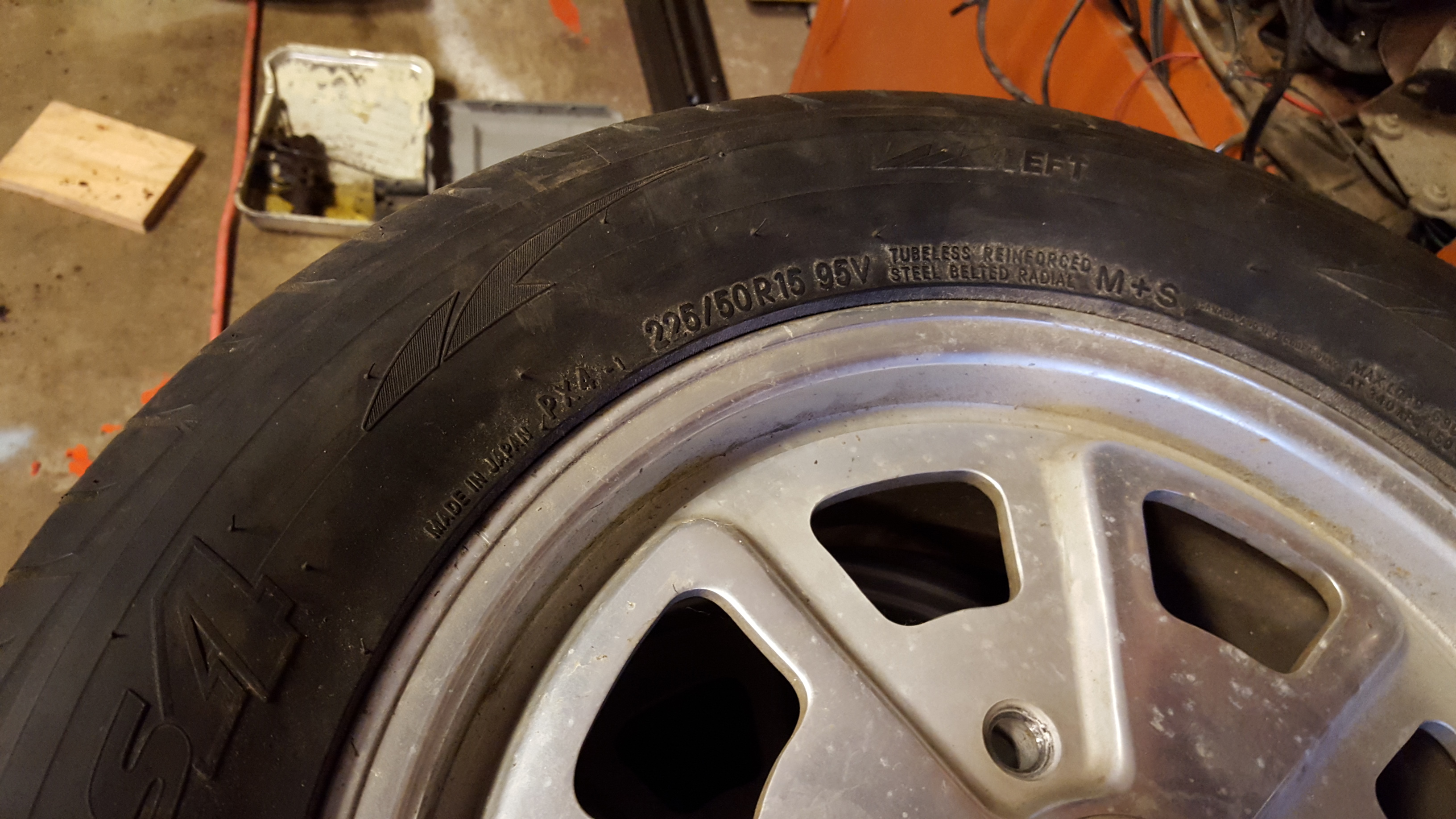

The car I just picked up has 225 /50 R15's on Fuchs
