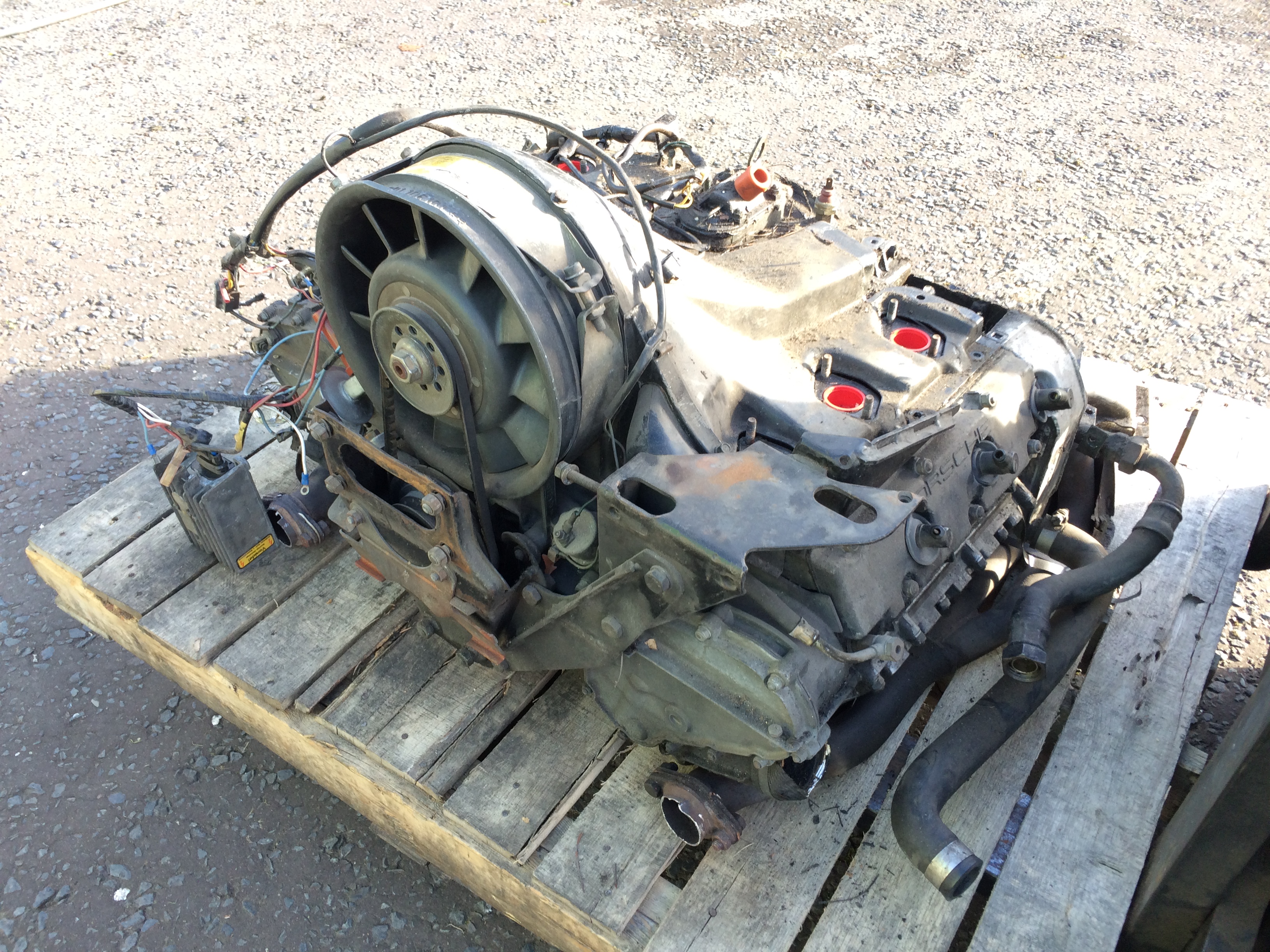

Picked this up from the shippers warehouse this morning, all the way from Phoenix Arizona !
2.7 with the webers i picked up earlier (IMG:style_emoticons/default/piratenanner.gif)
