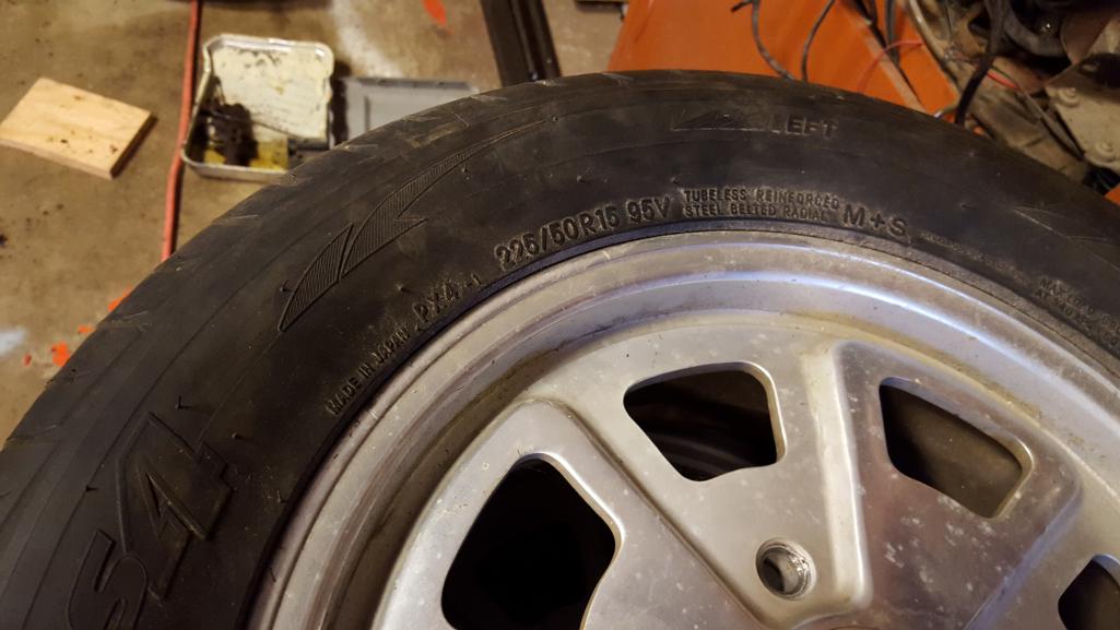

The car I just picked up has 225 /50 R15's on Fuchs
Wow, interesting.
That's a lot of tire on a 15x5.5-inch wheel. Have the wheels been widened on the inside? Weidman's Wheels does that quite a bit for the 911 crowd, turning 15x6s into 15x7s, and I've seen at least one set of 914 alloys custom widened.
