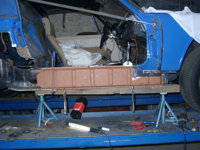

Here we go. Some progress pics.
Fitted the outer rockerand primed the inner.
Some new parts arrived today. Think i am now complete with the parts. (IMG:style_emoticons/default/smilie_pokal.gif)

michelko   Here we go. Some progress pics. Fitted the outer r...   Sep 30 2004, 01:18 PM

michelko   i also received last week engman´s stiffenig kit....   Sep 30 2004, 01:56 PM
J P Stein   Just a little note on "weld thru primer". The out...   Sep 30 2004, 02:04 PM
