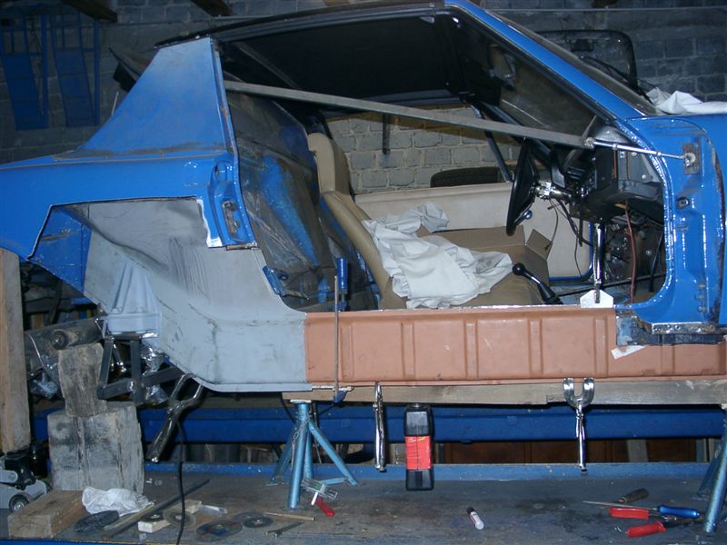

Hi guys,
look what i found under the fender. The PO did some very fine work to repair the hell hole (IMG:style_emoticons/default/ar15.gif)

michelko   here you can see the new metal. Think next weekend...   Sep 5 2004, 03:20 AM
michelko   Some advice to keep the door gap stable? I made a ...   Sep 5 2004, 03:23 AM

michelko   hi everybody, did some work on the rustbucket. Cut...   Sep 16 2004, 02:54 PM
michelko   Hold the new sheetmetal in place. looks very nice ...   Sep 16 2004, 02:56 PM
michelko   should add the pic ;)   Sep 16 2004, 02:56 PM
michelko   nother one   Sep 16 2004, 02:59 PM
michelko   inside of the console and the safetybelt mounting ...   Sep 16 2004, 03:02 PM
michelko   outside saturday will be weldingtime again :welde...   Sep 16 2004, 03:04 PM

michelko   during study i worked one day per week in an metal...   Sep 18 2004, 11:24 AM

BatAc   Michelko, I assume you're going to "sandwhich"...   Sep 19 2004, 12:13 AM
SpecialK   I don't know about michelko, but I'd "weld...   Sep 19 2004, 01:38 AM
trojanhorsepower   I am not worthy :worship: How did you bend the m...   Sep 19 2004, 07:28 AM
michelko   I use rustconverter (fertan) on all old stuff and ...   Sep 20 2004, 04:09 AM
BatAc   On the inner wheelhouse when you take off the whee...   Sep 21 2004, 03:41 PM

J P Stein   Just a little note on "weld thru primer". The out...   Sep 30 2004, 02:04 PM
