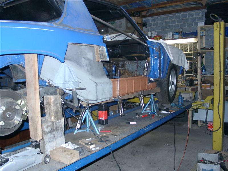

michelko   And the story goes on. removed the batterytray tod...   Sep 18 2004, 09:50 AM
michelko   the firewall was also infected. The first replacem...   Sep 18 2004, 09:52 AM
michelko   wr   Sep 18 2004, 09:53 AM
michelko   thats for today. did i tell you that i hate rust? ...   Sep 18 2004, 09:56 AM

michelko   during study i worked one day per week in an metal...   Sep 18 2004, 11:24 AM

michelko   I use rustconverter (fertan) on all old stuff and ...   Sep 20 2004, 04:09 AM

michelko   Here we go. Some progress pics. Fitted the outer r...   Sep 30 2004, 01:18 PM
michelko   blabal   Sep 30 2004, 01:19 PM
michelko   :wub:   Sep 30 2004, 01:20 PM
michelko   primed area 51   Sep 30 2004, 01:22 PM
michelko   front   Sep 30 2004, 01:23 PM
michelko   nother   Sep 30 2004, 01:24 PM
michelko   and the new parts   Sep 30 2004, 01:25 PM
michelko   can you count the number of paint jobs? :wacko:   Sep 30 2004, 01:26 PM
michelko   and some more new parts and a bottle of fuel :wooh...   Sep 30 2004, 01:53 PM
michelko   i also received last week engman´s stiffenig kit....   Sep 30 2004, 01:56 PM
