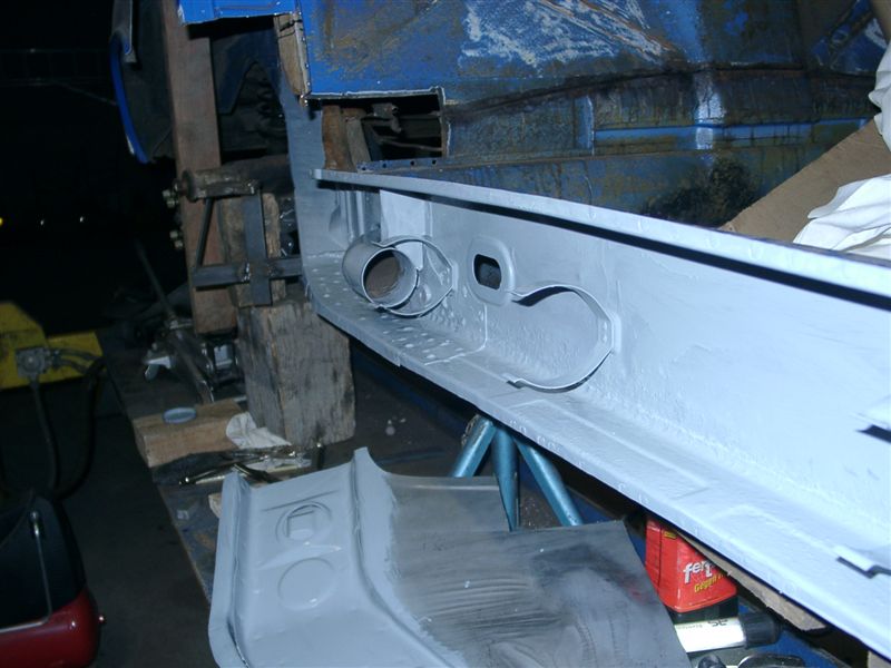

michelko   Here we go. Some progress pics. Fitted the outer r...   Sep 30 2004, 01:18 PM
michelko   blabal   Sep 30 2004, 01:19 PM
michelko   :wub:   Sep 30 2004, 01:20 PM
michelko   primed area 51   Sep 30 2004, 01:22 PM
michelko   front   Sep 30 2004, 01:23 PM
michelko   nother   Sep 30 2004, 01:24 PM
michelko   and the new parts   Sep 30 2004, 01:25 PM
michelko   can you count the number of paint jobs? :wacko:   Sep 30 2004, 01:26 PM
michelko   and some more new parts and a bottle of fuel :wooh...   Sep 30 2004, 01:53 PM
michelko   i also received last week engman´s stiffenig kit....   Sep 30 2004, 01:56 PM
