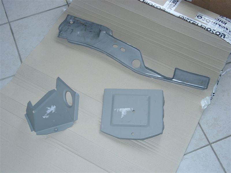

and the new parts

michelko   and the new parts   Sep 30 2004, 01:25 PM
