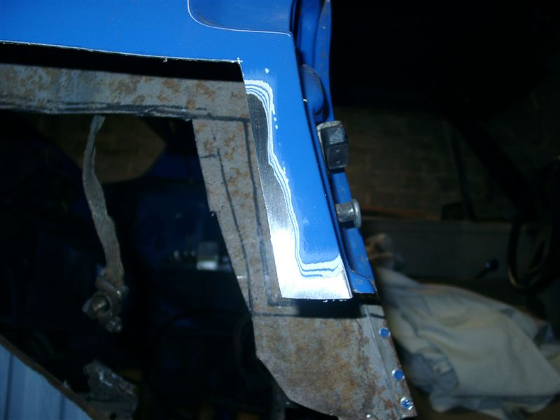

Hi guys,
look what i found under the fender. The PO did some very fine work to repair the hell hole (IMG:style_emoticons/default/ar15.gif)

michelko   The sheet metal was riveted to the longitudinal :w...   Sep 5 2004, 03:16 AM

michelko   here you can see the new metal. Think next weekend...   Sep 5 2004, 03:20 AM
michelko   Some advice to keep the door gap stable? I made a ...   Sep 5 2004, 03:23 AM

Jeroen   Hey Michael, good job! The only thing worse t...   Sep 5 2004, 07:26 AM
michelko   Hi Jeroen, got that nice piece of metal on US Ebay...   Sep 5 2004, 09:18 AM

michelko   hi everybody, did some work on the rustbucket. Cut...   Sep 16 2004, 02:54 PM
michelko   Hold the new sheetmetal in place. looks very nice ...   Sep 16 2004, 02:56 PM

michelko   during study i worked one day per week in an metal...   Sep 18 2004, 11:24 AM

trojanhorsepower   I am not worthy :worship: How did you bend the m...   Sep 19 2004, 07:28 AM
michelko   I use rustconverter (fertan) on all old stuff and ...   Sep 20 2004, 04:09 AM
