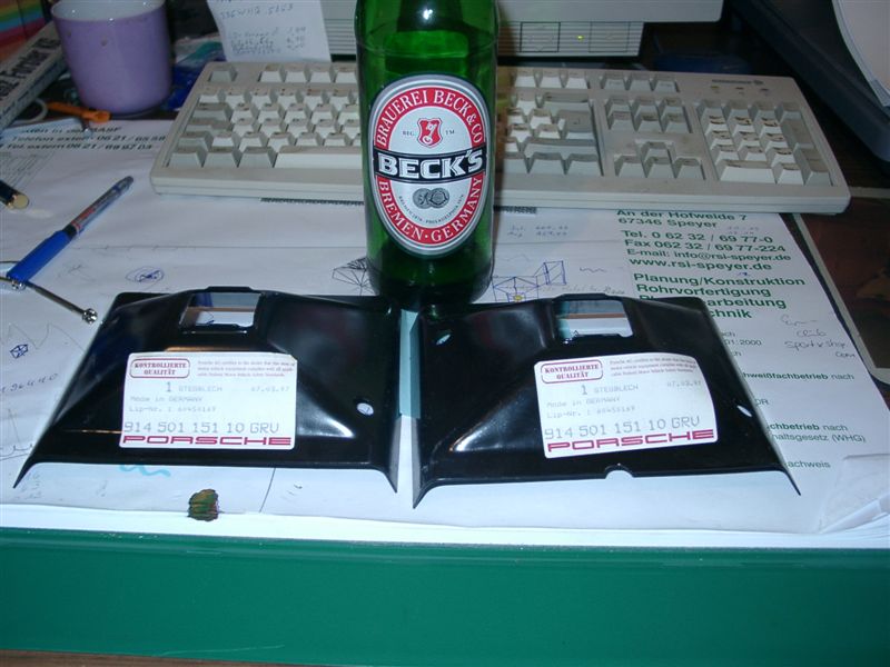

and some more new parts and a bottle of fuel (IMG:style_emoticons/default/w00t.gif)
