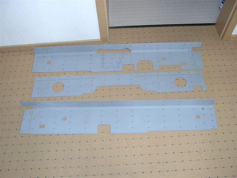

i also received last week engman´s stiffenig kit.
This is realy a awsome piece of art. very good fittment and the transaction was very quick and smooth

michelko   and some more new parts and a bottle of fuel :wooh...   Sep 30 2004, 01:53 PM
michelko   i also received last week engman´s stiffenig kit....   Sep 30 2004, 01:56 PM
