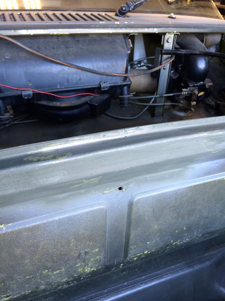

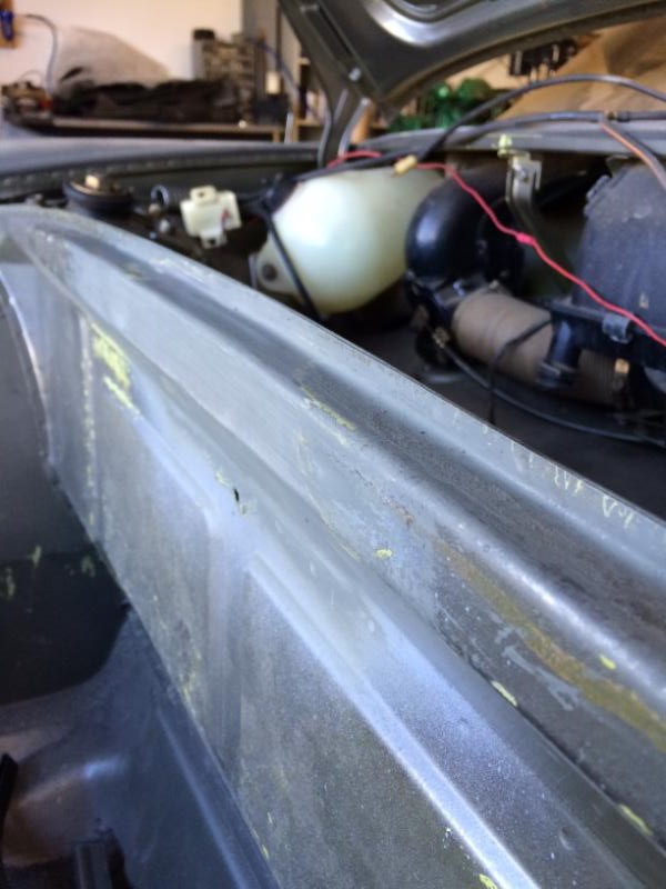

tygaboy   Another repair of PO hole drilling. There were som...   Feb 23 2016, 04:45 PM
tygaboy   So, it's time to fab up a patch. Here's a ...   Feb 23 2016, 04:48 PM
tygaboy   Time to trim / fit the patch.   Feb 23 2016, 04:51 PM
tygaboy   :sawzall: then :welder: then (insert grinder emo...   Feb 23 2016, 04:55 PM
