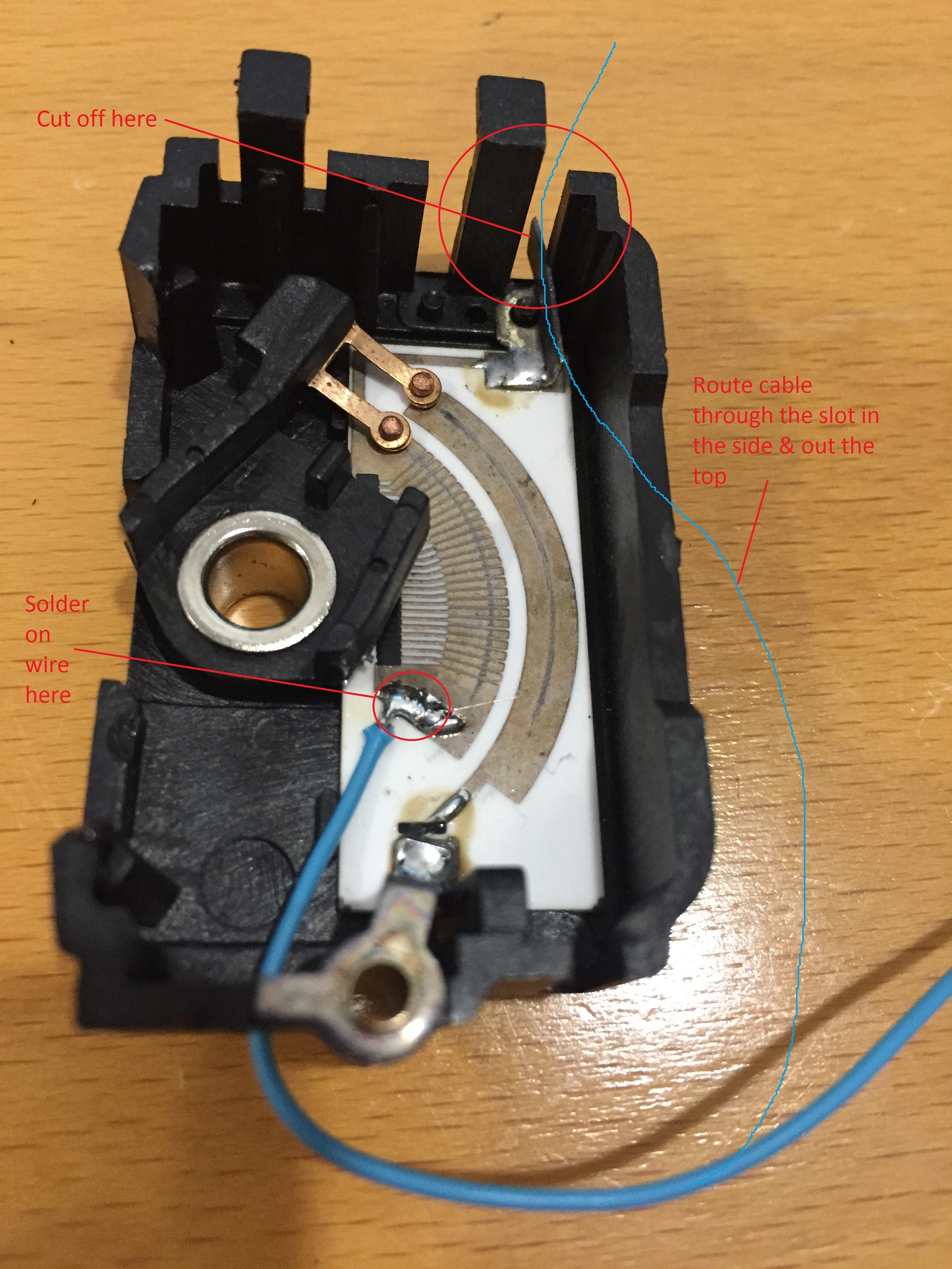

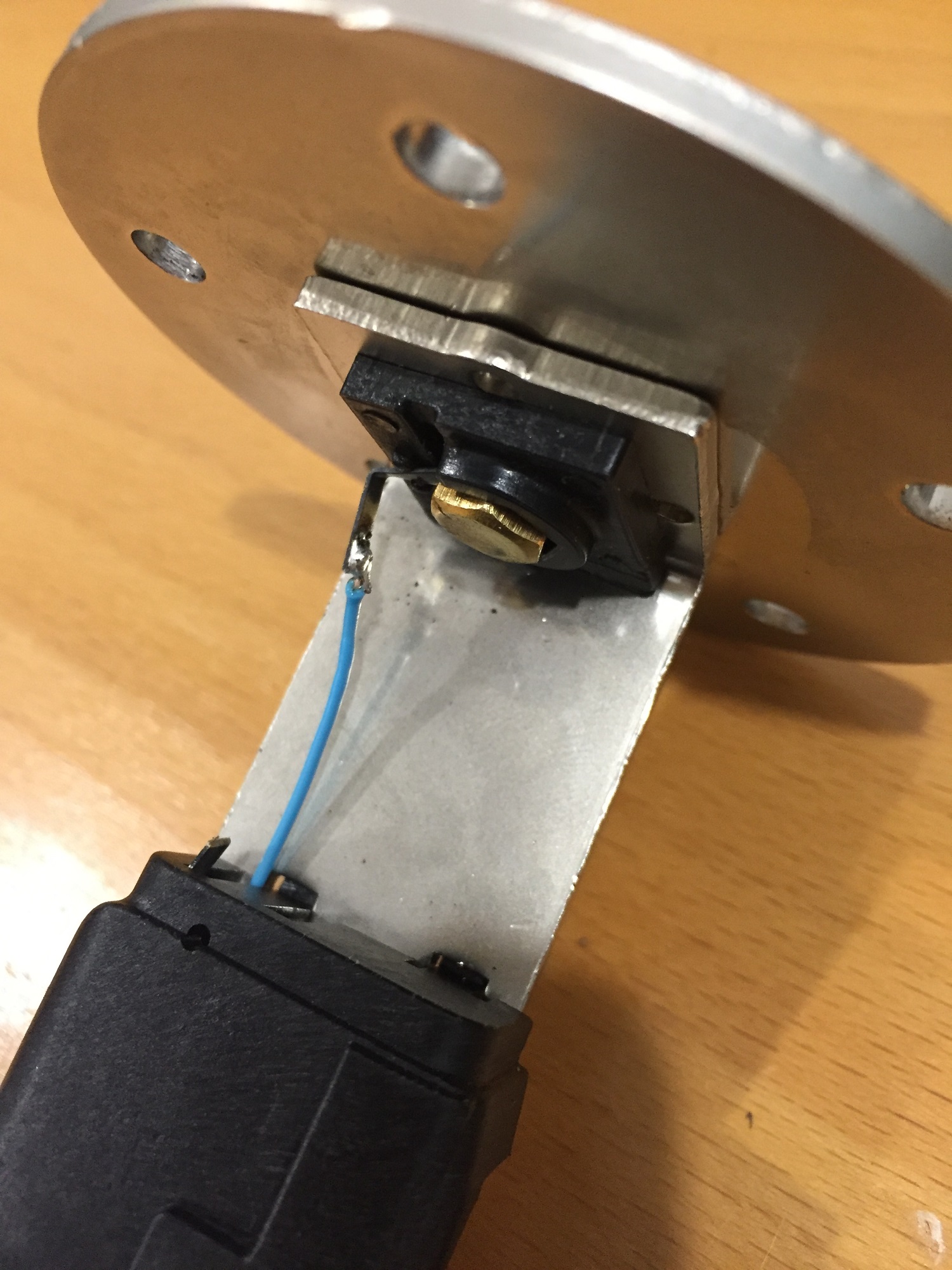

have been working on the front end a bit - got lower radiator (celica gt) brackets fabricated & placed fuel tank ... its the RCI one from summit racing - however, the sender is the incorrect ohm reading - the Porsche unit looks for 0 ohms full, 90 ohms empty - the RCI unit measures 90 ohms full, 0 ohms empty ...
so I pulled apart the sender unit and soldered on a wire on the other end of the resister circuit to measure 'correctly'
