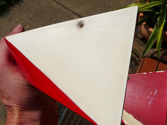

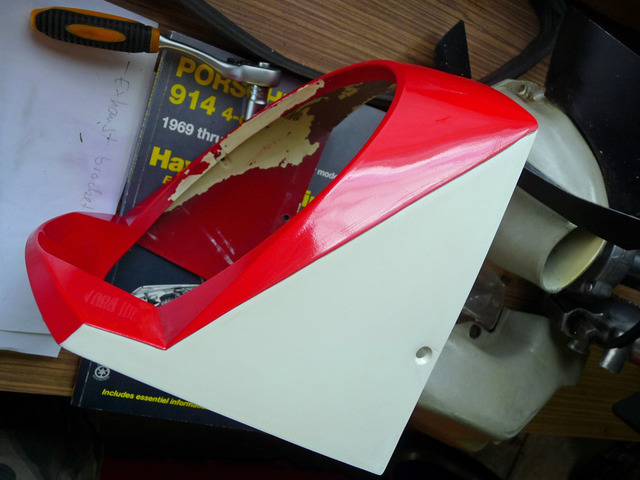

ok...I thought I'd give it a go and see how sanding works.
Acetone didn't do anything on that paint anyway...
I started with 180 until paint and primer were gone,then 240,400,800,1200 to get it nice and smooth.
The paint hasn't bled into the plastic at all.
It sure takes a while and you could get it even smoother if you put some more time into it,depending on your level of OCD.
Pretty happy with the result but will try paint stripper for plastic and see how that works.
Would it make sense to use clear coat to preserve it, polish,leave as is?
Thank you

I wouldn't clearcoat them. It yellows with time so the problem returns some day. Watch out for that acetone! It is really carcinogenic!
