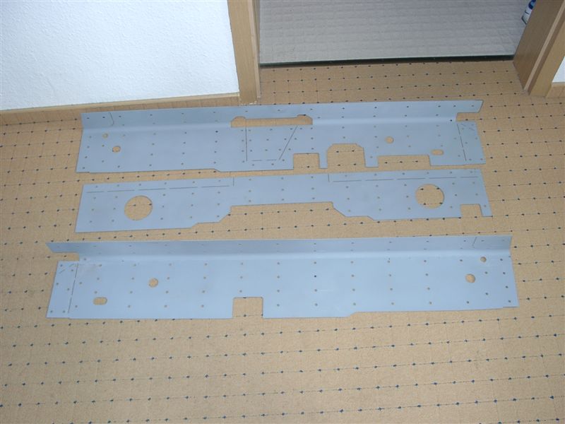

michelko   i also received last week engman´s stiffenig kit....   Sep 30 2004, 01:56 PM

SpecialK   Beautiful work michelko!! Good thing Engm...   Sep 30 2004, 07:25 PM
