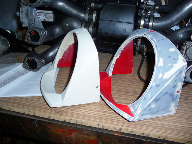

maddin   Does Acetone affect the type of plastic they used ...   Feb 14 2016, 06:56 PM
maddin   ok...I thought I'd give it a go and see how sa...   Feb 14 2016, 11:46 PM
Pat Garvey   ok...I thought I'd give it a go and see how s...   Feb 24 2016, 05:17 PM
maddin   Hi Pat, thanks for the reply...I think it'll l...   Feb 25 2016, 09:25 PM
