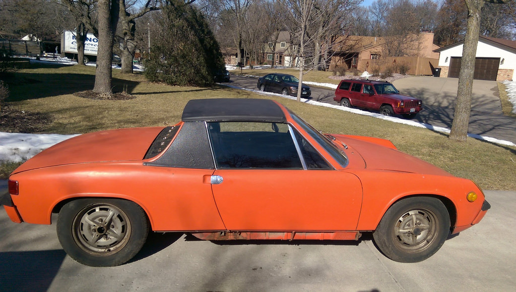

The ad claimed it was a '70 but upon inspection of the title it looks to be a '71. Not a big deal, there weren't any major changes between those years as far as I can tell.
Plans depend a lot on how much rust is hiding in there. If it's stuff that I'm comfortable welding up or replacing sheetmetal to stock, then I'll lean more towards restoration. I'll do wheels for sure, but otherwise focus on replacing old seals and rubber bits, see if I can get someone to bring the luster out in the paint again but if that fails I would paint it and keep the original color. It will be a driver, but aiming for a clean, OEM driver. Very unlikely it'll get GT flares at this point, don't want to bastardize it if it's a good example.

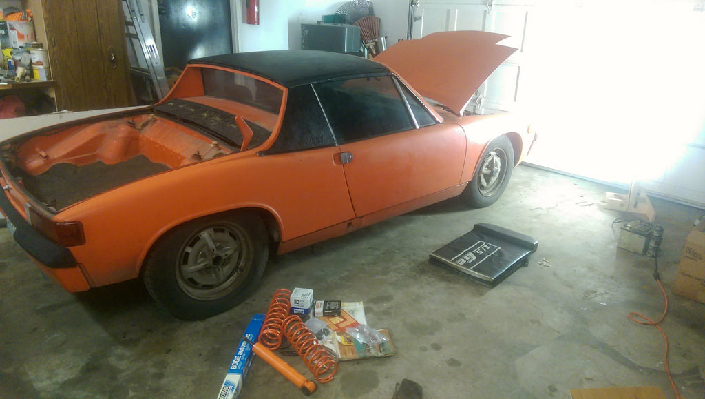

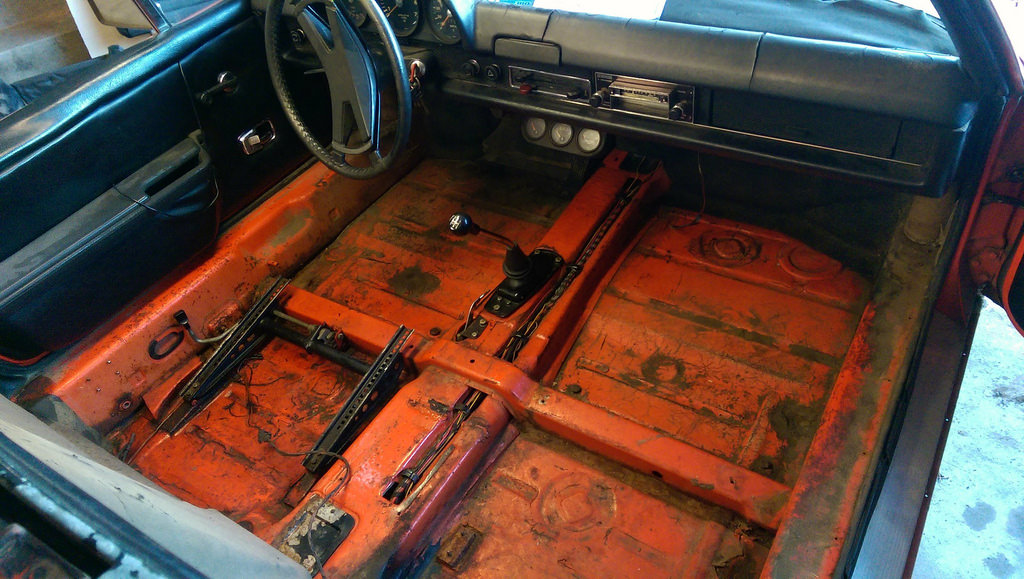

Hi guys, got it home and dug into it a little. Grabbed a few pictures while I was at it.
I think it'll clean up pretty well, but here you can see some rust hiding under the paint on the rocker.

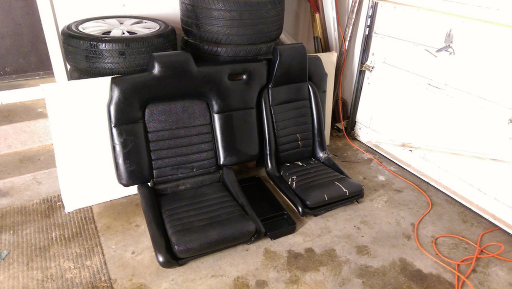

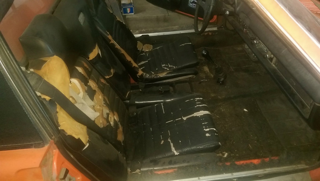

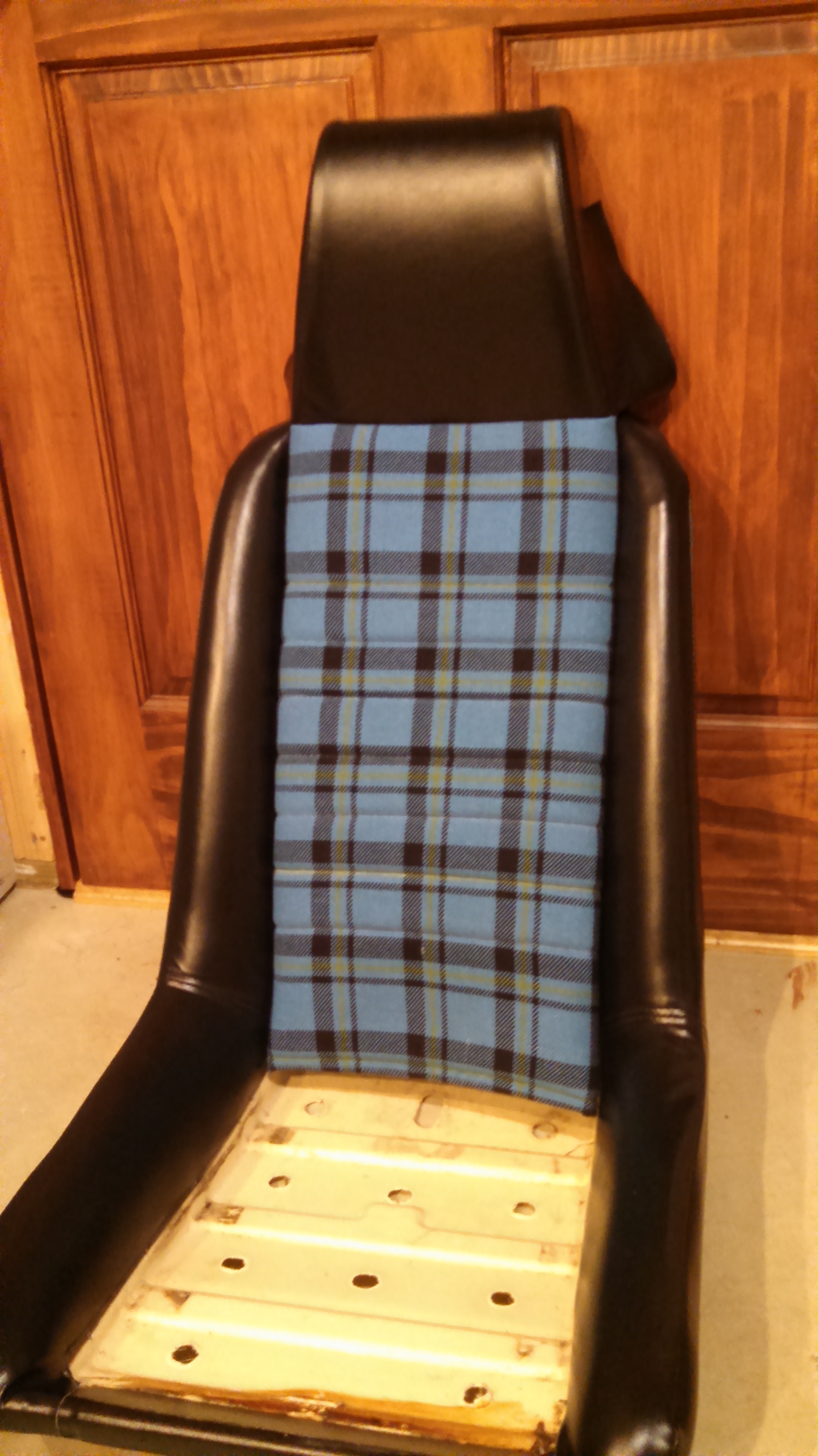

The interior is rough. I can upholster, but the foam is trashed too. Wondering what it takes to swap, and what the benefits would be.
(IMG:http://www.914world.com/bbs2/uploads_offsite/c2.staticflickr.com-19709-1456553805.2.jpg)

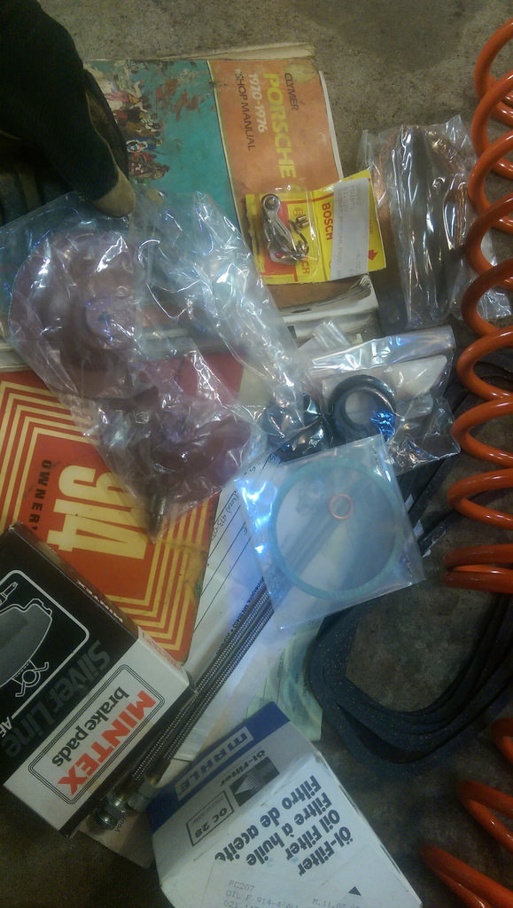

Got a bunch of goodies, and a few receipts. One of which was the clutch.

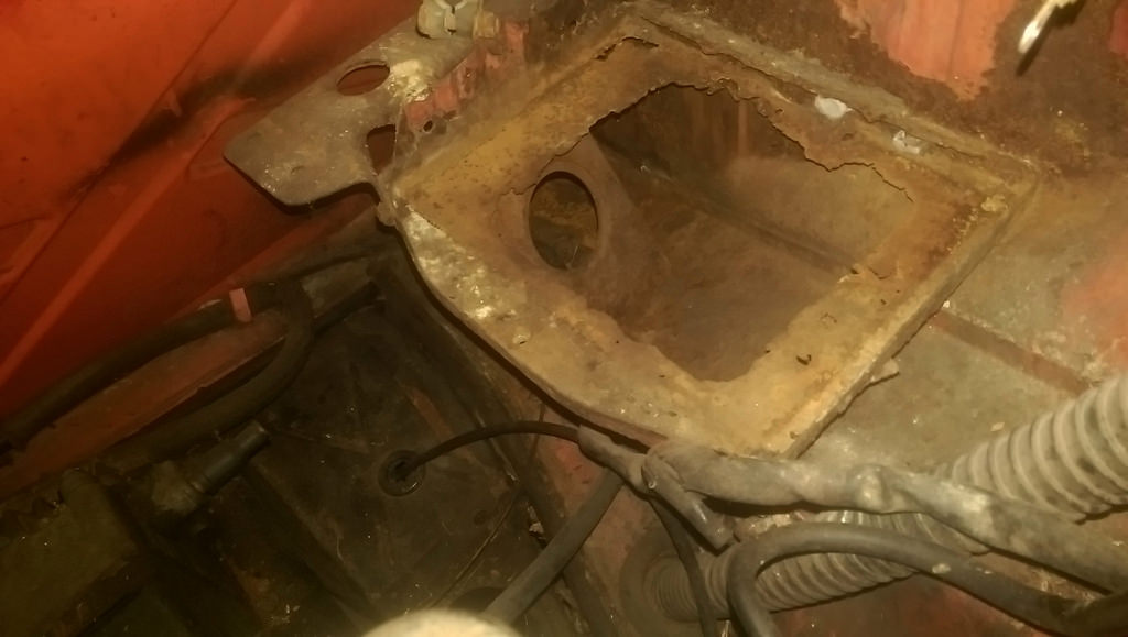

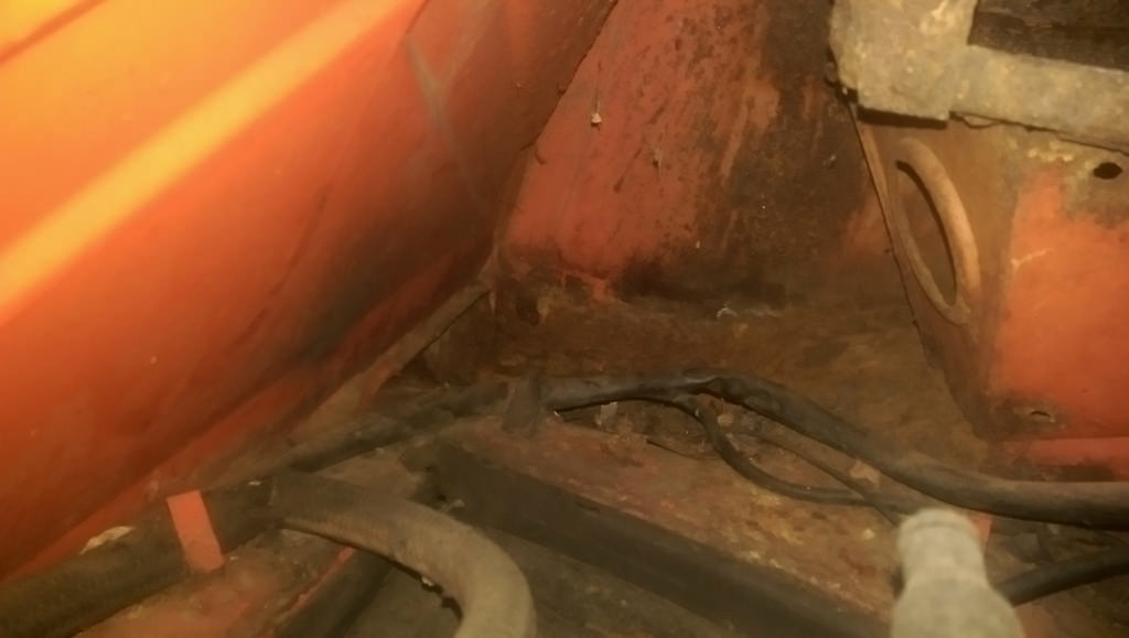

What many of you were wondering about, the hell hole.
(IMG:http://www.914world.com/bbs2/uploads_offsite/c2.staticflickr.com-19709-1456553806.4.jpg)
And under the hell hole
(IMG:http://www.914world.com/bbs2/uploads_offsite/c2.staticflickr.com-19709-1456553806.5.jpg)
I laid a long ruler across the top with the top removed, measured before and after I climbed in and stood in the middle. No noticeable flex.
I'm happy!

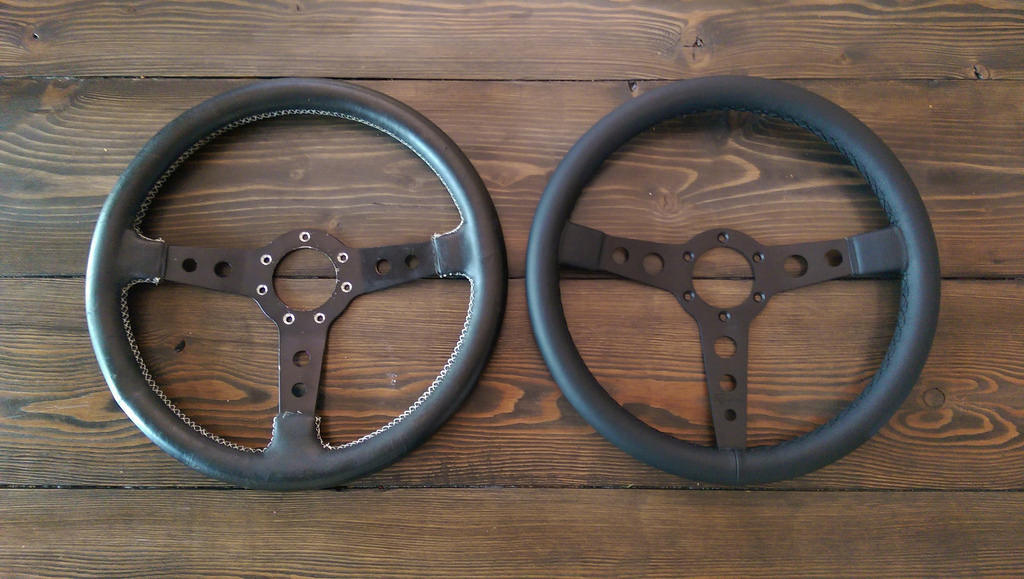

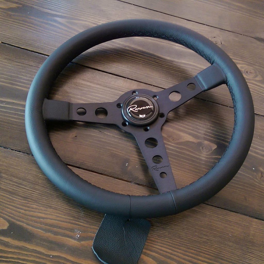

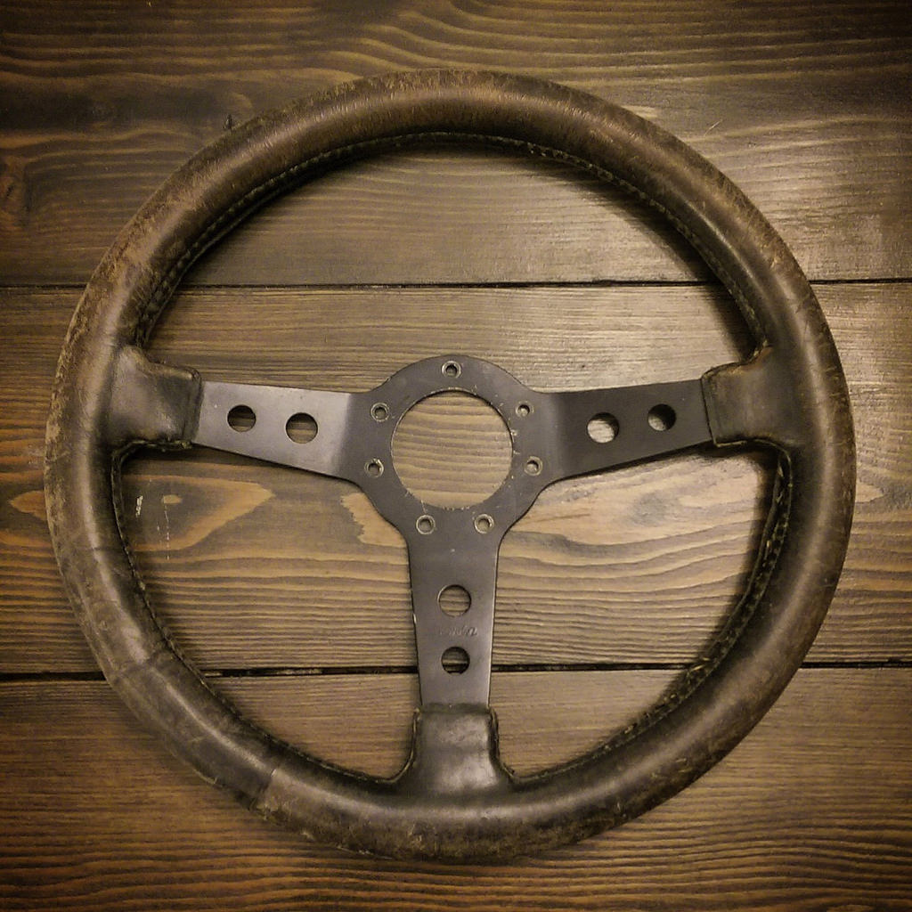

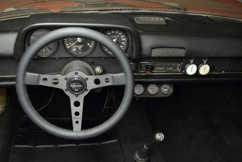

Optimusglen   Also grabbed this wheel off the bay. Leather is in...   Mar 8 2016, 06:48 AM
rick 918-S   I used the washing soda and battery charger method...   Mar 8 2016, 07:20 AM
Optimusglen   Hmm, good to hear. I'll have to do some more r...   Mar 8 2016, 10:05 AM
malcolm2   Hmm, good to hear. I'll have to do some more ...   Mar 15 2016, 10:05 AM
mbseto   Electrolysis method worked really well for me too....   Mar 8 2016, 10:56 AM

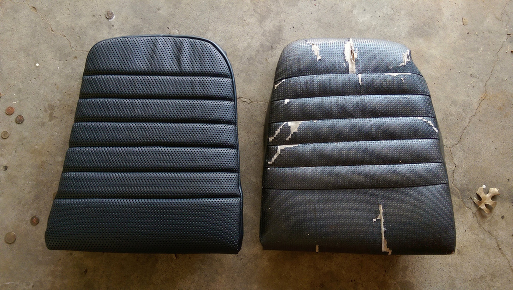

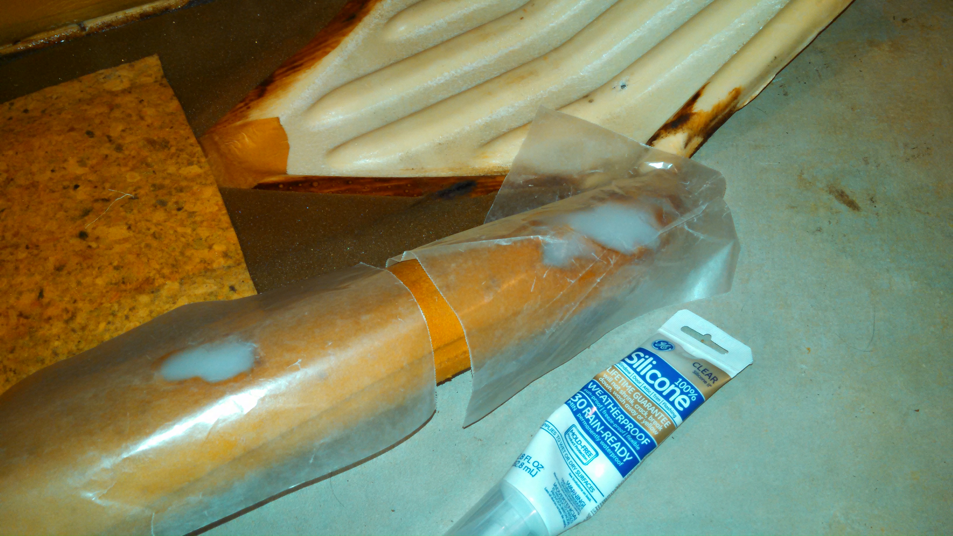

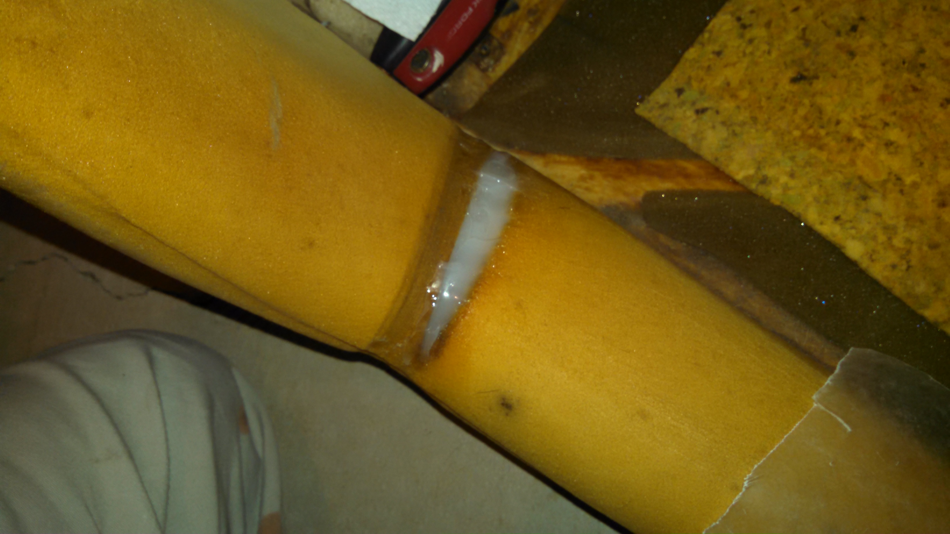

Optimusglen   hile I'm waiting for parts I thought I would s...   Mar 10 2016, 08:16 AM
JmuRiz   I wish I knew how to do upholstery work....good st...   Mar 10 2016, 11:31 AM
Optimusglen   I plan on keeping them kinda rustic and used, won...   Mar 10 2016, 11:40 AM

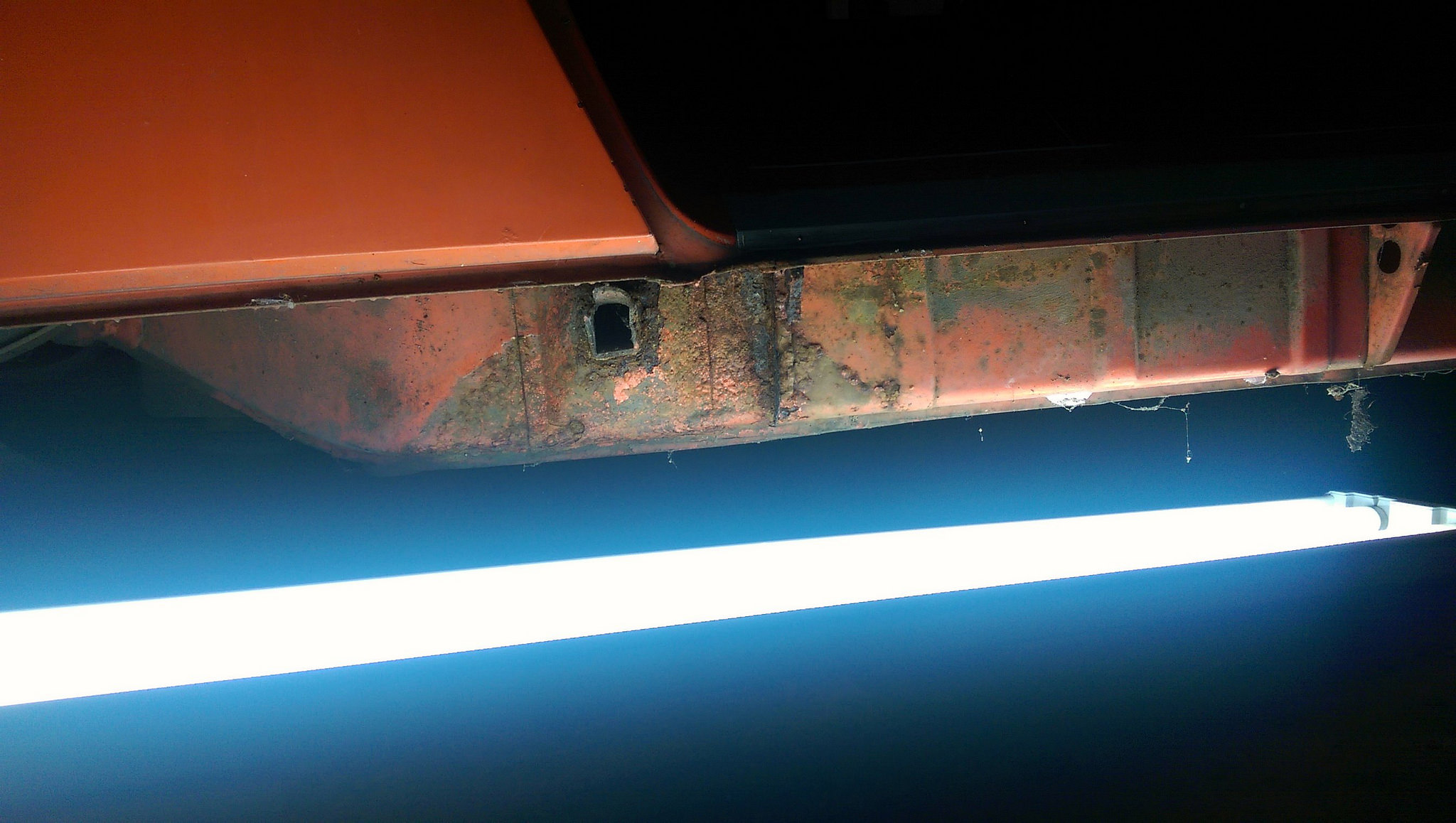

Optimusglen   Some good and some bad news for the project. Good...   Mar 15 2016, 07:45 AM
iwanta914-6   Also found a rusted through hole on the drivers s...   Mar 15 2016, 08:18 AM
Optimusglen   Obviously it depends on the extent of the rust. ...   Mar 15 2016, 09:28 AM
malcolm2   If I don't have some sort of reference point...   Mar 15 2016, 09:57 AM

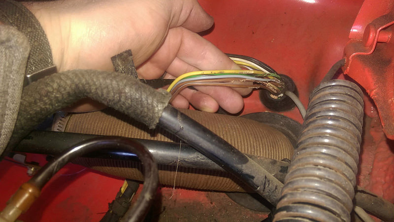

Optimusglen   Started looking at the wiring over the weekend, th...   Apr 4 2016, 10:10 AM

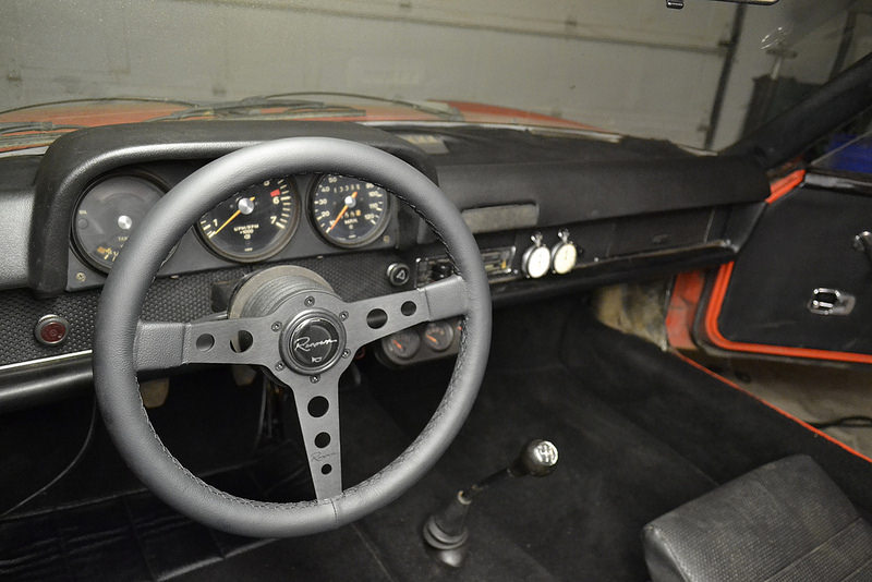

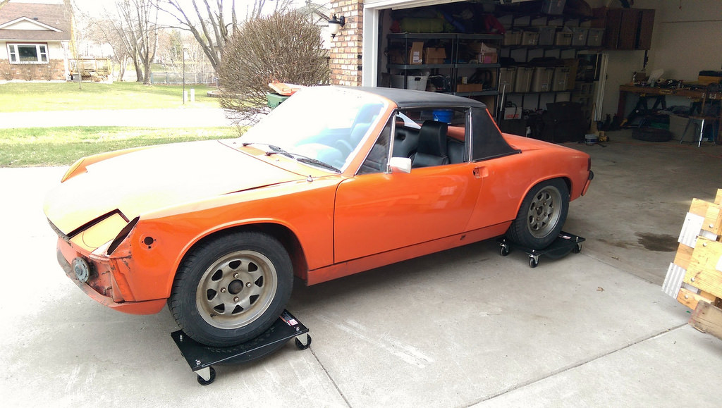

tomrev   Got the new wheels some new rubber. Went with 20...   Apr 15 2016, 08:57 AM
Optimusglen   Thanks! Today I made a completely random purc...   Apr 15 2016, 01:00 PM

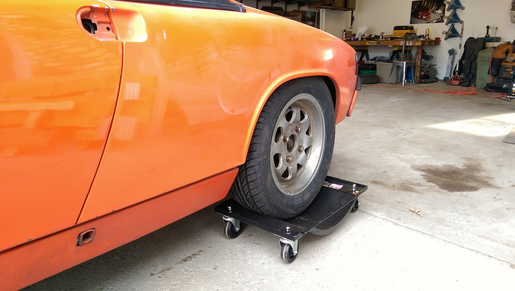

Optimusglen   On a side note, those car dollies work great on su...   Apr 11 2016, 06:58 AM
