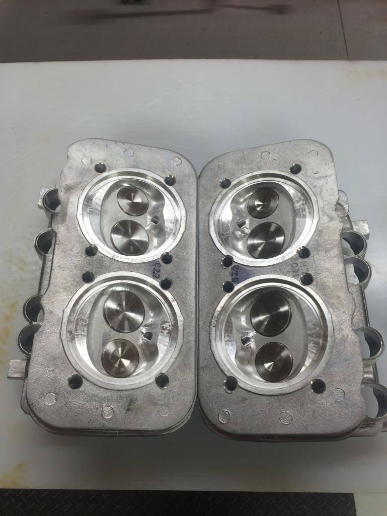

Just received a pair of HAM RS+ Spec Cyl. Heads. Those of you that have observed these beautiful pieces know how sweet they are, and how well they work. Cases are ready for me from local machine shop and I will pick-up Monday. So I can begin (again) the build.
2 Beautiful new heads...

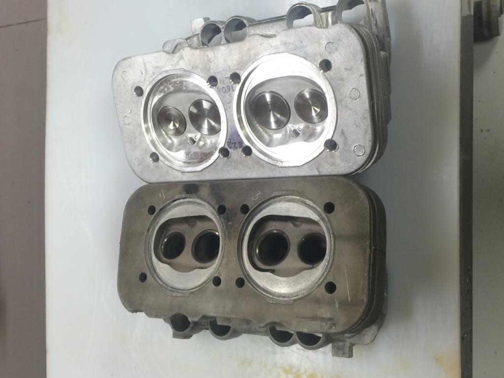

Old/Stock head vs HAM RS+ note the squish/quench area differences, plug hole has been re-angled for chamber shape...
