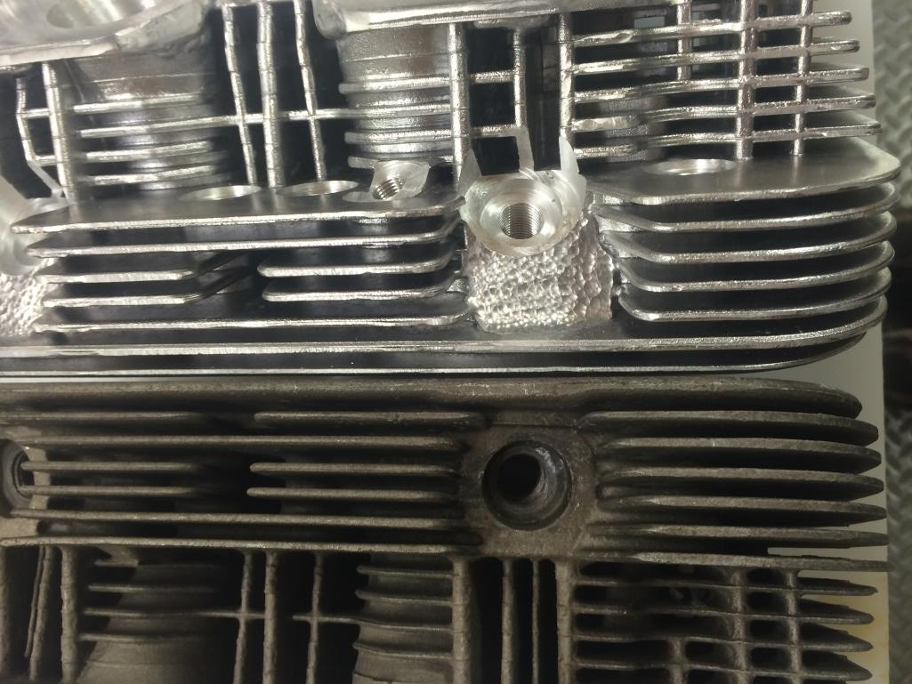

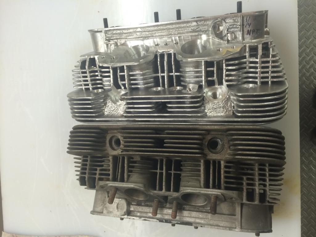

More RS+ Porn...
Notice the machinng/work done at the intake manifold surface...
Work done to re-angle spark plugs...
