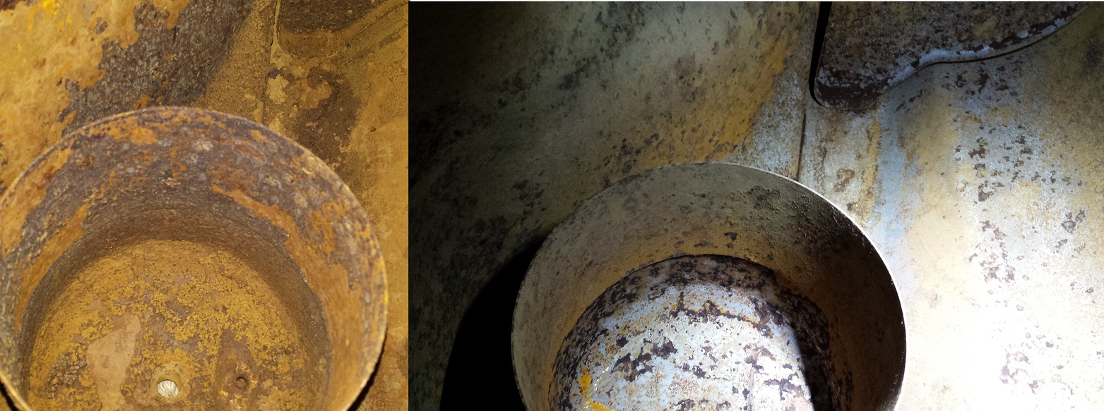

Results of electrolysis on the tank. I would turn on the battery charger and let it run overnight. The sacrificial electrode would get covered in rust and slowly the current would drop until it was too rusty to conduct. Each morning I shut it off and pulled the electrode out. After work, I would clean it up and stick it back in and do it all over again. This is the result after 4 or 5 sessions... before and after:

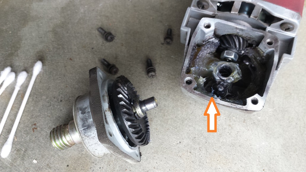

On a side note, my HF grinder spindle lock got really loose a while back and has been having trouble holding the spindle while I change discs. Took a few minutes and took the head off. Thought I'd take a look, although even 30 minutes is too much to spend fixing a 14 dollar tool. Turns out the casting broke away where it supports that little lock pin. Going to put up with it for now, if I get bored at some point I make get mix some JBWeld and fix it.
