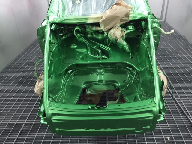

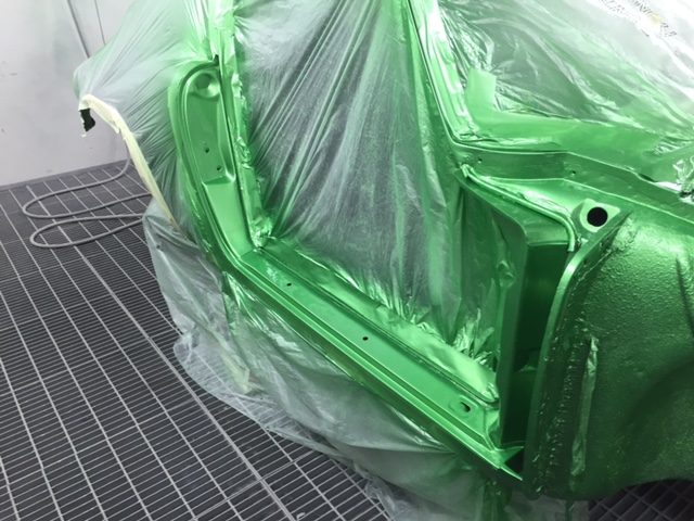

Barry enjoying the thread. And having just bought a 14 project car following with interest.
Lime green metallic - great colour. There's a 911 been painted same in Bris right now.
