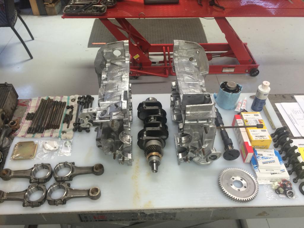

Progress so far...
sdoolin
post Mar 12 2016, 08:53 AM
Posts: 424
Joined: 1-May 14
From: LouKY
Member No.: 17,299
Hope to have the cases all assembled by the end of this weekend. Crankshaft was balanced, rods were balanced (big-ends and small-ends), and new KB 96mm pistons were weight matched.
Then working out of town for a week, then next weekend hope to work on deck height and compression ratio...
