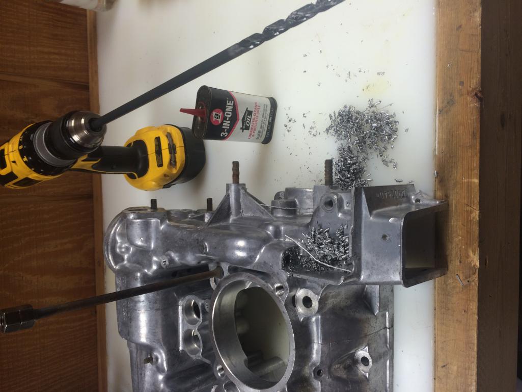

Oil Dipstick Tube fitment. Bus engine cases need to be drilled. I am using 5/16" hydraulic brake line press fit into a 5/16" hole in the case. Will secure with some JB Weld (or other) when complete.
Anyone know exact height of dipstick tube from top of case to top of tube?
Accomplished on the crude side of the shop, but I am comfortable with the solution...

QUOTE(sdoolin @ Mar 12 2016, 10:11 AM) *
I'm seeing 85 mm on a known stock case....3 & 3/8" .....
