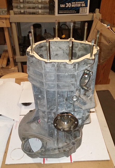

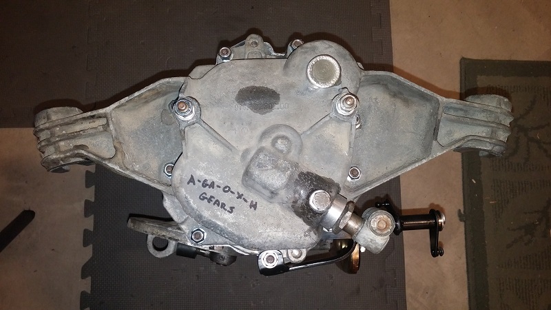

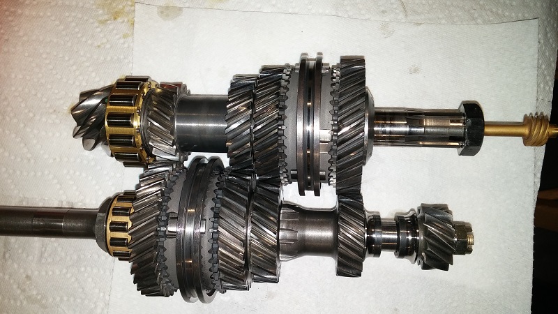

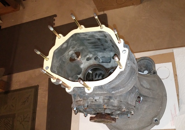

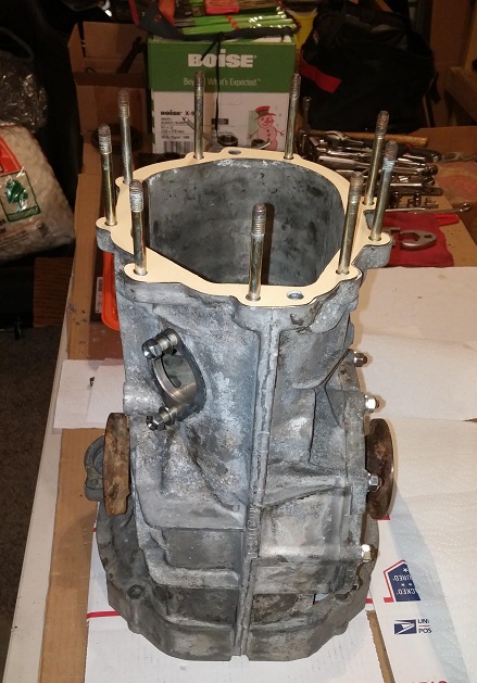

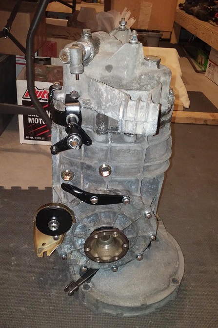

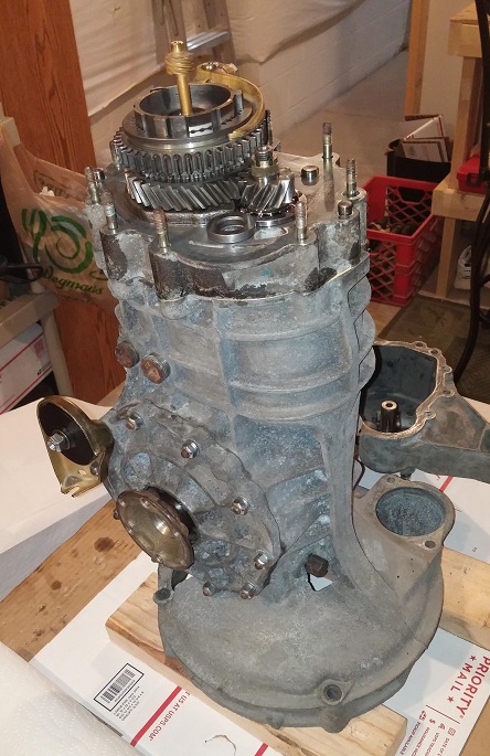

Slow winter here but we got two transmissions rebuilt.
All new bearings, synchros, gear teeth, gaskets, and swapped gears.
It's pretty easy once you have all the tools to do it right.
Made up a custom 6 throttle linkage bracket too.
Gear Ratio is now : A, GA, O, X, flipped H.
It's going to be run with the 3.0 6 .
