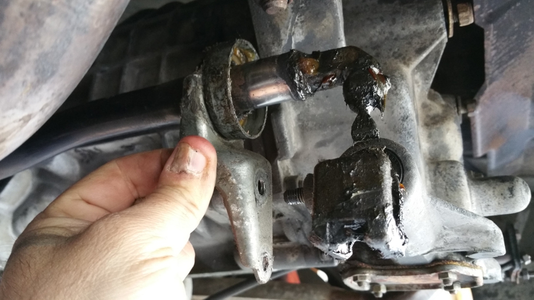

A few days ago I decided to take a closer look at my shift linkage, since my car has some serious issues. Took that rear cover off and found this: https://youtu.be/gtFysPUBIO0
I'm no engineer, but that looks nasty to me. I decided to fix it right.

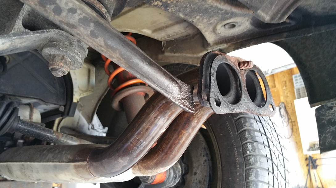

First task, remove the muffler. I need a new bracket, obviously...

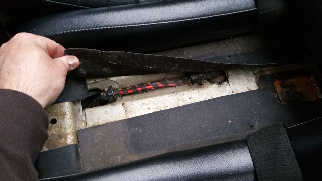

After pulling the center seat out (it just lifts up) I unscrewed the plastic tray underneath to reveal tunnel. I peeled back the vinyl to get at the little access door by the firewall.

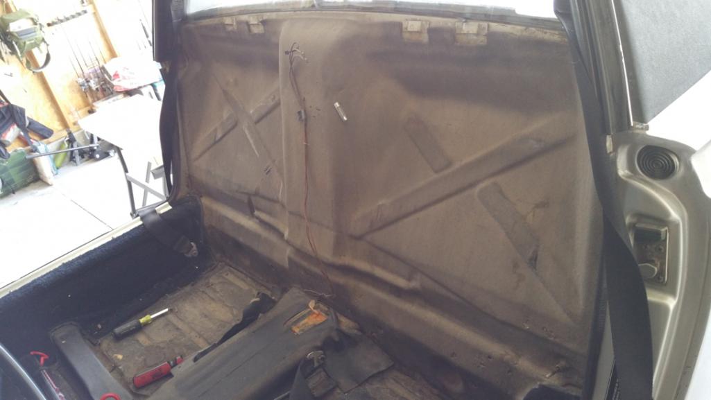

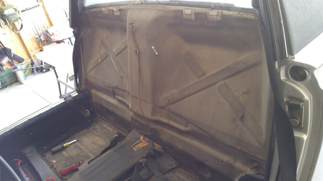

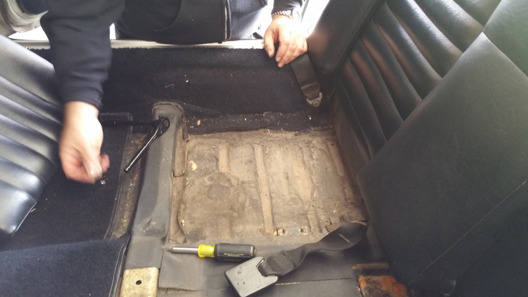

I quickly realized I would need tor remove all the seats to access the tunnel properly. Driver's seat comes out easy enough (it has that little tab to press down on the driver's side--like my 69 bug, only on the proper side!) Passenger fixed seat came out with a few nuts and screws under the bottom seat cushion and at the bottom of the back, then I slide it down and forward to remove. I unscrewed the engine lid release knob too before pulling the seat out.

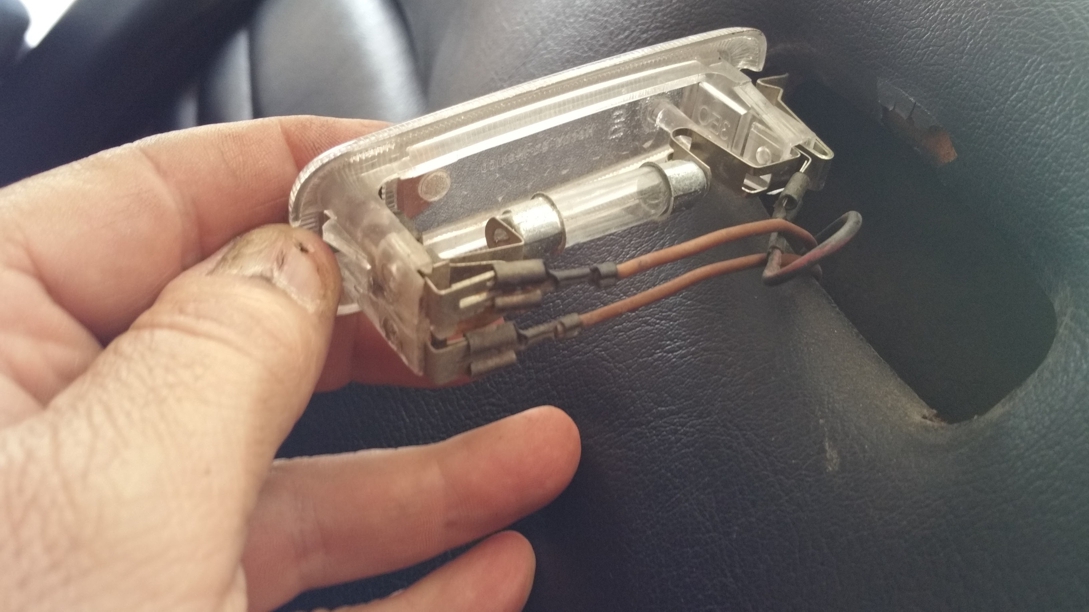

I also removed the light, and disconnected the wires before pulling the seat.
With the seat out I realized I'll need to redo the rear window rubber before I put it back.

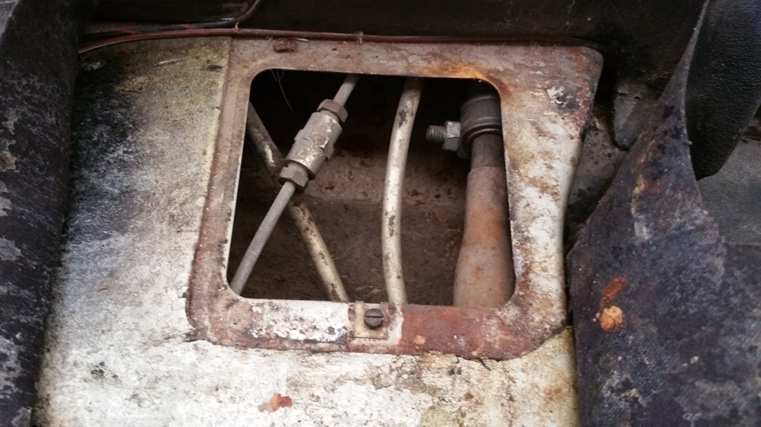

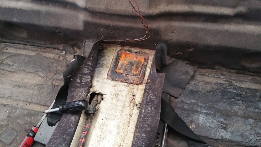

I peeled back the vinyl to expose the tunnel access panel.
Removed the little screw to remove the panel.

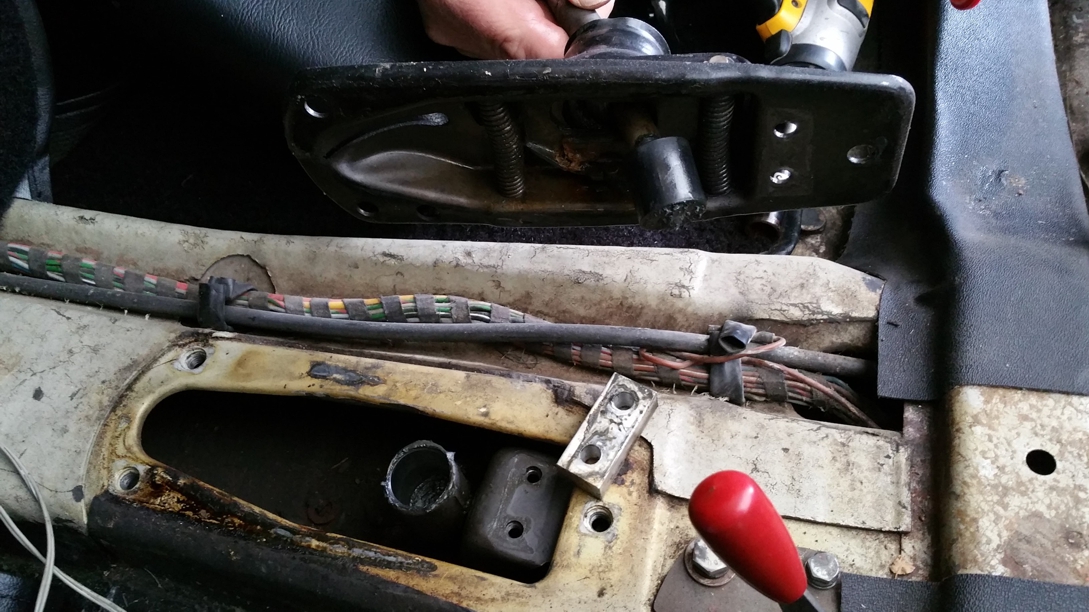

Pulled the shift knob off (it had a tiny set screw holding it on) removed the carpet, then unbolted the shifter from the tunnel.
