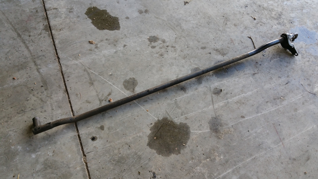

A few days ago I decided to take a closer look at my shift linkage, since my car has some serious issues. Took that rear cover off and found this: https://youtu.be/gtFysPUBIO0
I'm no engineer, but that looks nasty to me. I decided to fix it right.

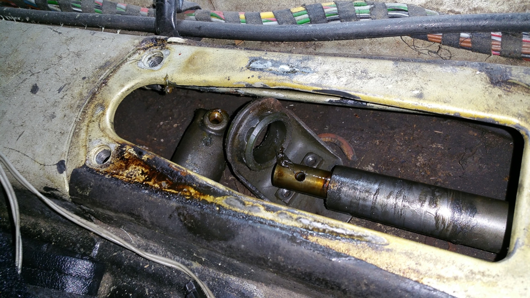

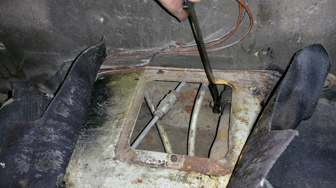

Next I loosened the connection between the two shift rods in the access panel.

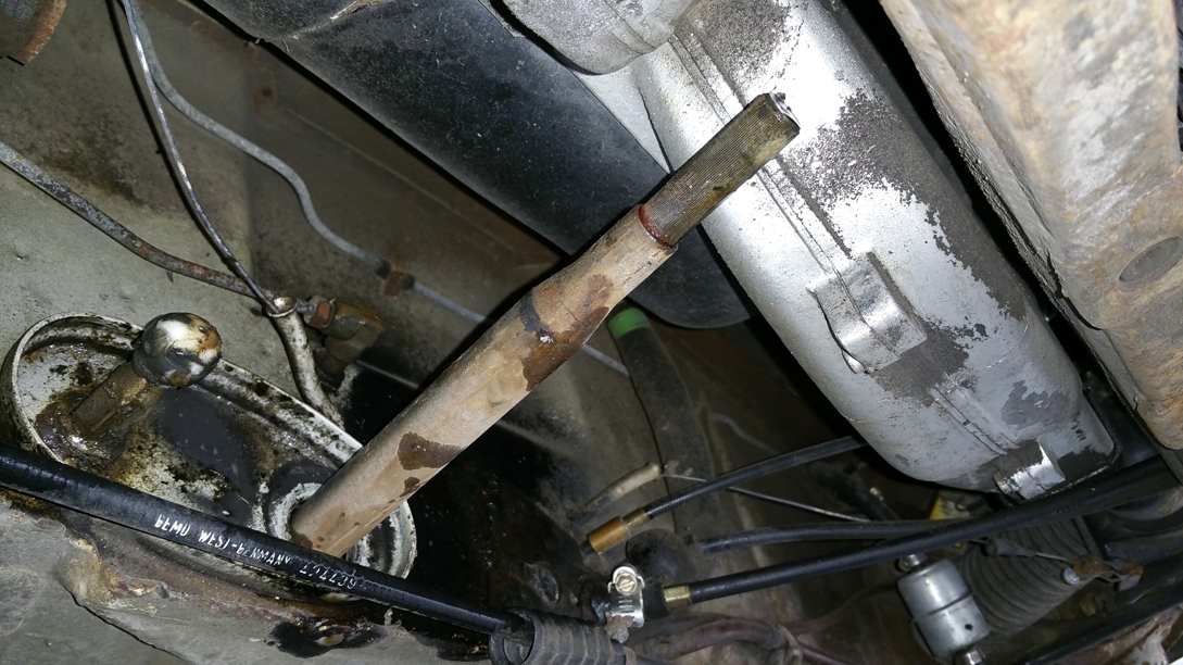

Then the shift connector rod pulled out pretty easily from behind the firewall, along with the rear shift rod.

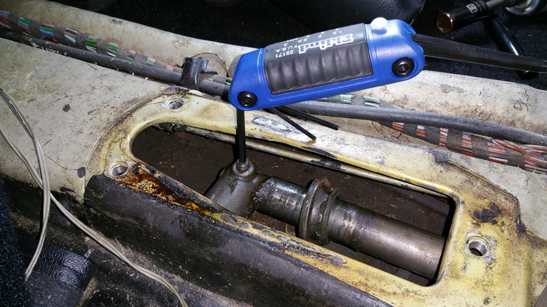

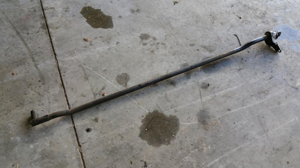

Next I dismantled the front shift rod from the shift rod head. It's a single allen head set screw with a cone shaped shaft.

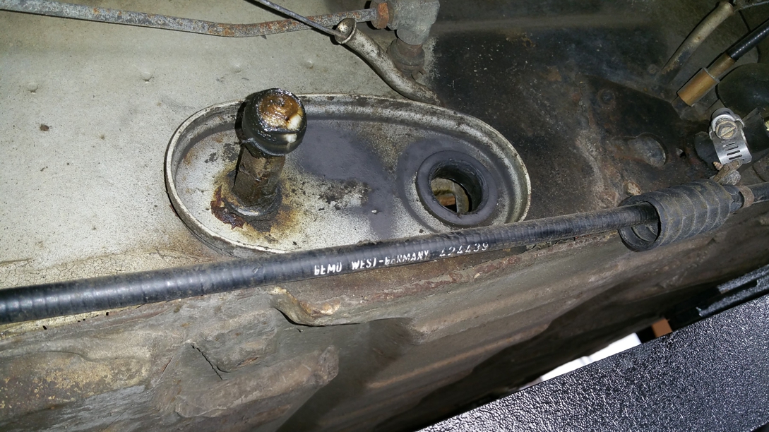

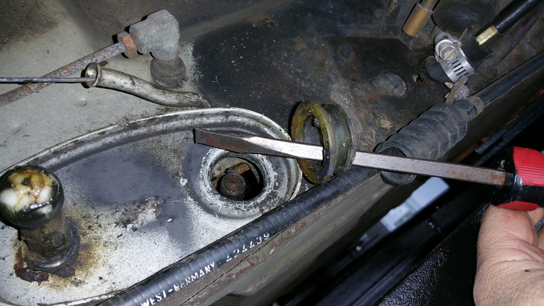

Next I removed the old bushing from the firewall by prying it out with a screwdriver. It came out fairly easily.
With the bushing out I could feed the front shift rod out the firewall.
