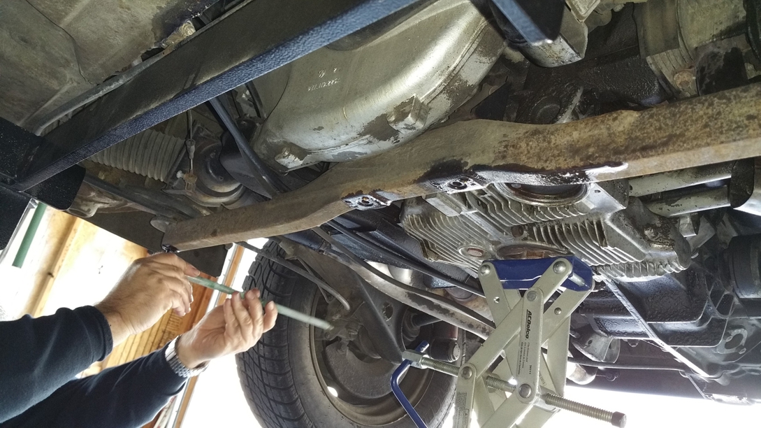

Next I began removing the engine support bar to replace it with the one that came with my side shift conversion kit.
I was told to support the engine while swapping this out, so I slid my workmate underneath and used some blocking and a scissor jack to support the engine.
