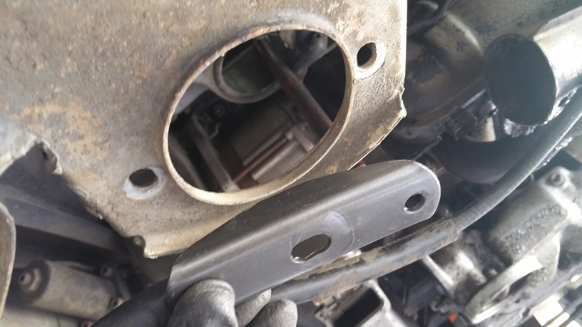

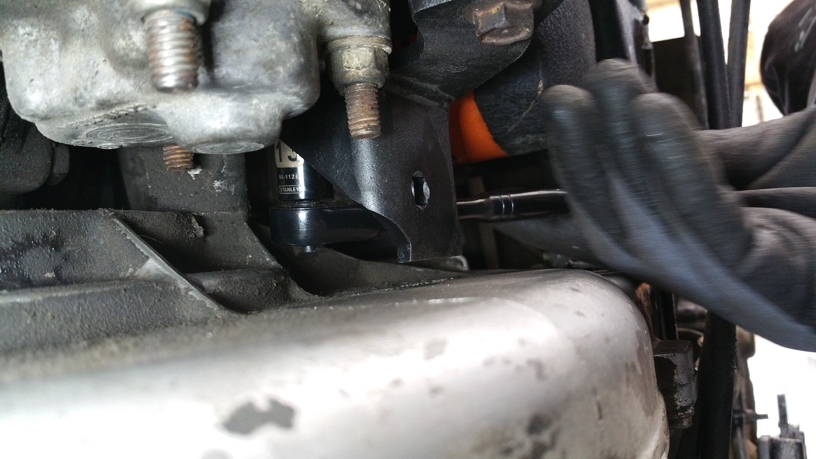

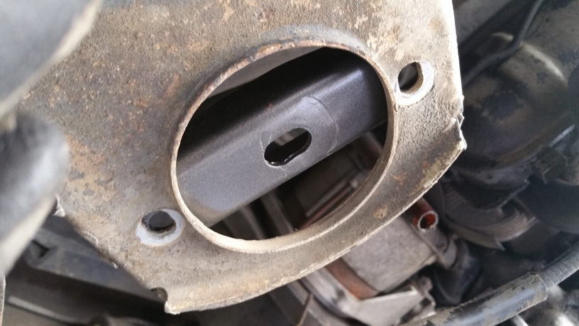

Managed to sneak in a couple hours on the 914 after work today. I took off the old engine support mounts from the chassis. I thought I'd have to replace these since the rubber was cracked, but it turns out the new bar just bolts right to the chassis, no rubber involved.
After removing the bracket that holds the engine support to the engine I bolted up the new bracket. It's a little tight access to the upper bolts, but its doable.
Can't figure out why these pics are posting rotated...

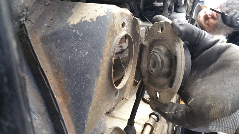

Next up the U brackets into the chassis points. These replace the rubber mounts.

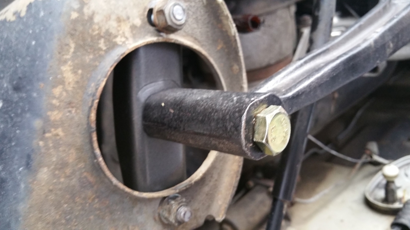

The engine bar bolts right to these U brackets. At least that what I was told, and what the parts explosion shows.

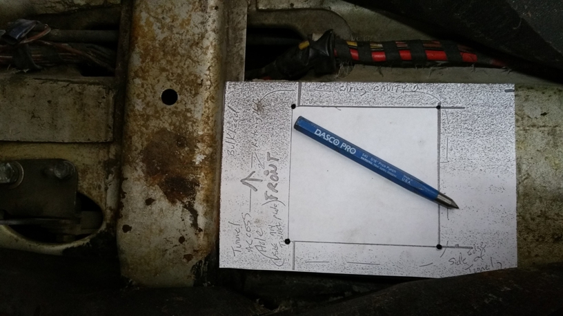

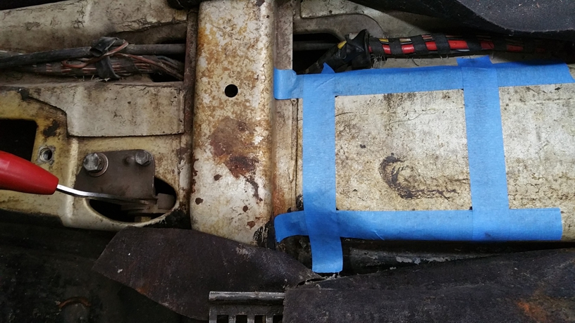

I'm doing things sort of out of order. I can't fully bolt up the engine support yet, because I don't have the firewall bushing in, which means I can't also insert the front shift rod. Which means (still with me?) I need to venture inside and start cutting holes. Here's the template for the access hole for cutting away part of the hole in the bulkhead--clearance for the new shift rod. I punched the corners using Brad's template, then taped off the outline with the ubiquitous blue masking tape.

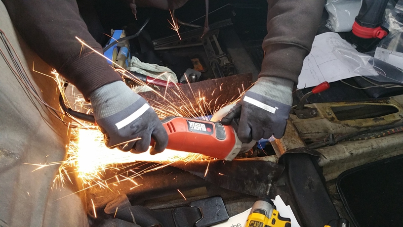

I'm making sparks inside my car. There are tools everywhere. I feel like a total hack, yet I'm loving every minute of it. This car will shift like a champ, I can feel it.

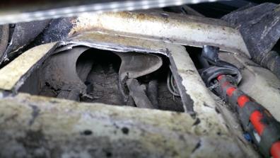

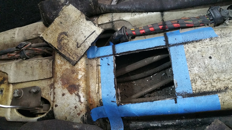

I get the hole cut without ruining anything inside. Yes! This is ripping good fun.
Look at that bulkhead, will you? This tail shift rod has been trying to escape for years I tell you! I guess I don't need to file any clearance for the new rod. I bet the right side of that puppy comes out with a couple twists. Clutch cable is unscathed, as far as I can tell.
