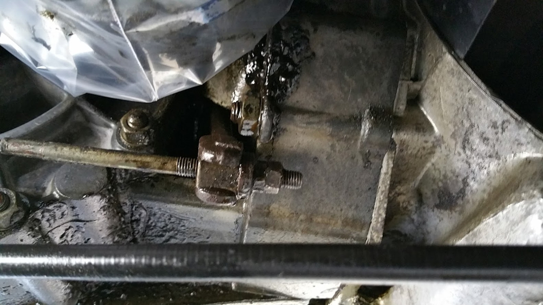

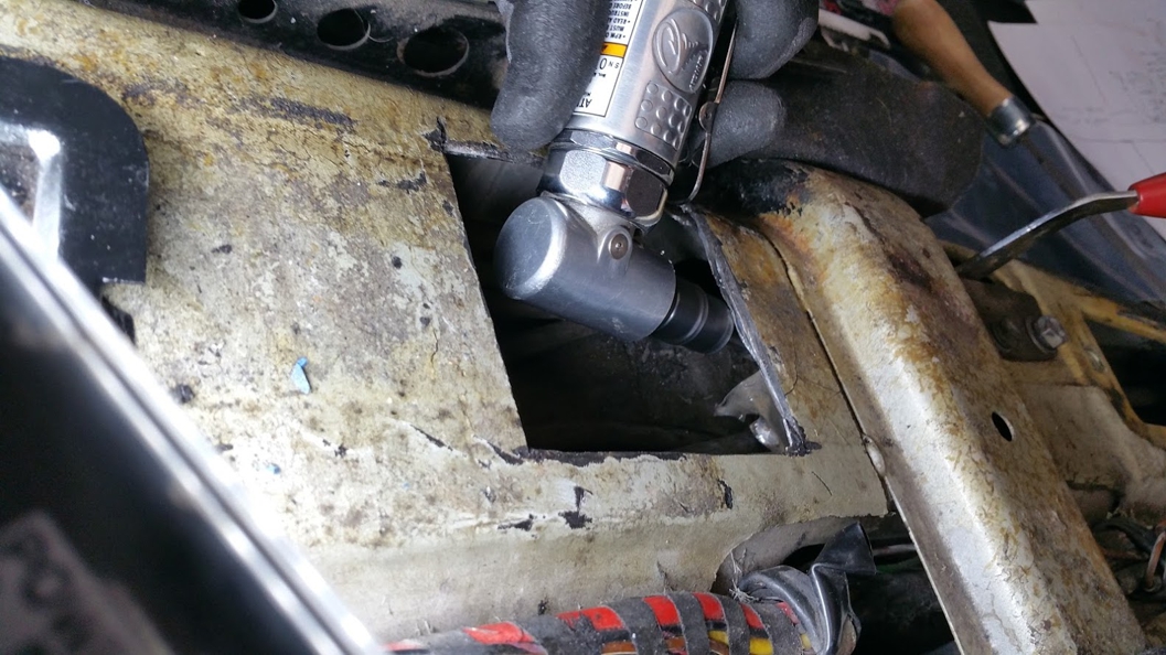

So this is the first entire day I've been able to work on the 914. Got a bunch done. First up, getting rid of the gnarly part of that bulkhead with a die grinder. I didn't manage to hit any fuel lines. Bonus!

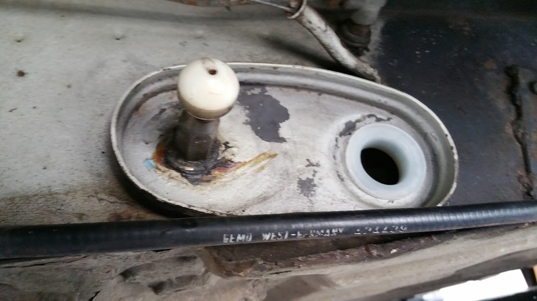

With the tunnel ready to accept the front shift rod, I boiled me some bushing and popped it in. Easy. What is everyone doing for a boot here? The raised metal flange is for tail shift setup, so I can't use a side shift boot here.

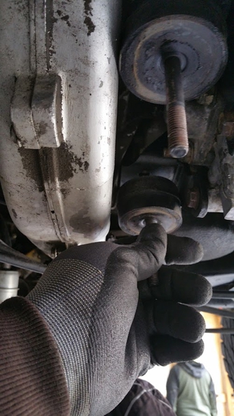

When I went to finally mount the engine support bar on I realized it was pretty much impossible to bolt the rubber dampers to the engine case (the brackets were already on the case) with the bar in place. So I ended up taking the dampers off the bar and bolting them to the brackets individually. It was still a pain to do this since access to the front of the case is so restricted. The left one went on pretty easy, but the right one was a pain. I had to loosen the upper bolt from the bracket and pivot it to get the damper mounted. Then I pivoted the bracket/damper back up and was just barely able to fit a small socket in there. The oil filter is in the way. Taking it out would make this a much easier task. But I don't have a tool for taking the filter off yet. I finally got them and the bar mounted after an hour of damned tedious work. Glad I'm done with that.

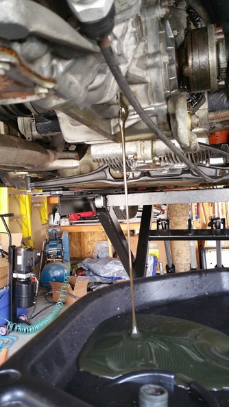

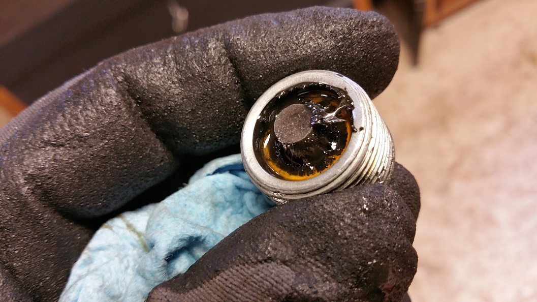

With the bar mounted I went ahead and fed the front shift rod into the tunnel through the new bushing. No pic of this. I'll take one next time. Next step is to remove the transaxle. Before I got too deep into that I decided to drain the gear oil. The first minute was dark brown and opaque. Looked pretty nasty to me, but I really have no idea what I'm talking about, so it could be okay...who knows?
The magnet had some filings on it. But nothing big (what's big anyway?)

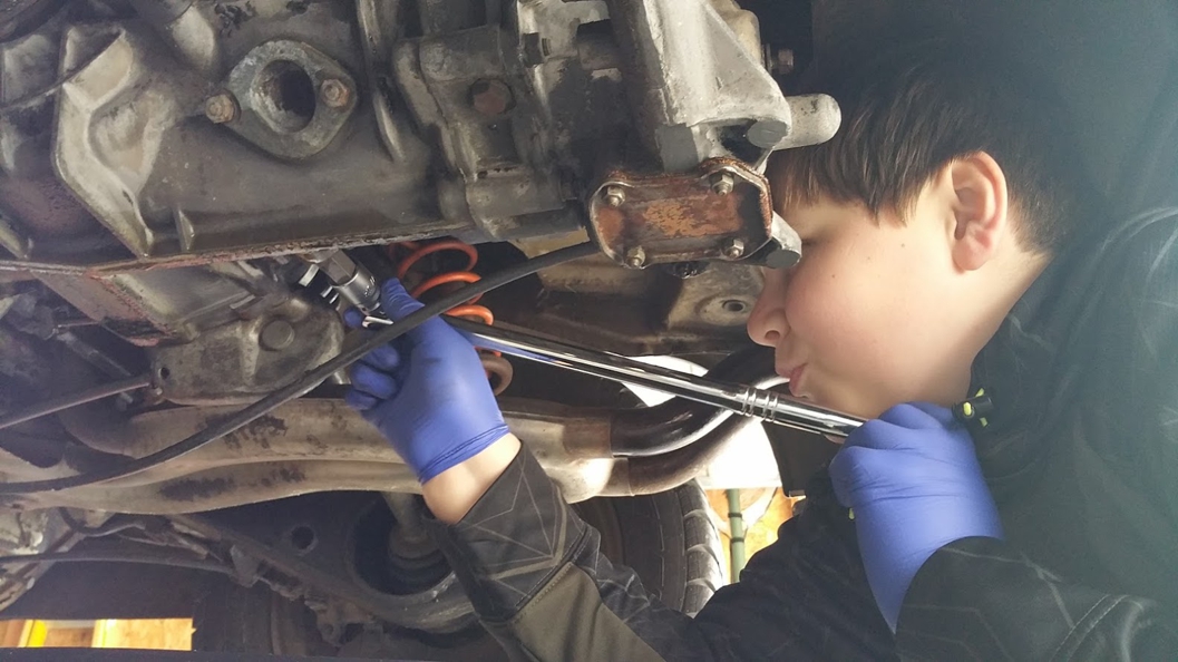

While the tranny drained I started disconnecting stuff. First the speedometer cable. I loosened the light colored nut here. Discovered it was a left hand thread before I destroyed it thankfully.

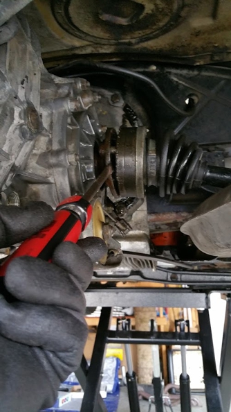

Then I unbolted the CV joints.

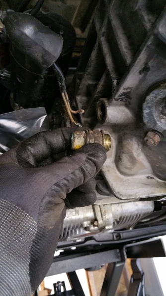

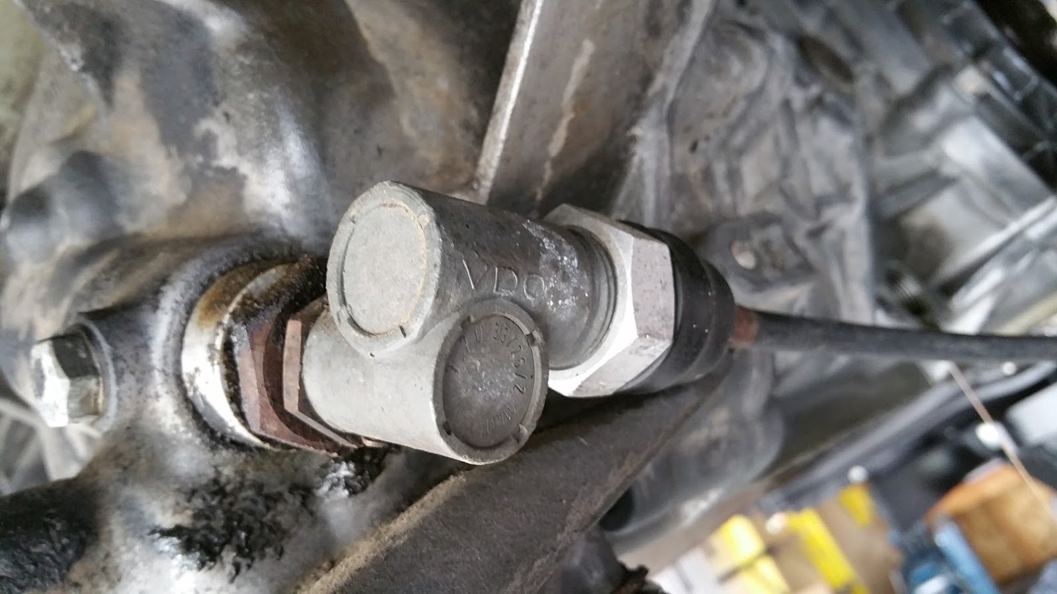

Removing the reverse light switch. Add this to the shopping list. This looks like its been at the bottom of the ocean for a century. Weird, since the boot is in great shape.

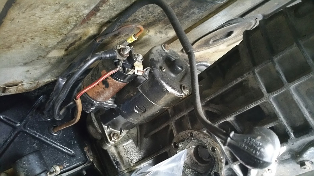

Then I disconnected the three wires going into the starter motor solenoid (I think that's right, right?)

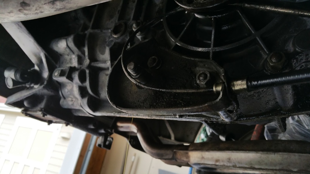

Two nuts and a washer came off the end of the clutch cable, which allowed me to pull the cable from the lever.
The center nut in the middle of the clutch pulley allows the pulley to come off and the cable to detach from the transaxle.
