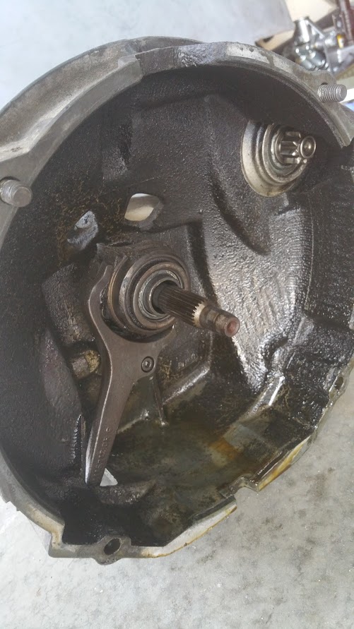

A few days ago I decided to take a closer look at my shift linkage, since my car has some serious issues. Took that rear cover off and found this: https://youtu.be/gtFysPUBIO0
I'm no engineer, but that looks nasty to me. I decided to fix it right.

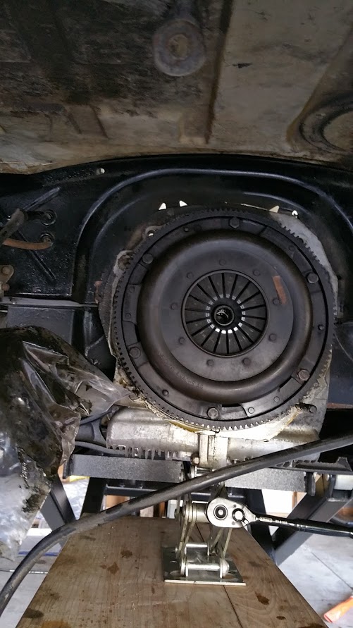

Had an hour today to fiddle with this. First up, I loosened the four bolts holding the front end of the trans to the engine.

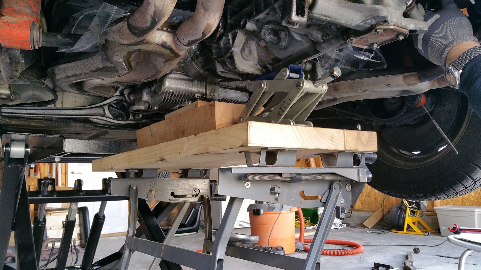

Then supported the trans and engine. I later swapped the jack and block of wood so the jack was under the engine. Gave me more adjustability.

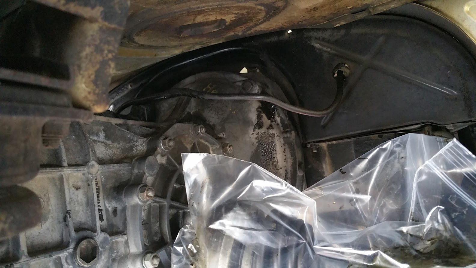

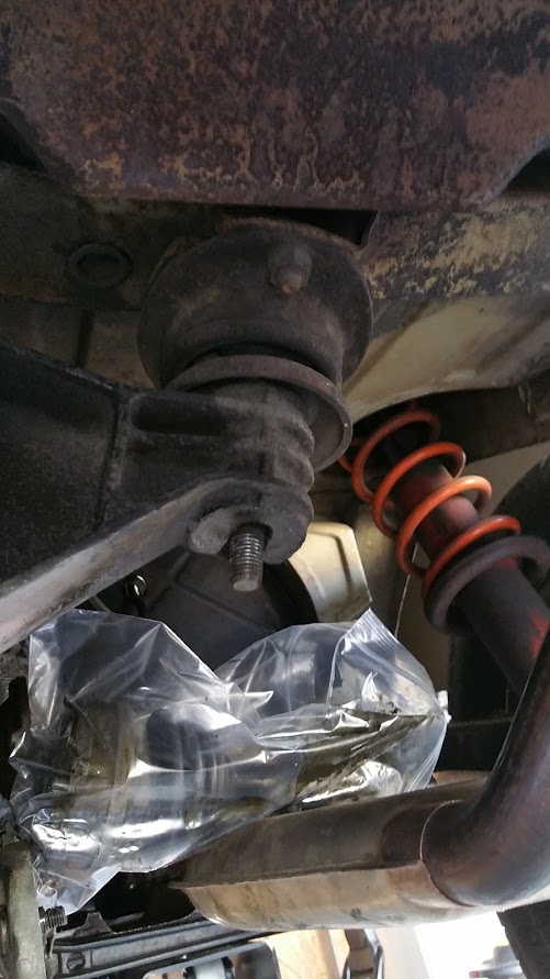

Then I unbolted the rear trans mounts.

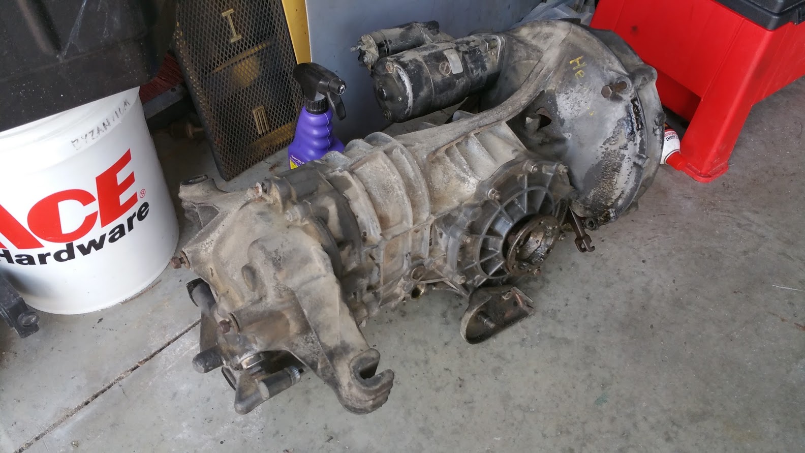

Then with some help from my brother and a few rearward tugs, the trans was out.

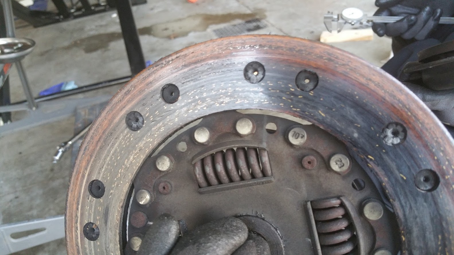

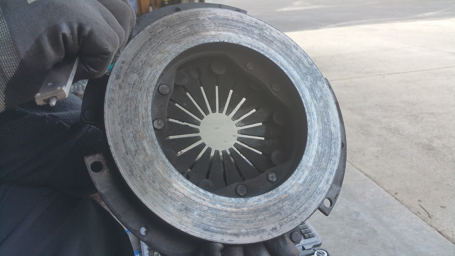

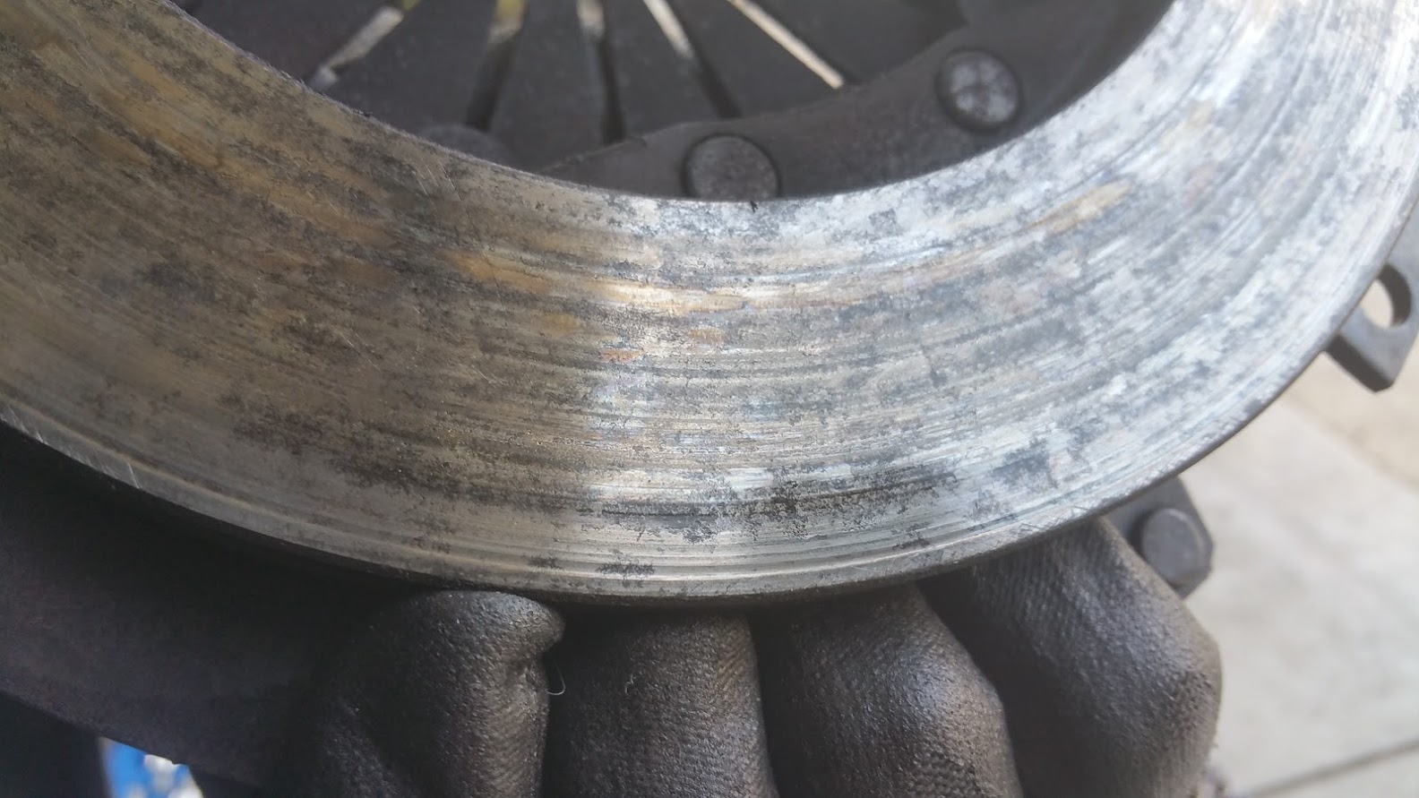

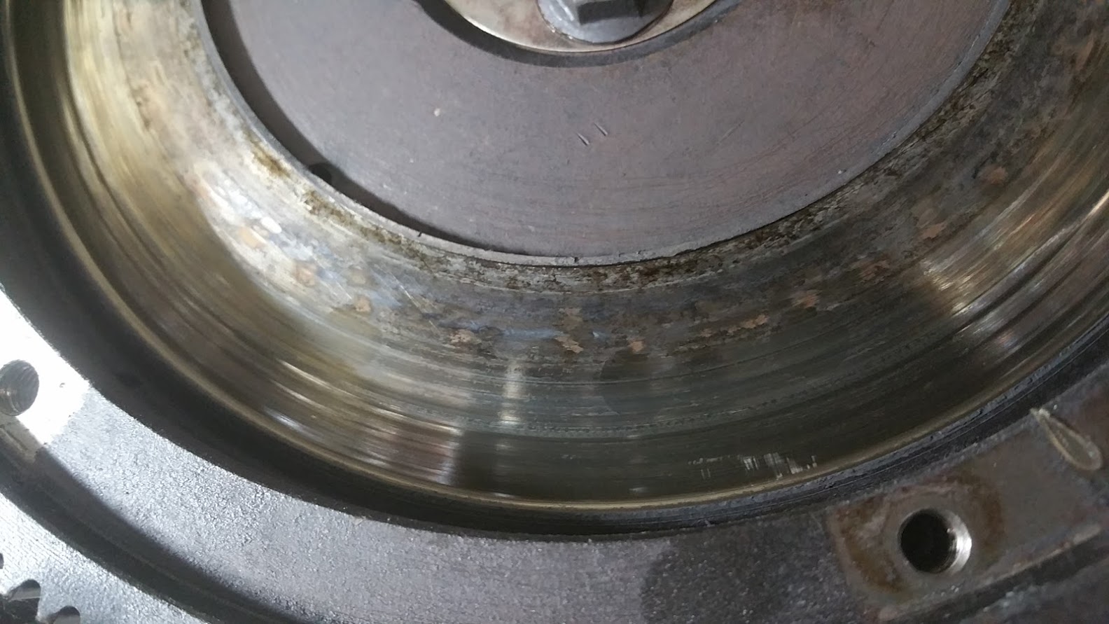

Next up, evaluating the condition of my pressure plate, friction disc and flywheel. Something tells me they need a little attention....
