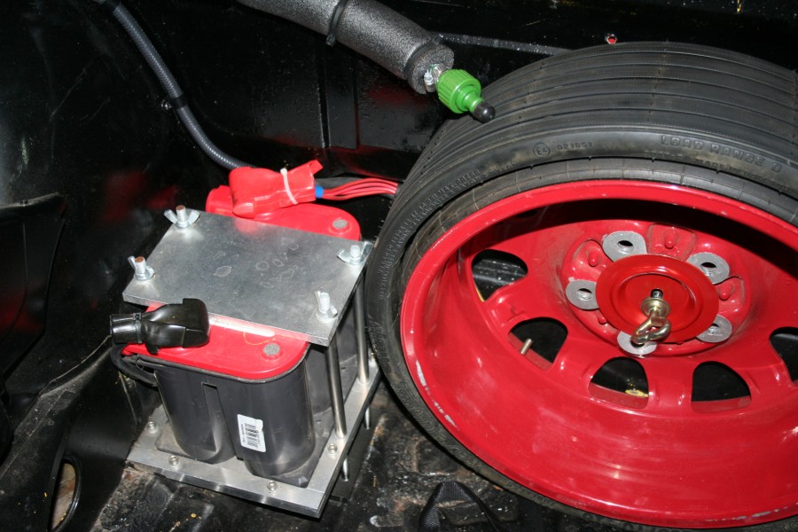

This battery (mounted up front where is should be (IMG:style_emoticons/default/biggrin.gif) ) has been in the car so long, I can't remember when I bought it. Of course I can't remember what I had for lunch yesterday so...
