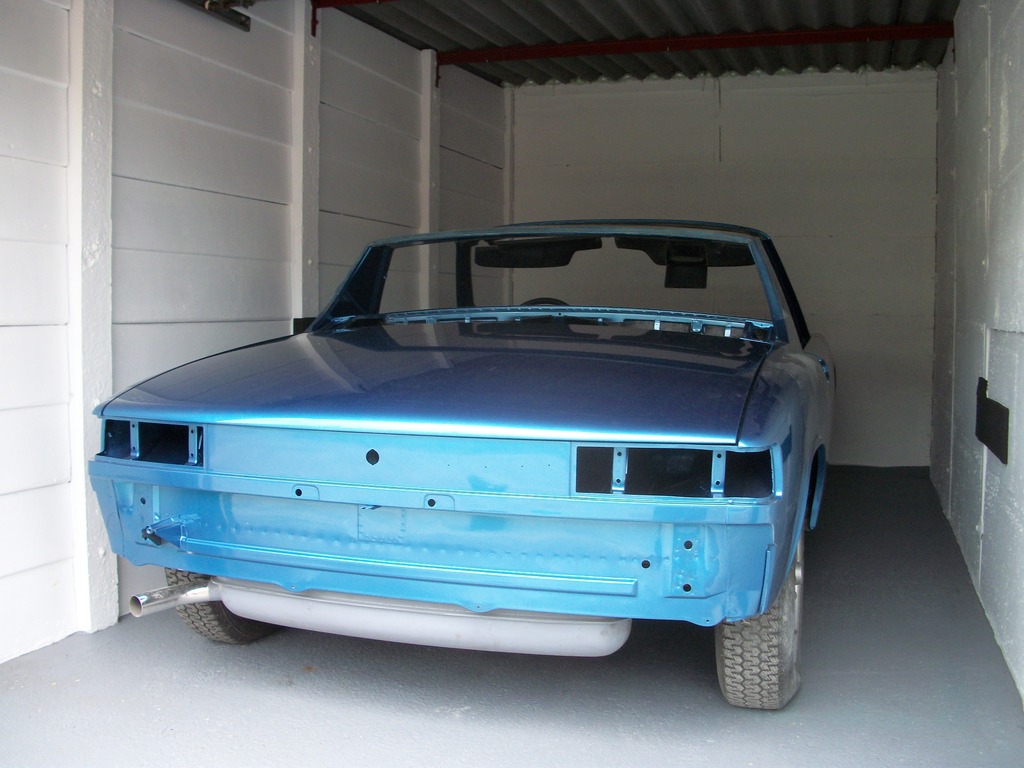

This morning I picked up the car from the paintshop. The weather was kind and the sun shone as we carried it home. Quickly unloaded and tucked away in the garage I left for work.

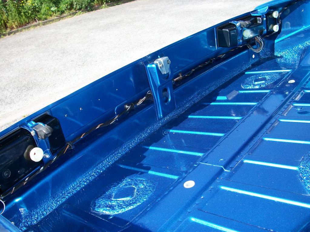

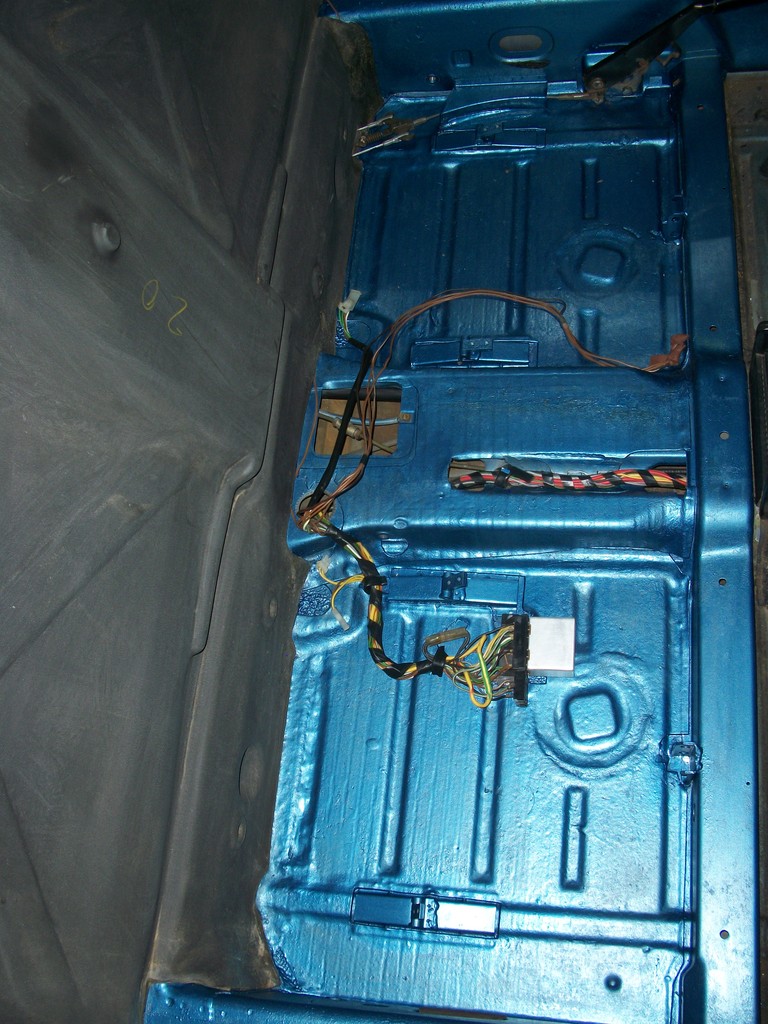

Anyway with my old seal cleaned and fitted I un-bagged the rolled up wiring loom that was in a carrier bag in the engine bay. Working to the deadline of getting the car ready for paint, I’d simply bagged it up out of the way without inspecting it.
Suffice to say the section of wiring loom running along the rear of the car between the lights had been painted blue! No surprise really as the back of the lights had blue overspray on them when the Muppets painted the boot floor long ago.
The only way to sort out the loom was to take off all the spiral binding tape and clean each strand by hand with a cellulose thinners soaked rag.
So there goes 3 hours this evening….Anyhow I got it all off before re-binding the whole rear loom with new black insulation tape being careful to replicate the helix binding pattern so the wires show through as if it was brand new.

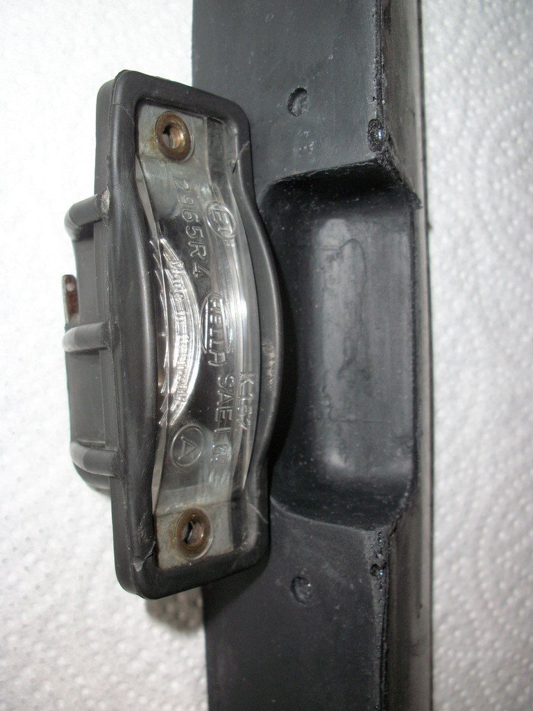

The numberplate light spades looked sorry too, so I did the same with them.
While they were soaking I fitted a few bits from my bag marked “rear boot”. The roof clamps went in with my security head bolts…perfect, look just like rivets but easily undo able if a clip breaks in future. The jack straps, boot floor plugs, two large caps in front of the shock mounts and the rubber shock mount top covers all got fitted.

Rear wiring loom all in place and new grommets fitted for the number plate wires finished off the rear boot.

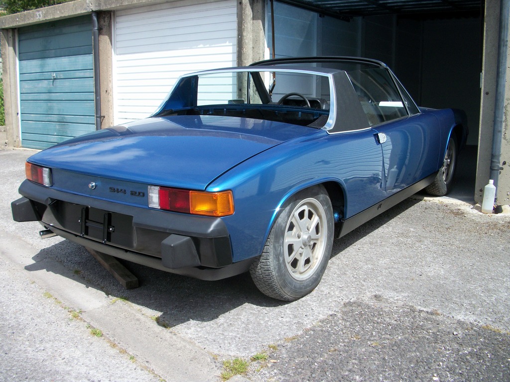

I have mostly been putting stuff back on the car….

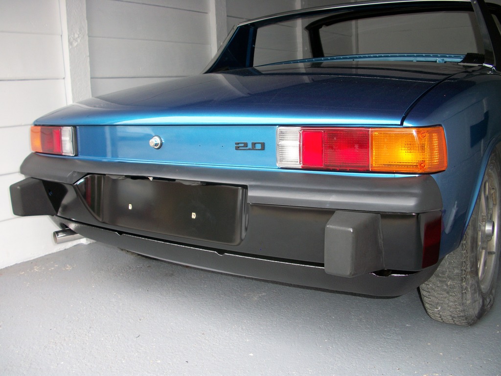

The rear boot is finished apart from the seal that I need to identify in my big box of bits and it looks lovely. I fitted the 2.0 badge with a tiny O ring of caulking around the pins on both the outside and inside (you can just see the grey caulking in the picture) of the car before fitting the new rubber encased star washers on the rear. No water or rust will get in here!
(IMG:http://www.914world.com/bbs2/uploads_offsite/i265.photobucket.com-18255-1458845898.2.jpg)
With the lights in, it’s starting to look more like a car.
(IMG:http://www.914world.com/bbs2/uploads_offsite/i265.photobucket.com-18255-1458845898.3.jpg)

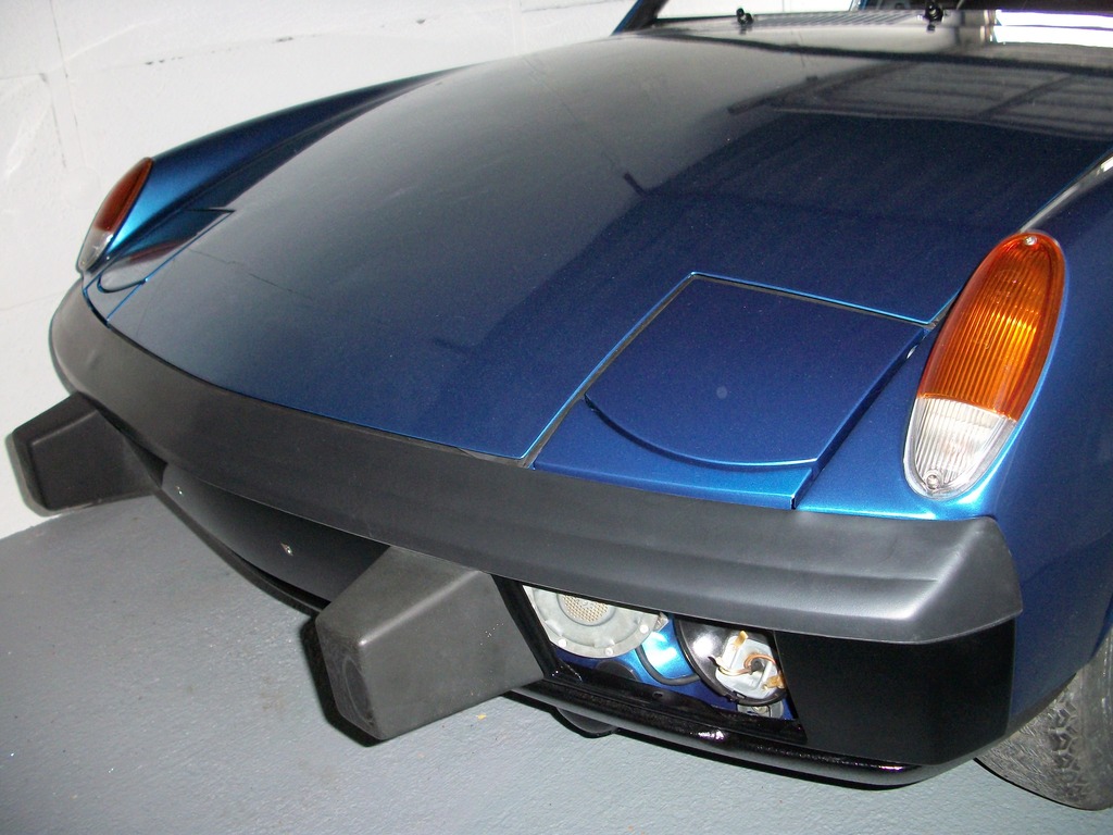

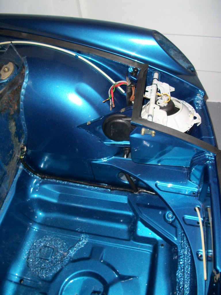

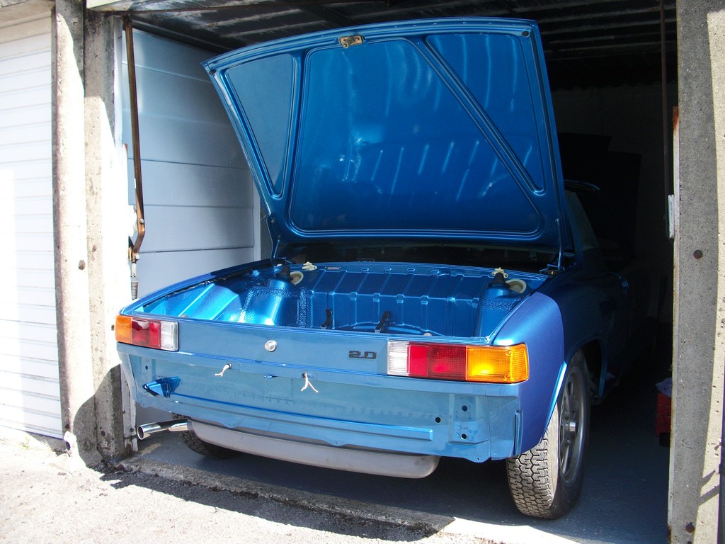

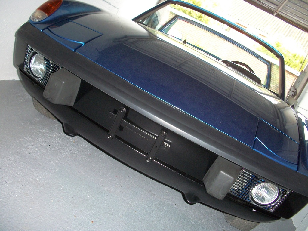

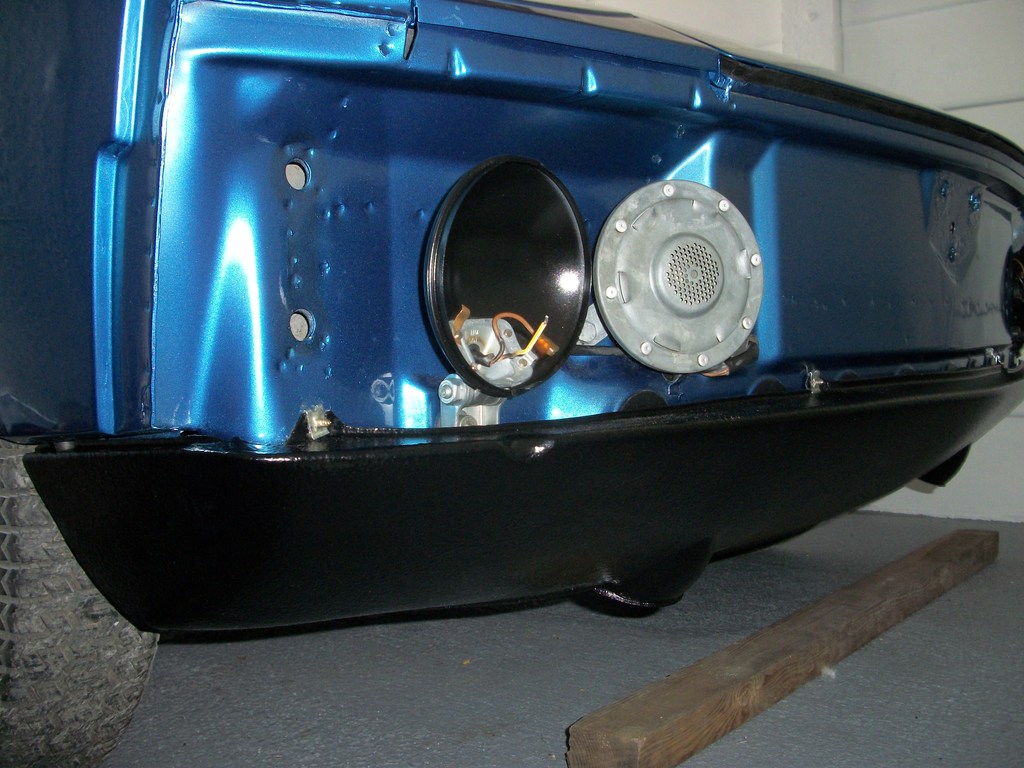

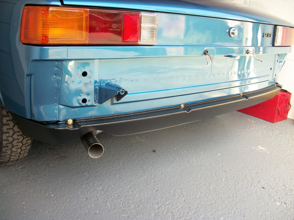

Working in the bonnet (trunk) area I fitted the pop up lights (less motors) and the new bonnet seal. Glued in with high temp impact adhesive. It needs to settle a few days from where it was folded up in the bag it came in which creased and deformed it a bit. Should be back to shape tomorrow as this evening it was far, far better than when it came out the bag in the morning. What a fiddle it was to fit, but went well in the end.
(IMG:http://www.914world.com/bbs2/uploads_offsite/i265.photobucket.com-18255-1458845899.4.jpg)
(IMG:http://www.914world.com/bbs2/uploads_offsite/i265.photobucket.com-18255-1458845899.5.jpg)

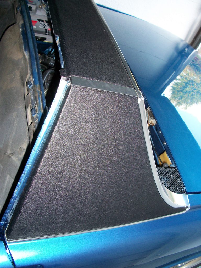

With the rear of the car masked up still, I decided to remove all the old glue from the roll bar top and sails with a cloth soaked in white spirit. Turning the rag repeatedly I removed all the glue residue. Next I sanded out the paint line where the paintshop had painted the rear quarter and up on to the base of the sails each side. There was only the tiniest of paint steps but I didn’t want it to show through the vinyl. All surfaces were then keyed very lightly with 240 grit, and wiped off multiple times with a tack rag.

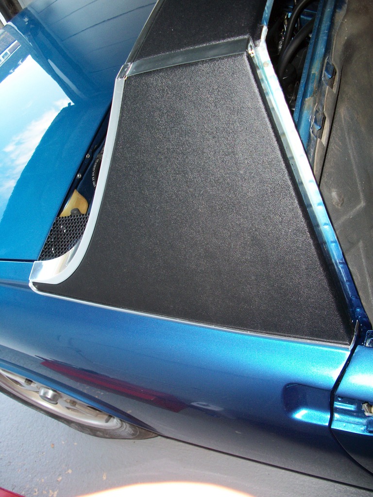

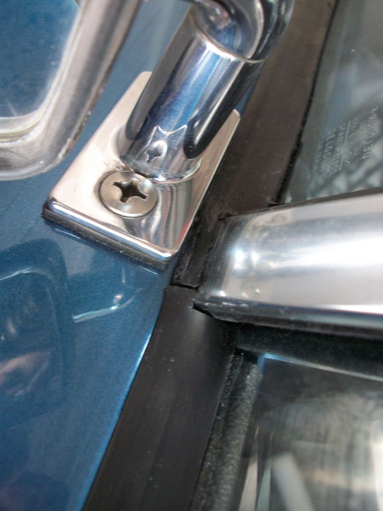

I then fitted the new sail & roll bar vinyl kit I’d bought from 914rubber using spray high temp impact adhesive from Woolies. The kit is mostly cut to size so it is critical to get it lined up before any glue is applied. I did this dry by taping the vinyl in the exact position, top, bottom and sides with 2” masking tape, drawing a pen line through the centre of the tape and cutting it free along the vinyl edge with a Stanley blade. This left 4 bits of tape on the car and 4 on the vinyl. When lined up with the pen marks they would be in the perfect position. I masked off all around the car with several broadsheet newspapers and applied the spray glue in 3 section. Roll bar top first.
After the glue was touch dry I fitted the top vinyl. No mean feat when your lone working. I had to very carefully stick one side on the very edge, hold it up high and walk it through the car (easy with seats out) and then standing on the opposite side of the car still holding it up high, align it front to rear, keeping it tight I then lowered it progressively in place for a perfect fit. The edges were then worked into the contours before trimming the sides off. Finally I then cut the ends with a knife and steel rule exactly halfway down the centreline of where the two aluminium trims fit.
After a well deserved cuppa I stuck both sail vinyls on. Again this was precarious starting at the top and working down, careful to make sure the vinyl finished half way over all the trim hold along the bottom.
Again after working it around all the corners and into place It all looked good.
Fortunately I’d carefully marked and trimmed the vinyl before fitting as I didn’t want too many cuts with a blade when it was on the car which break the paint surface.
The short aluminium strips were then fixed to the roof and the 3 new clips fitted along the rear edge (I took me a while to figure they went on the car first then the longest aluminium trim clips on afterwards)
Finally I fitted the two thin aluminium trims at the base of each fin with the 8 new spring clips I bought a while back.
The two curved ali trims will need to wait until tomorrow as I want to fit the two black grilles eitherside the engine bay before they go on, but need 24hrs for the satin black to dry.
Last of all I satin blacked over the etch and after half an hour unmasked the rear of the car with all glue/paint overspray contained on the newspaper, had a final cuppa and just sat a while looking at the car

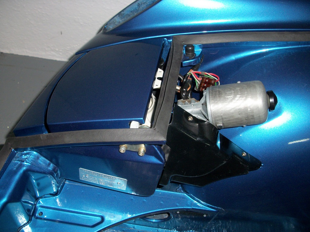

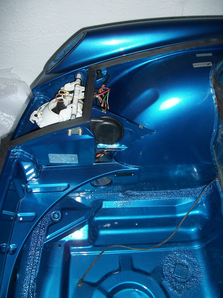

This morning early doors I started cleaning up the pop up light motor linkage plastic covers with Brasso and making sure the screws and bolts were all cleaned up before work.
At lunch I visited the powdercoaters and picked up the small black discs, all shiny and new. On the way back to the office I called in at Porsche Centre and picked up the two wiper spindle covers and new wiper arm retaining nuts.

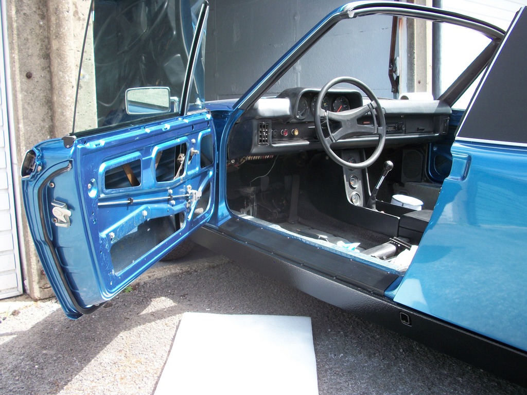

Tonight when I got home I thought I’d take a couple of shots of the roll bar vinyl and trims that I’d fitted the last couple of days.
(IMG:http://www.914world.com/bbs2/uploads_offsite/i265.photobucket.com-18255-1458845899.6.jpg)
(IMG:http://www.914world.com/bbs2/uploads_offsite/i265.photobucket.com-18255-1458845899.7.jpg)
With the motor mounting discs in hand I was ready to fit the pop up light motors.
I fitted them with the 3 allen socket head bolts just nipped up and connected all the wires, relay and earth cable. With the actuating arms DISCONNECTED I put the battery lead on and switched the lights on with the ignition on. The motors spun to the light up position. Next without turning anything off I disconnected the battery.
Doing this allows you to connect the actuating arms in the maximum extended position (short pivot end and long arm absolutely straight and in line). With the arms on and the nuts nipped up (while holding the arm so as the motor wouldn’t turn when the nut was nipped) the lights were in the up position.
Now; with many 924’s, 944’s and 928’s under my belt in previous restorations the alignment is straight forward as follows….
1. Loosen off the end stop bolt and wind forward.
2. Fit the top painted covers and the black plastic cowls.
3. Loosen the 3 allen head bolt slightly that hold the motor in place.
4. Wind the motor manual knob ANTI clockwise (its got a lefthand thread, if you go clockwise it’ll unscrew and fall off) until both lamps are fully down with the actuator arms folded one under the other over the top of the furthest allen bolt.
Its ONLY now that you can align the pop up unit.
5. The first thing to do is line up the front edge of the lamp pod (effectively how far the light closes) This is done by moving the motor forwards or backwards on its 3 bolts NOT by turning it. Once to front edge is level with the infill panel and wing the motor can be nipped up on the 2 bolts you can get to as one is behind the arm and can be tightened at the very end.
6. Next loosen the light pivot bolts, two under the wing and 3 in the bonnet.
7. With bonnet closed you can align and tighten the two bolts under the wing and make a note of were to move the bracket on the inner pivots in the bonnet. I use a bit of masking tape in line with the bracket so you can see how much you’ve moved it and in which direction.
8. The pivot bolts in 6 & 7 above set the height on the rear of the lamp pod and move forward and back to set the pod squarely in the car.
9. Once level, square and at the right height tighten all bolts.
10. Before any power is applied turn the manual lamp knobs anticlockwise to open and close the light to check all is good.
11. Finally turn the knob one last time to the fully open position (tighten up that last motor bolt you could’nt get to) and set the travel stop limit bolt. This is done by carefully slipping a 13mm open ended spanner down the rear of the light pod, hold the nut and with a screwdriver turn the bolt anticlockwise until it just touches the bracket on the pivot then lock off the 13mm nut carefully in that position.
Afterwards I put the battery back on and powered them up and down a few times to make sure all was good.
Light beam alignment will be set crudely shining at the rear of the garage with the bowl adjusting screws and done properly at the MOT (Ministry of Transport) test station with the light box.

Right Pop up light
(IMG:http://www.914world.com/bbs2/uploads_offsite/i265.photobucket.com-18255-1458845900.9.jpg)
The finished alignment, pretty much as good as it gets
(IMG:http://www.914world.com/bbs2/uploads_offsite/i265.photobucket.com-18255-1458845900.10.jpg)

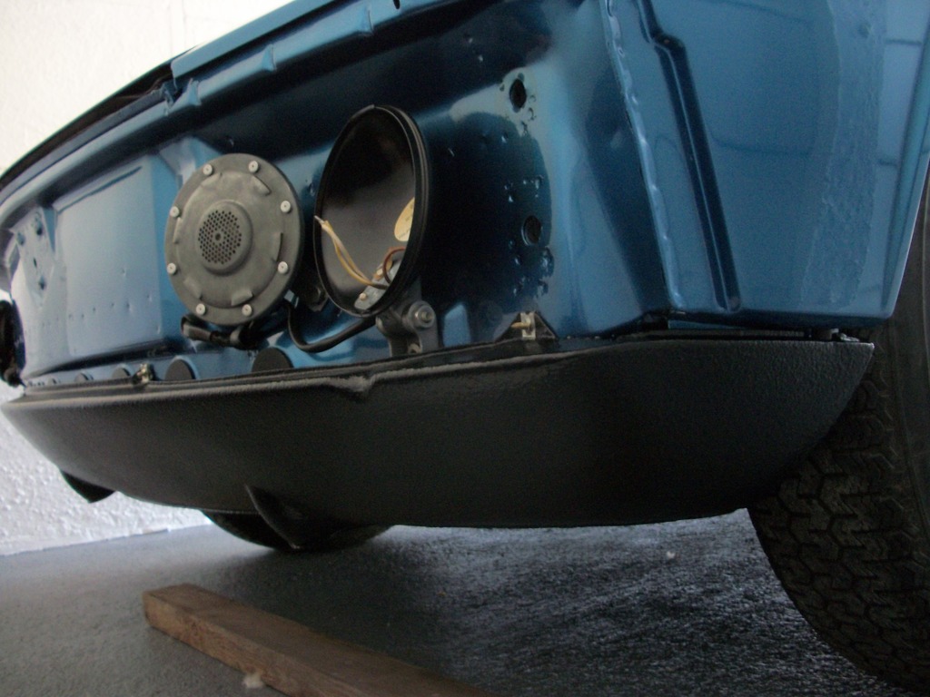

This morning I got up early and fitted the speed nuts to the front valance and sorted out some BZP Acme screws for both valances.
I used my Swedish punch set to make a set of rubber washers for the front screws, just a shade bigger than the captive washers. With all new fixings I fitted the rear valance first.
(IMG:http://www.914world.com/bbs2/uploads_offsite/i265.photobucket.com-18255-1458845900.11.jpg)
I’d opted for a stone guard finish on them both (to kinda match the Targa top and Porsche 944 sill (rocker) style) and had them painted on both sides after they were sand blasted and etch primed. Hopefully they’ll last well.
Next I fitted the front fog lamps and horns. New grommets in the lamp bases, but still waiting for the new Fog lamp glass lenses to arrive so left the bezels & reflectors out for now. With the cables neatly connected and clamped in place I put the battery on and tested the horns. All good.
The car was now ready for the front valance. After all the tin bashing and patience with a coat of primer and stone guard (inside and out) it came up pretty damn good.
(IMG:http://www.914world.com/bbs2/uploads_offsite/i265.photobucket.com-18255-1458845900.12.jpg)
(IMG:http://www.914world.com/bbs2/uploads_offsite/i265.photobucket.com-18255-1458845900.13.jpg)
All screwed in with rubber washered Acme BZP screws and new speed nuts; all that was left to do was give them a lick of Waxoil with a modellers brush to keep them looking good.
The ends of the valances at the wheel arches were bolted together with stainless M5 bolts, nylocks, 12mm OD penny washers and some new rubber spacer sleeves.
With the waxoil tin still open I poured a bit into a jam jar and with a ¾” brush I set about painting the inside of both doors. This took a couple of hours as I made sure I’d worked it into every corner and crevice. The doors are so good a condition with zero rust that I want to keep them that way. Looking through the top of the door I waxoiled the rear of the inner panel (the one the door card attaches too) and then up and under the top of the door skin behind where the weather strip and mirror fits across the top of the door. I think I pretty much got every internal surface.

The rear one was the same as the front but as there is no centre fixing in the bumper I was very worried that I’d tear/snap it when trying to get the 2 studs to locate at either end.
I also noticed the holes for the numberplate lights hadn’t been made so went to pilot drill them, but just thought I’d check the light fitment first. Good job I did as the indents/dimples guides in the new rubber were nowhere near right. The indent fixing guide was far too wide for my lights.
(IMG:http://www.914world.com/bbs2/uploads_offsite/i265.photobucket.com-18255-1458845901.15.jpg)
The cut out for the light holder was so wide I only just managed to get holes into the rubber.
Yet again I am very disappointed in these remanufactured parts from 914rubber. Lets hope they stretch over night as my old ones are far too gone to put back on the car.

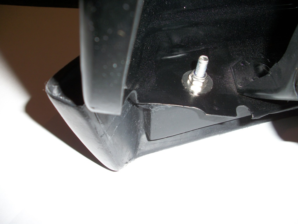

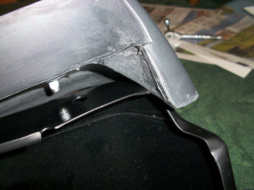

After updating my dairy last night I took another look and decided that the only way I could get them into shape at the ends would be with a mechanical fixing.
I took the plunge and drilled a small 4mm hole in each bumper end and painted the cut metal to stop it rusting before leaving it overnight to dry.
The problem is that with stretching the trims so much to fit the studs into the metal bumpers, the ends curl out of alignment with the wheel arch ends.

(IMG:http://www.914world.com/bbs2/uploads_offsite/i265.photobucket.com-18255-1458845902.19.jpg)

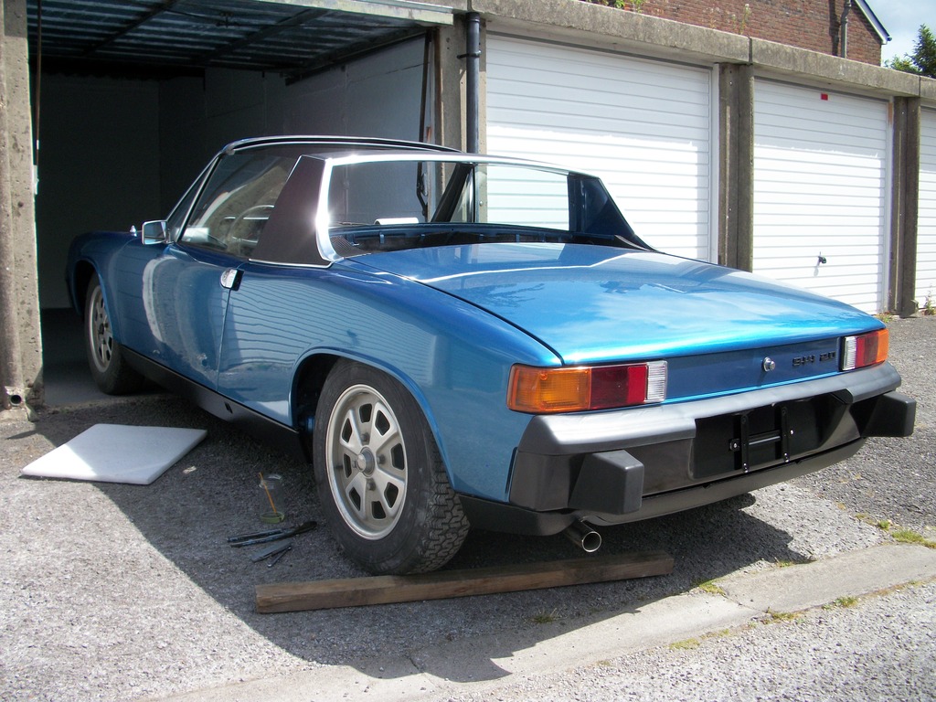

Finally I could fit the bumpers to the car.
(IMG:http://www.914world.com/bbs2/uploads_offsite/i265.photobucket.com-18255-1458845902.20.jpg)
The numberplate lights were fitted and tested all good, so I moved on to the front.
(IMG:http://www.914world.com/bbs2/uploads_offsite/i265.photobucket.com-18255-1458845902.21.jpg)
Not the easiest thing to fit but after another day of agro the result is better than my old perished trims.

To continue with the door & glass alignment from this morning I needed the rear upright window seal fitting to the roll bar. With a little PH neutral soap and water they slid in nicely from the top and once certain they were in correctly I trimmed a tiny bit off the bottom to the correct length. Another 914rubber part but this time all went well.
I was just about to adjust the rear window runner inside the doors when Nathan from here called by. Suffice to say I spent the next 2 hours walking him through my car collection and talking all things Porsche! Before I knew it, it was 10:30pm and time to call it a day.
Day 171
Today I continued with the door, window glass, runners and frame alignment. No mean feat chasing your self in circles but I got there in the end.
Starting with holding a plastic 12” rule down the front edge of the door to front wing I adjusted the hinges and lock striker plates to get the fit right. Next the front ali window posts and quarterlights were pulled in at the top using the adjuster at their base so that the quarterlight glass met the up and over windscreen pillar seal evenly.
Next with soapy water on the glass to lubricate the scraper seal I wound the window up and down to get the best position for the M8 bolt in the nylon block on the bottom of the glass that holds it into the winder arm.
Then I adjusted the rear vertical channels again to get the glass (when wound up) to close evenly against the rear roll bar seal. I then looked at the glass side on where it meets the roll bar seal and noticed it was a tiny bit out of parallel, so undid the M6 bolt on the top of the front ali window post and gave it a tiny nudge rearwards before nipping up. After which I went back around all pivot points to double check everything. Last of all I then adjusted the travel stops on the winder mechanism to set the maximum glass height without over shooting the ali post rubber tops, then completed by tapping over the ali channels to clamp the up & over and roll bar window seals in place.
A few hours went by but the jobs done now.

This morning I got up early and masked off and painted the rear section of the floor that I’d spent several days cleaning up. I had a litre of basecoat paint left over so I thought I’d put it to good use while the floor was exposed. As per the rest of the car there was zero rust in the floorpan, just a lot of dirt & sand.
Having cleaned it up meticulously it was apparent that the factory barely put enough paint on the floor in the car to cover the white primer. It was very light and opaque in places. Giving it a good second coat would certainly help protect it for the future.

Having waited so long for the Fog light glass the first thing I did tonight when I got home was assemble them with my home made seals in my shed. The weatherstrips will wait for the morning.
With the lamps bases on the car it’s not easy to get the power cable, bezel clip and screw in through the opening in the bumper. Again with a little patience, lying upside down and a torch held in my teeth I got them both on.
The next thing was to offer up (without screws) the nice shiny new chrome grilles and adjust the lamp allen bolt so that the lamp sits central in the grill hole, then nip up the bolt.
I put the battery on and turned the fogs on to check all was well before aligning the height of the beam and clamping off the hex head through bolt. Again this is tricky through the bumper opening with the horns in the way. A ¼” drive 13mm socket straight onto a UJ was the only way I could get at it.
Just as it was getting dark I fitted the nice chrome grilles with new stainless screws to finally finish off the front bumper.

Day 176
This morning I got up early and removed the handbrake lever and took it into my shed. Since painting the floor the other morning, it’s made things surrounding it look bad.
I rubbed down and primed the handbrake before breakfast being extra careful to mask up the nice 914 part number printed on the side in white lettering.
At lunchtime I picked up some stainless raised countersunk Phillips M6 for the door mirror and when I got home this evening I spent half an hour polishing up the heads so they shone like chrome.
The replacement seals that turned up yesterday got fitted next.
The reason the seals grab and jam is they seem too wide/tall. It’s obvious when you hold Marks replacements and the first one I bought side by side.
The seal on the left is the 914 replacement seal, the right is a 911 type seal.
(IMG:http://www.914world.com/bbs2/uploads_offsite/i265.photobucket.com-18255-1458845903.28.jpg)
As you can see the left hand one is shallower & shorter and has an extra part that reaches down by the “bulb” locating strip to stop it “rolling” into the glass.
I fitted the correct left hand seal tonight and the windows wind up and down with ease, just as Porsche intended.
The answer isn’t talcum powder, its fitting the correct seal.

While working on the doors and windows I’d noticed that the passenger door had up inside it, the plate with two threaded holes to take a passenger door mirror, but the door skin had no holes.

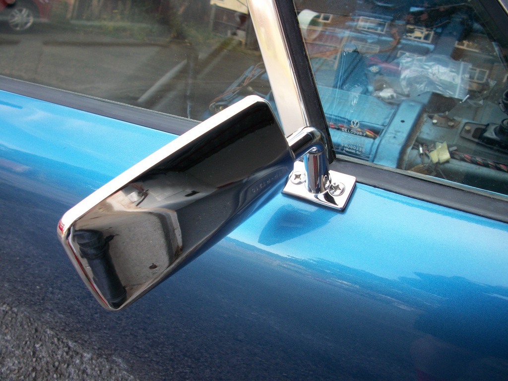

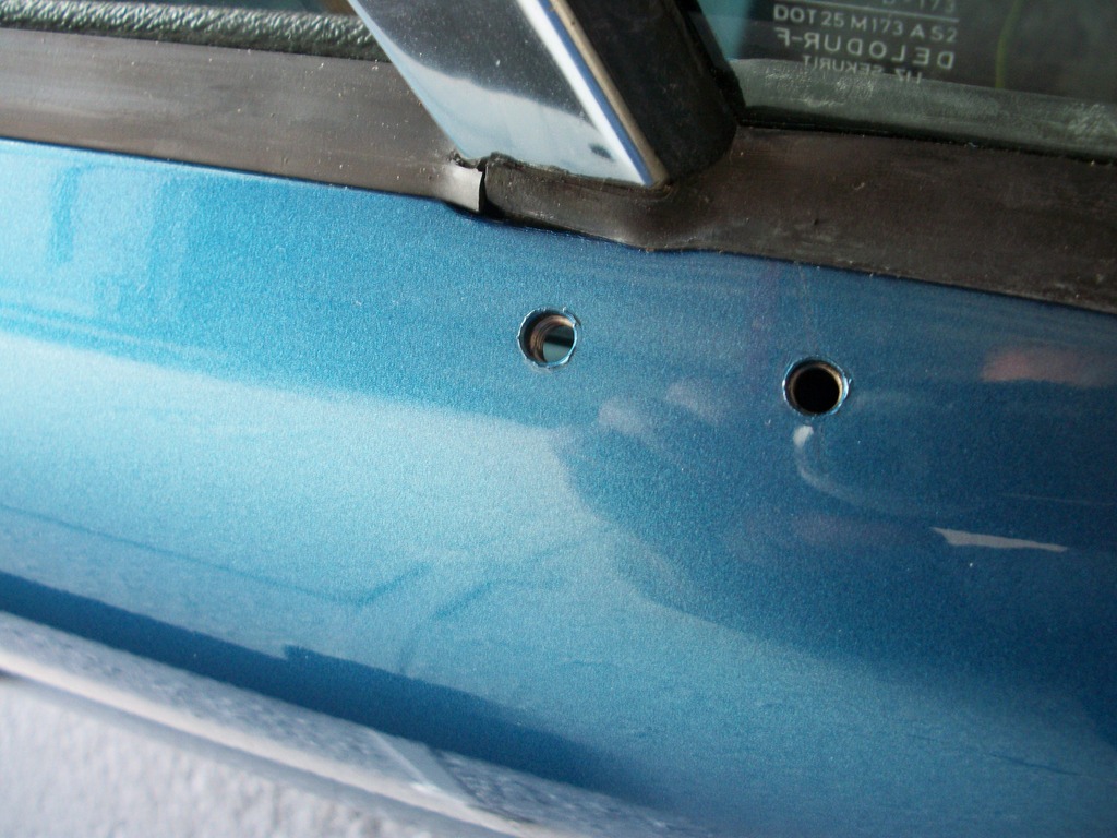

Porsche must have done this to allow passenger mirrors to be retro fitted or fitted by special order at build.
Now; with a LHD car in UK a passenger door mirror is quite helpful. So after a search on line I found some NOS for sale in Germany for £80 including the gasket.
All that was required was to locate the exact position of the threaded holes and drill the door from the outside….not as easy as you’d think.
After a few days pondering I decided to reach from inside the door, put my centre punch in the threaded hole from underneath and tap gently to make a raised pimple on the door skin that I could see from the outside.
Very carefully I centre punched the pimple and then drilled a 2mm hole. Looking from the inside of the door with a mirror on a stick I could see that I was almost central but not quite.
A 3mm drill was used next followed by a 3.5mm. In this way I removed the risk of cutting into the thread in the door and damaging it. The hole was then enlarged with my swiss rat tail file until it matched perfectly the threaded M6 core diameter. I then carefully ran a 5mm drill down it to ensure it was circular before using my sheet metalworkers step drill to take the door skin nicely out to 6mm without damaging the threads.
I repeated this on the other hole and had two perfect 6mm holes in line exactly with the factory threads.
Finally I cleaned up the burrs with a tiny countersink and painted around the holes with two pack paint.
Roughly an hour a hole but it was worth spending the time to get it right. Doing it wrong is only going to hurt the pocket!
(IMG:http://www.914world.com/bbs2/uploads_offsite/i265.photobucket.com-18255-1458845904.30.jpg)
Day 178
Today was another very busy at work, but I did manage to squeeze in a little time on the 914 at the start and end of a long day.
As the paint around the holes had dried I fitted the new Passenger Mirror with a good coating of waxoil down and around the mounting holes before it went on.
(IMG:http://www.914world.com/bbs2/uploads_offsite/i265.photobucket.com-18255-1458845904.31.jpg)

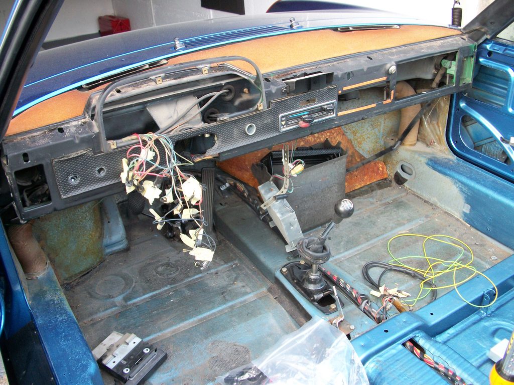

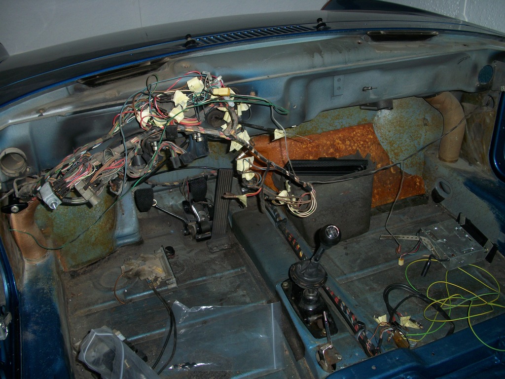

After a busy day at work, I got back into the garage at 6pm tonight and began “Operation Dash Stripdown”
The top roll has a few sundried cracks in it, the bottom roll has a single crack under the glovebox, the top padded vinyl has shrunk and come unstuck, as has the basket weave insert. All in all the closer I looked the more issues I found with it.
So the only way to sort it out is to redo it all. Taking the dash top roll off I was greeted with another load of fine Desert sand beneath it.
I also plan on cleaning up and repainting the front half of the floor so I stripped out the centre console and all the remaining bits of carpet ready for a good scrub up and bubble bath.

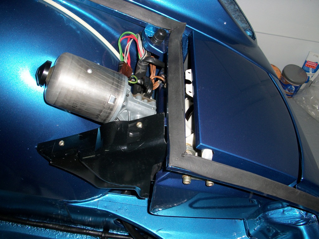

Who on earth thought it was a good idea at Porsche to have the steering column pass through the carpet?????
To get the passenger foot rest carpet out I had to remove the steering column!
Not a bad thing really as I found all the windscreen washer hoses perished and split behind there plus a few wires that had come unclipped from things.
(IMG:http://www.914world.com/bbs2/uploads_offsite/i265.photobucket.com-18255-1458845904.32.jpg)
Again I worked until it started to get dark and hard to see, but I made good progress.

Over the last few weeks I’ve been viewing cars for my 17 year old son and today we found a little gem. He wanted a Morris Minor Traveller (not my choice, but I’m happy he wanted a classic car over a modern soul-less tin box) We got up at dawn and drove up to High Wycombe (north of London) to view a one family ownership car with ONLY 54000 miles from new.
It was absolutely fantastic condition, and the history was amazing (little hand written notebook, browning edged pages in lovely handwriting listing every oil and parts change on the car). We just had to buy it. Both my son & I had great beaming smiles as we drove it home 100 miles without missing a beat this morning.
(IMG:http://www.914world.com/bbs2/uploads_offsite/i265.photobucket.com-18255-1458845905.33.jpg)
(Wood sheet only placed under the car as a test for a couple of days to see if it drops any fluids)

Determined to work on the 914 everyday I then continued with operation dash stripdown. The top vinyl directly by the windscreen had shrunk and the glue failed. Its folded around the dash frame and glued on so unfortunately the only way to really recover it properly is to take the dash frame out.
After a couple of hours which involved figuring out where all the fixings were and how on earth I was going to reach them I managed to get it out.
(IMG:http://www.914world.com/bbs2/uploads_offsite/i265.photobucket.com-18255-1458845905.34.jpg)

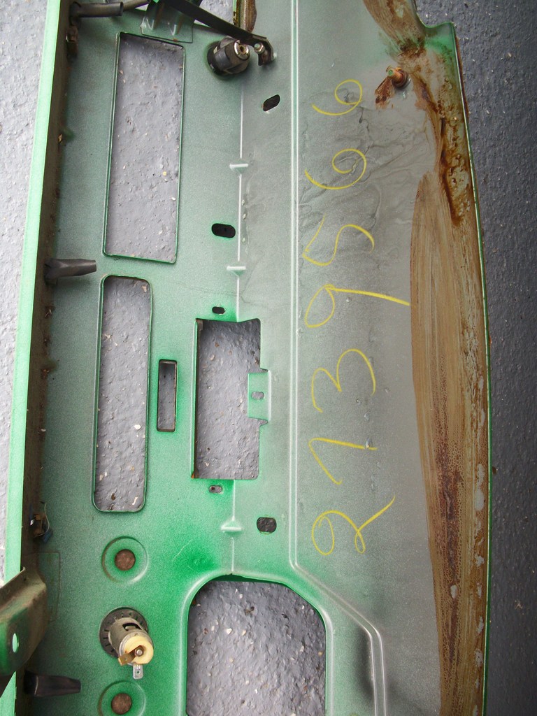

When I first got my car I’d mentioned to the UK club registrar the dash was green when looking up and underneath it. He’d said that the dashes were painted with each car, but when they came back from trimming the factory simply put them in the first car they came too.
On the reverse of my green dash is MY Karmann body number!

I got up before sunrise and pushed the car out of the garage much to the surprise of a Fox that shot across the rear of the car as it rolled out. Scared the living daylights out of me!

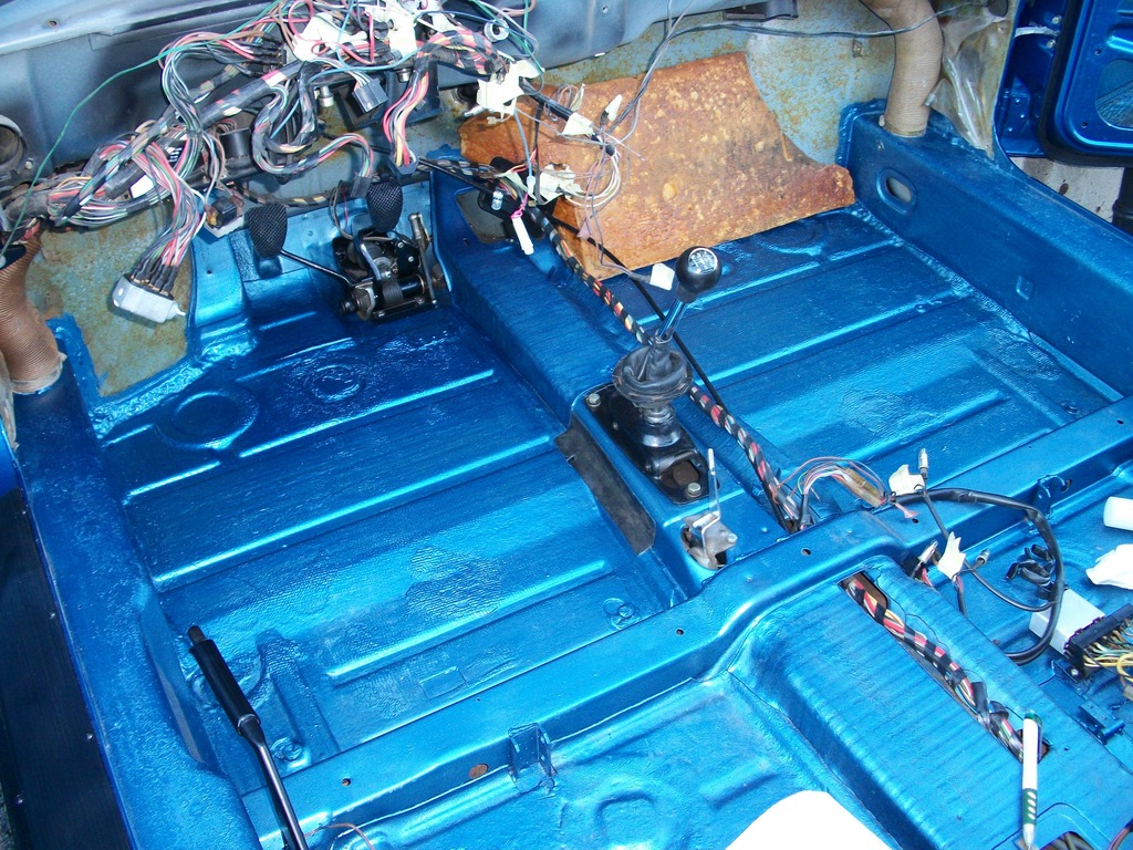

I managed to get a good two hours cleaning the floor before breakfast this morning. Again with no power I had to do it all by hand with wire brushes, scrapers and a brush and dustpan. But I got it pretty clean. I started by the windscreen and worked down, brushing all the dust, fluff and grime out the wiring and on to the floor before cleaning that.
At lunchtime I called in at the powdercoaters and picked up the seat runners and rear tunnel cover plate. They look like new!
Spurred on by them when I got home this evening I had another final clean up and decided to put the first coat of paint on the front half of the floor.
