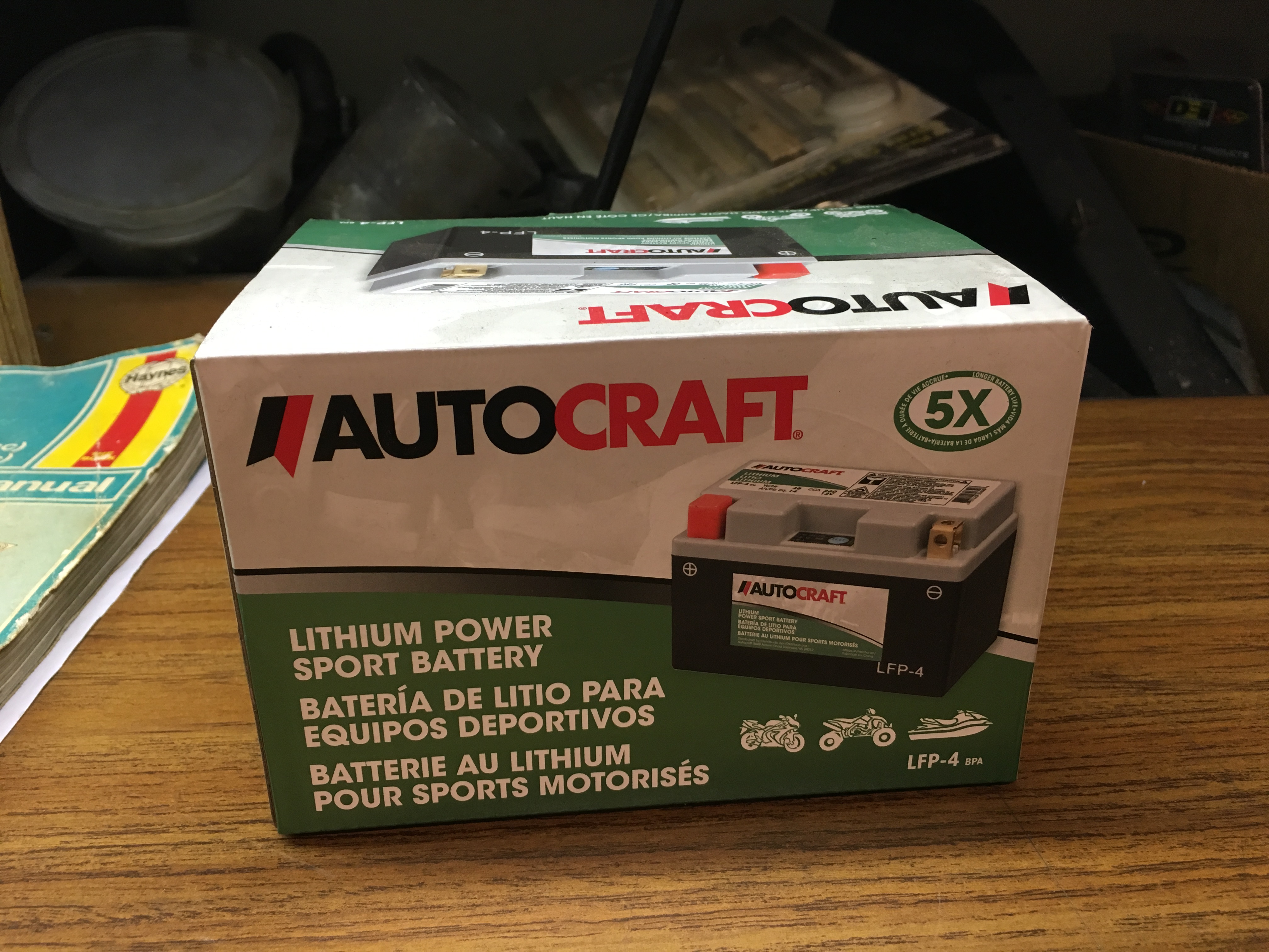

Autocraft Lithium-Ion motorcycle battery LFP-4. Weighs 2 pounds and starts the car just fine. I don't know how it would do with radios and extra lights.

Ive had that battery for about 6 months now and no issues starting. Although it will not keep the starting running forever. It won't handle any more than about 30-45 seconds of cranking at once. Hasn't been an issue for me yet...
